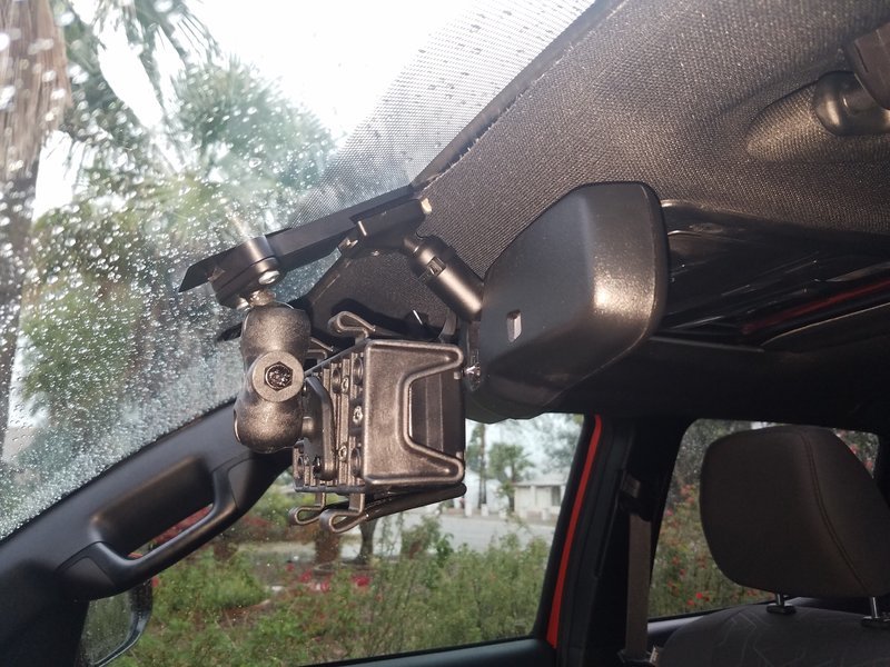

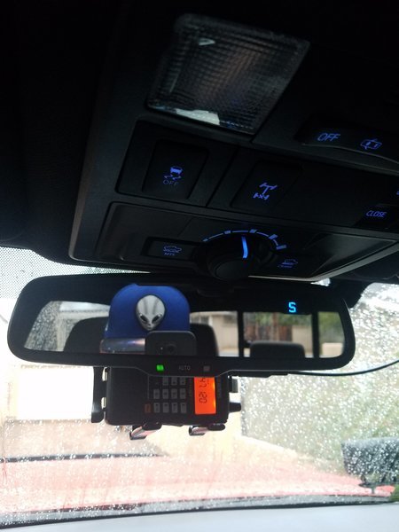

    I added the Bird Dawg mirror riser with ram finger grip cradle to hold my phone or what ever. My portable scanner is in there right now.

    Which scanner is that and do you find it picks up the local emergency/police bands?

    It's a uniden BC75xlt. It does very well and will tune into the following frequencies. ( I just copied paste, some of the band labels are a little off).
    • 25- 28 Citizens Band
    • 28- 30 Amateur Band 10 Meters
    • 30- 50 VHF Low Band
    • 50- 54 Ham Band 6 Meters
    • 108-137 Aircraft Band
    • 137-144 Federal Government
    • 144-148 Amateur Band 2 Meters
    • 148-174 VHF High Band
    • 400-420 Federal Government
    • 420-450 Amateur Band 70 Cm
    • 450-470 UHF Band
    • 470-512 UHF "T" Band
    I can listen to most of the local emergency stuff here but allot of cities are going to trunked and encrypted systems which will require an upgraded scanner.

    So the riser works on third gens?

    Yes it went on easily with no modding required.

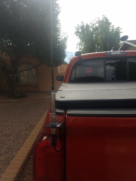

    Yeah I thought I understood what 8.5 feet looked like until it showed up from Amazon and I mounted it on the back of the truck. Holy F*&$ thats big!!! The 4' firefly antenna is very nice!! No spring needed and great performance! The guy I had tune it custom orders them from firestik with extra wire wraps and no tunable tip. I watched him peel the casing back and clip off little bits of wire until SWR was at 1.05. It was very affordable too.

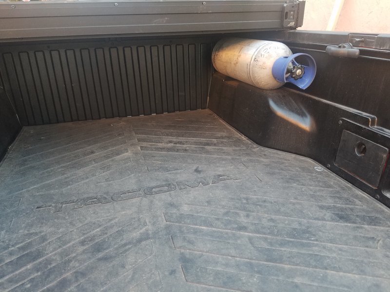

    So here we go, after scrounging the kegerator and making a phone call I was able to come up with two co2 tanks to choose from. I have both 5lb and 20lb tanks to work with both for the low low price of $Free.99!!!:thumbsup:
    I cant pass up free so will definatly be using one of these 2. The larger tank is my first choice since it'll need less fills and give more versatility with tool use. It is however in need of hydrostatic testing wich I'll try to get done this week. I'd imagine it's fine but I will re-evaluate the keg tank if it fails. :fingerscrossed:
    I'm thinking I can get it mounted here with a 20lb fire extinguisher strap bracket.

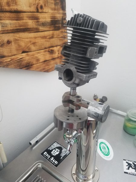

    Just a picture of my home-made chain saw motor tap handle. I can be a dirty hippie creative type too:rolleyes:

    Atta boy! Excited to see what you come up with. I mounted mine to the same location and it works out extremely well. I did add some rubber isolators between the bottle mount and bed side as well as some large 2 inch fender washers behind the bedside to help distribute the load. Anyhow, if you wanna take a look at it, just let me know. We'll be working on a few trucks at my house on Saturday so you're more than welcome to swing by if you're in the area

    Bingo, hit the nail on the head. I sandwiched them between the back of the mounting bracket and the bed as an added precaution to reduce vibration and protect the fiberglass bed. I bought them at Ace Hardware on McDonald in their nut and bolt Isle. That place is my go to for any spur of the moment mounting hardware or accessories I may need.
    With the weight of the tank, I wanted to mount it as rock solid as possible, so everything is grade 8 hardware. In order... 6 bolts, 6 flat washers,6 rubber isolators, 6 2 inch fender washers, 6 lock washers and 6 nyloc nuts... perhaps a little overkill?? Ha ha
