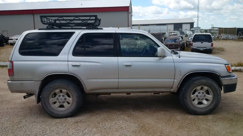

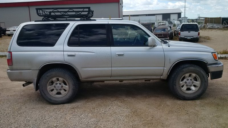

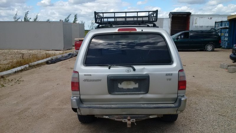

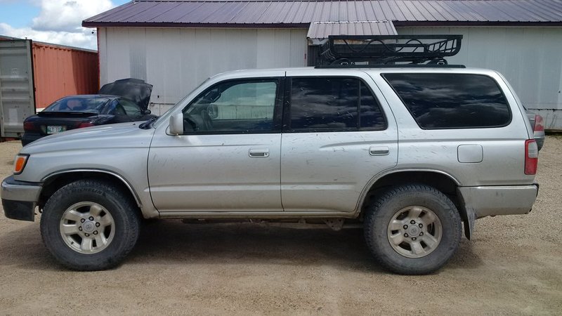

    Only Mod is the box liner on the rockers and up the doors all other work has just been repairs, looking forward to future build.

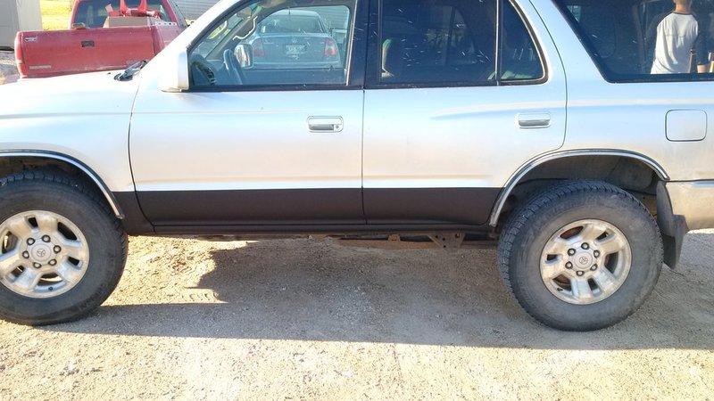

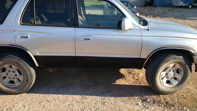

    This is my build thread I don't have pictures of the day I bought it But I will give the low down on what little has been done so far and what's planned. first thing I did was take off the stock dent to hell steps and did the axel seal that was leaking. replaced the headlight with another stock one till I find something nicer (maybe build a projector). and I took off the bug deflector because it was broken. Also sanded and painted the rockers and partway up the doors with box liner cause I drive a lot of gravel and get rock chips fairly often.
