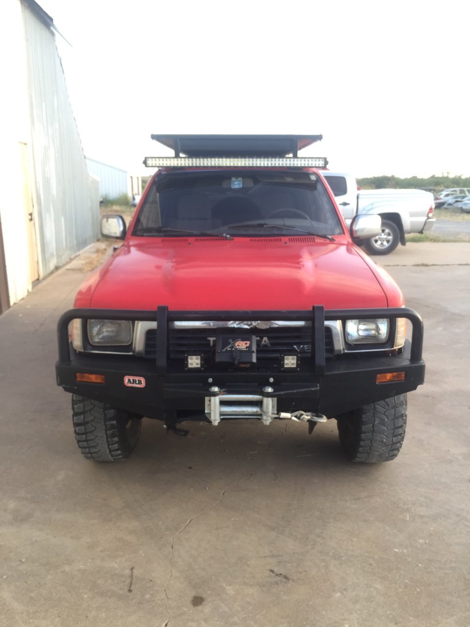

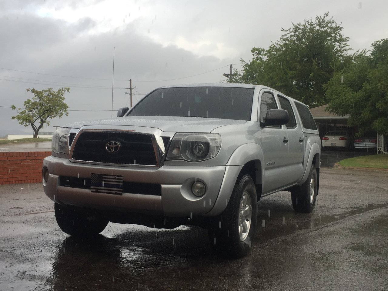

    I don’t really have a picture of when I first got it but I have a picture of my old rig with my truck in the background
    As it currently sits

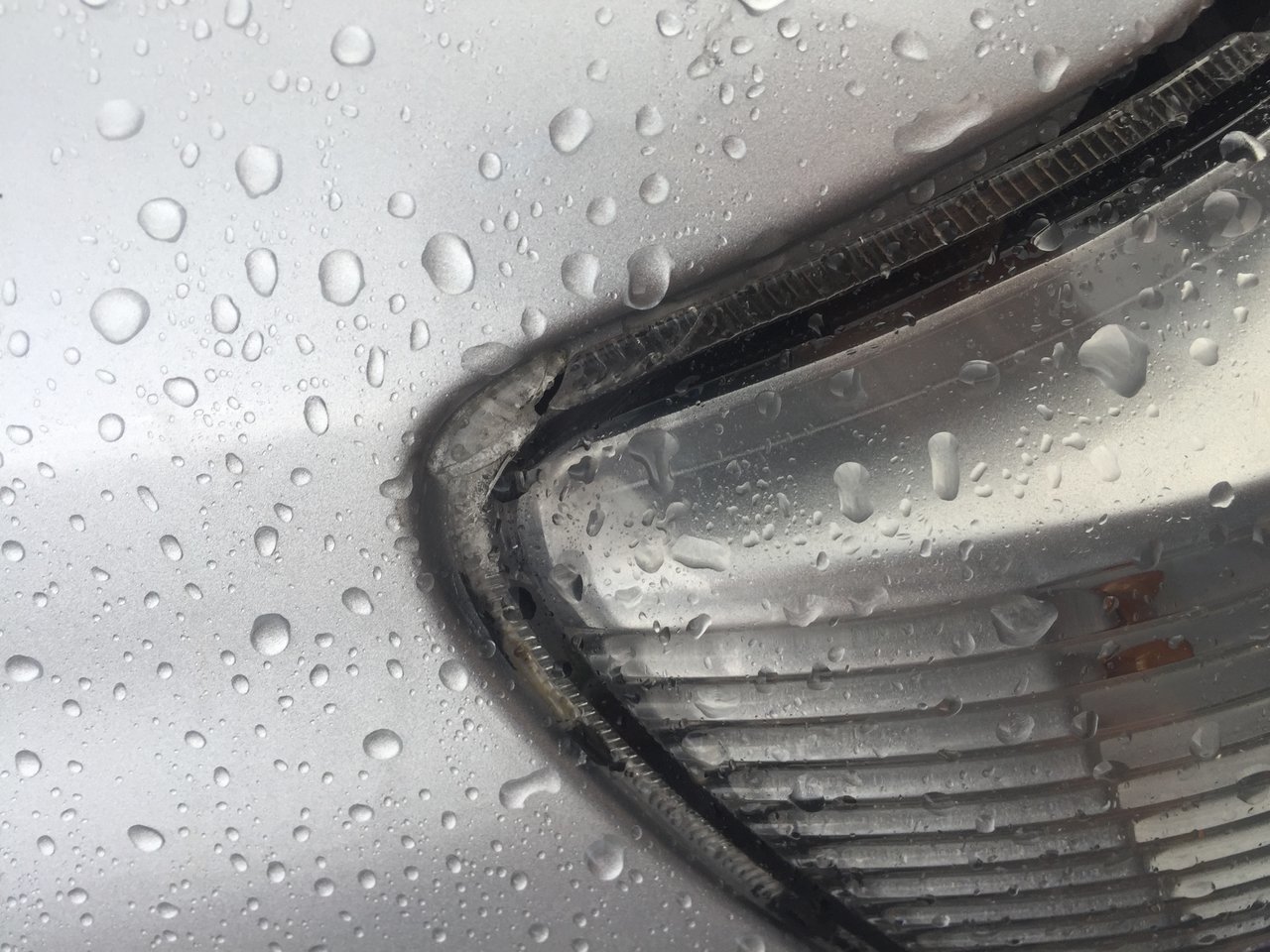

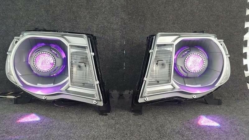

    I found some color matched headlights on the BST thread after receiving them finally they were damaged, but we decided the shipping company damaged them and I didn’t want to fight with them to get it fixed. They didn’t leak so I wasn’t really worried about it. After installing them whoever built them mixed up the wiring for the demon eyes and it would need two controllers to work properly or to be opened up and fixed. So one day I will open them up and fix them and the cracked lense. Till then halos only. The have 6k bulbs in them.

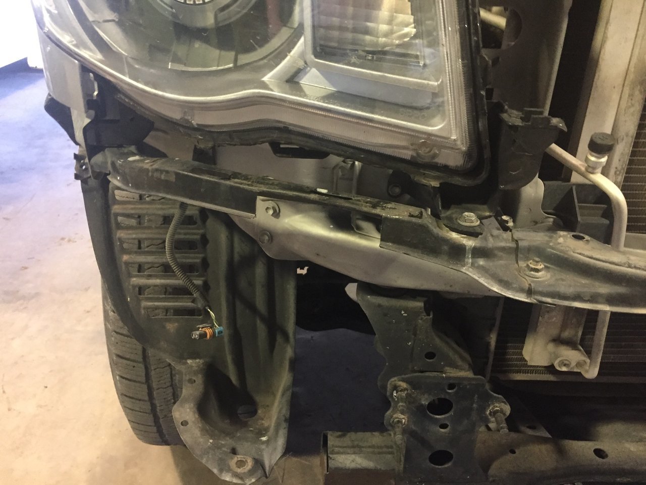

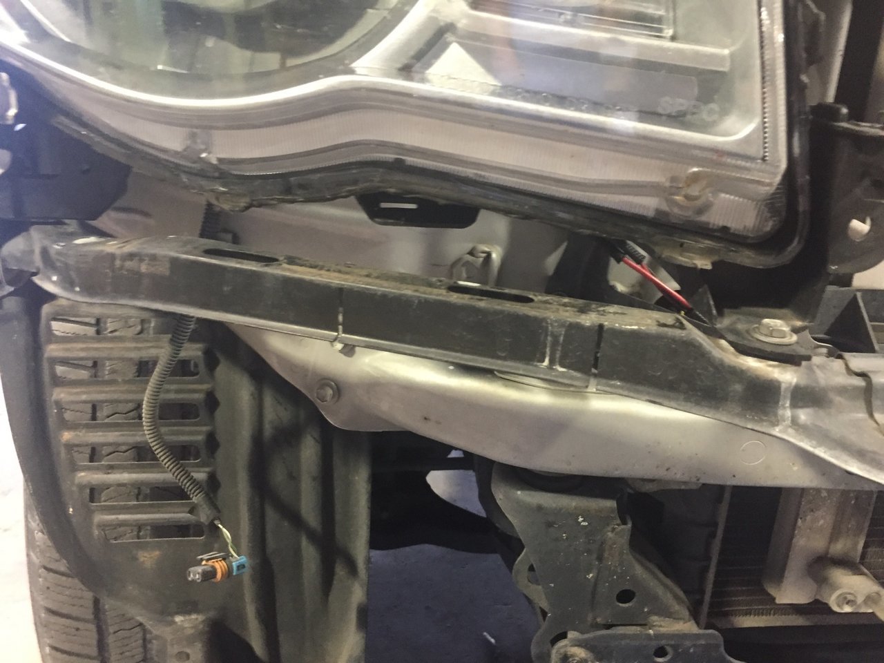

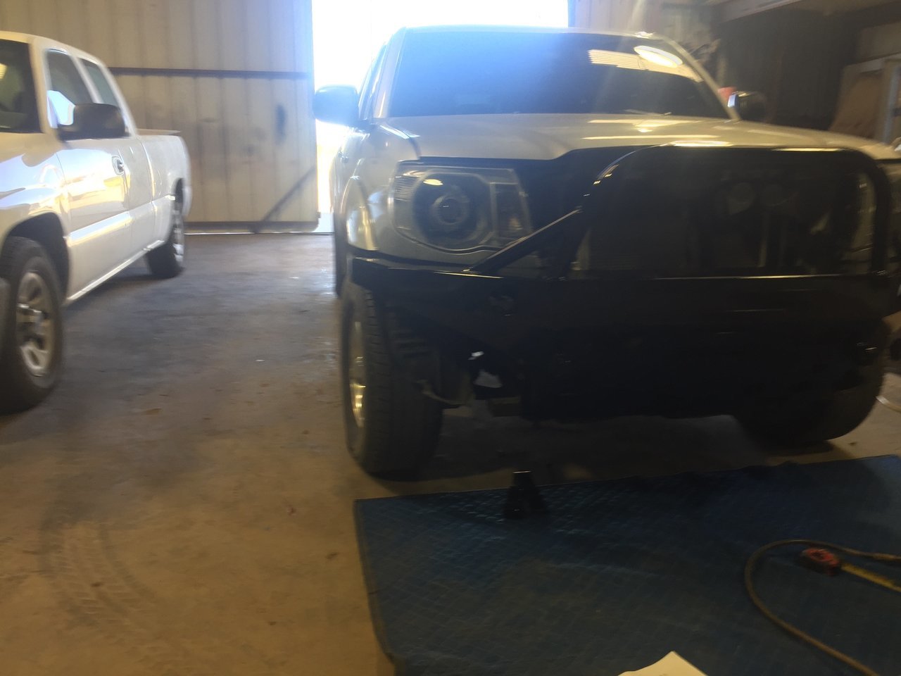

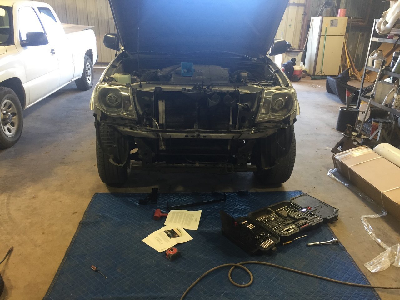

    I came across a brand new Pelfreybilt Steel middle loop bumper on the ole BST thread. It was in Florida and I thought that would kill the deal, but thanks to Uship it didn’t. 50 dollars and three weeks later it was at my shop waiting to be powdercoated. The install when smoothly other than some holes not lining up. The mill helped with that. It was a while before I got lights in it and it still doesn’t have a winch in it to this day.
    840688A3-E5EA-4BF6-BF31-9AF358E9F0F2.jpg 4C7AED09-E83B-4EA8-897E-86F6E84DDC5E.jpg
    Cutting the notches for the lights.
    0AF7632D-034A-449B-B8B4-19D66BC5E670.jpg D21766B9-7F82-45C5-BBE4-B4C728C4DD90.jpg B14E28CF-65DC-4EE9-A0C5-66075B28A8F3.jpg
    Getting the reenforment brackets to line up.
    EC6A2D61-4290-49D8-A5DD-78A7AF89BFE6.jpg C7EDE4AC-55DA-475F-9A74-A3E790ADC67F.jpg ADEEF820-D4BC-41F5-AE95-3785EDF02F77.jpg 9E98D3C4-C7EE-4DD1-AC72-4C7E9BDD9202.jpg

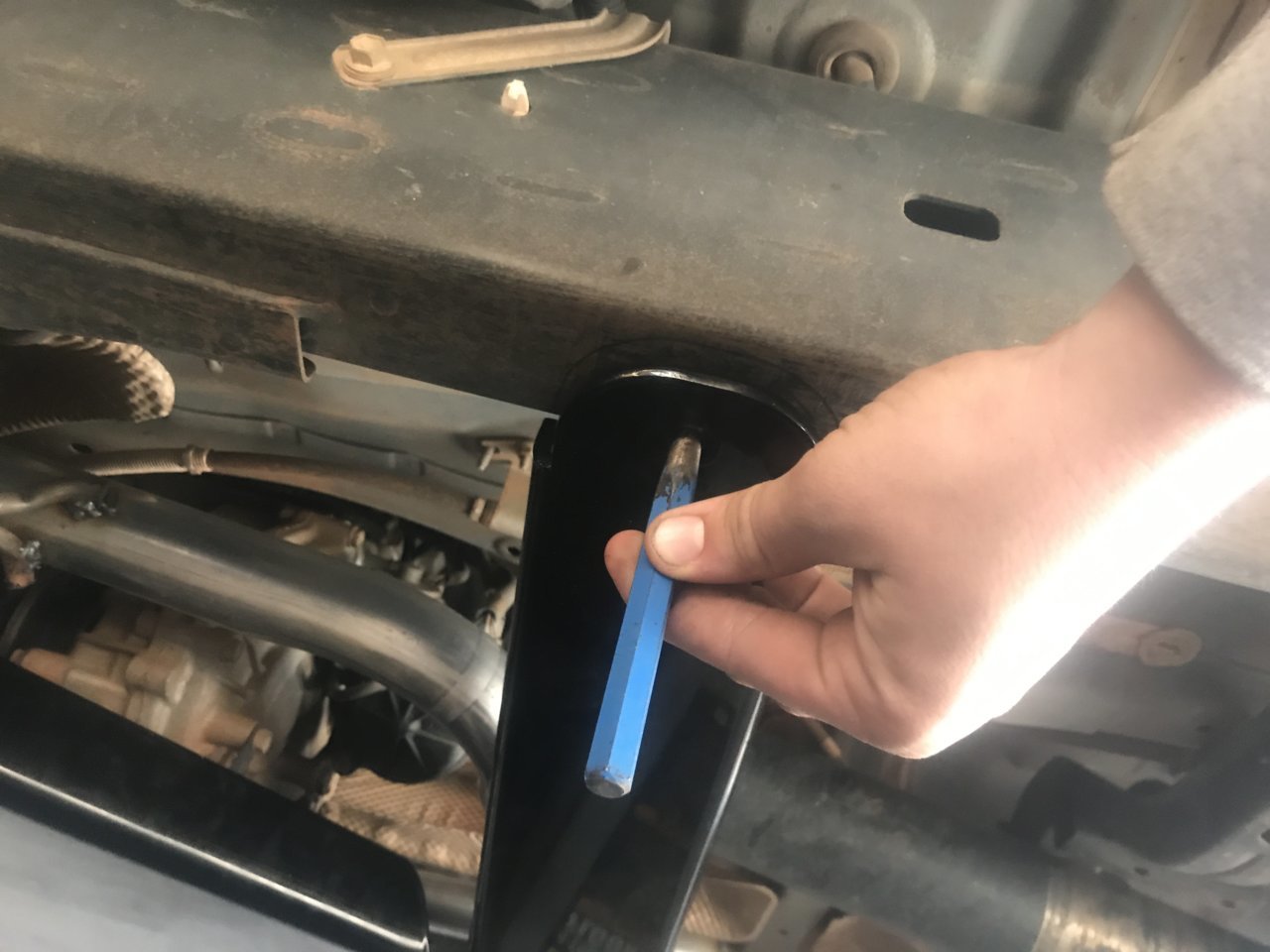

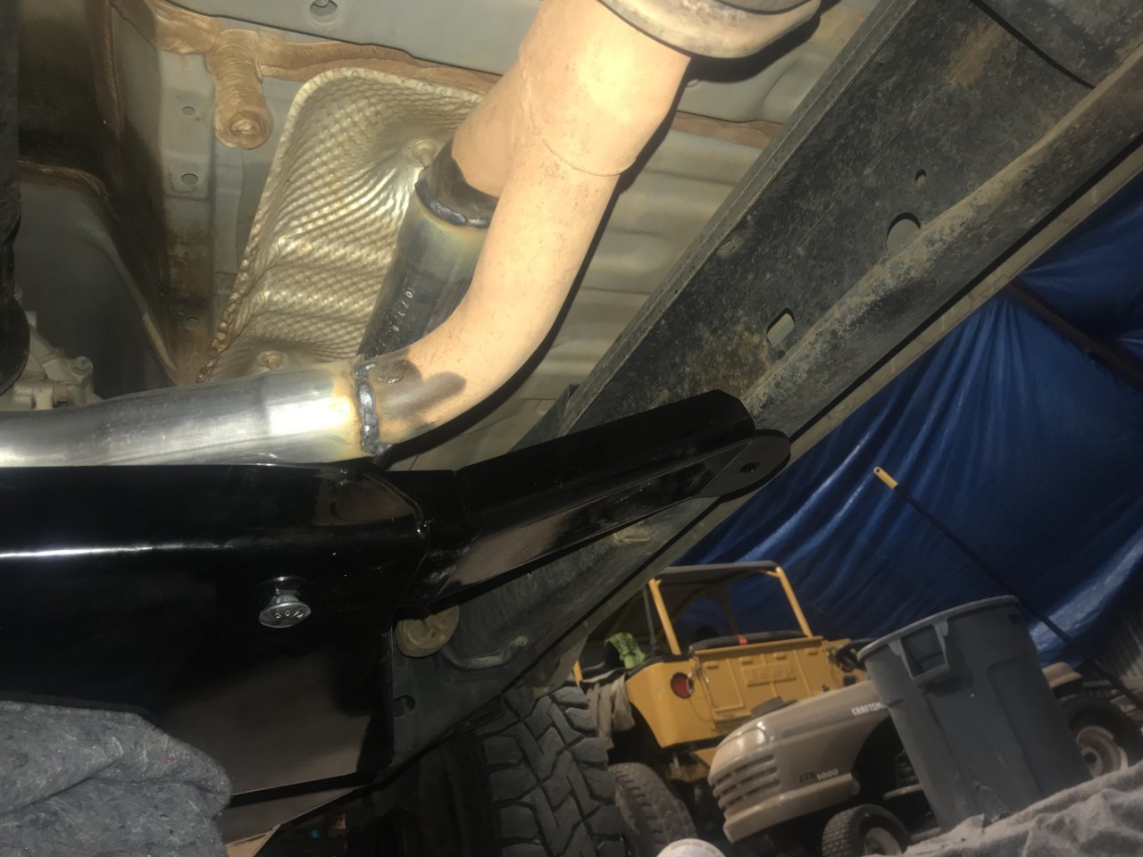

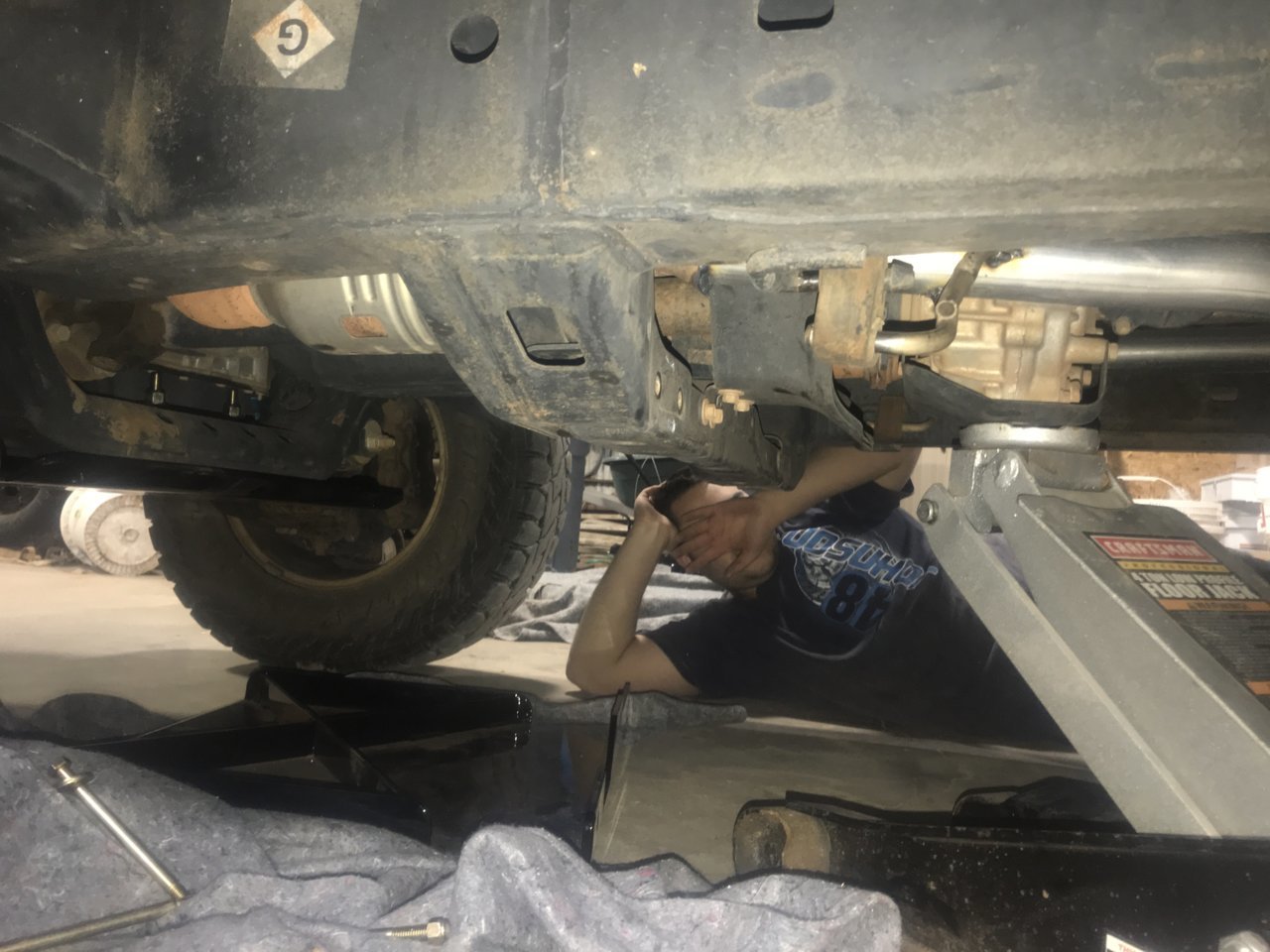

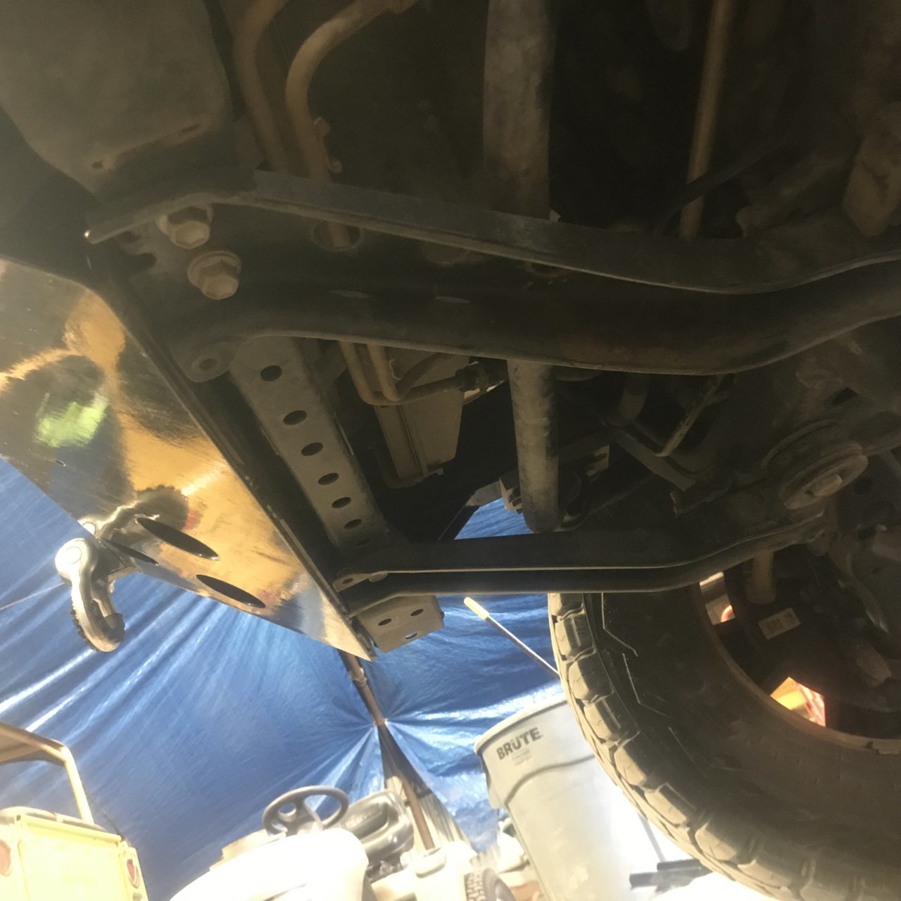

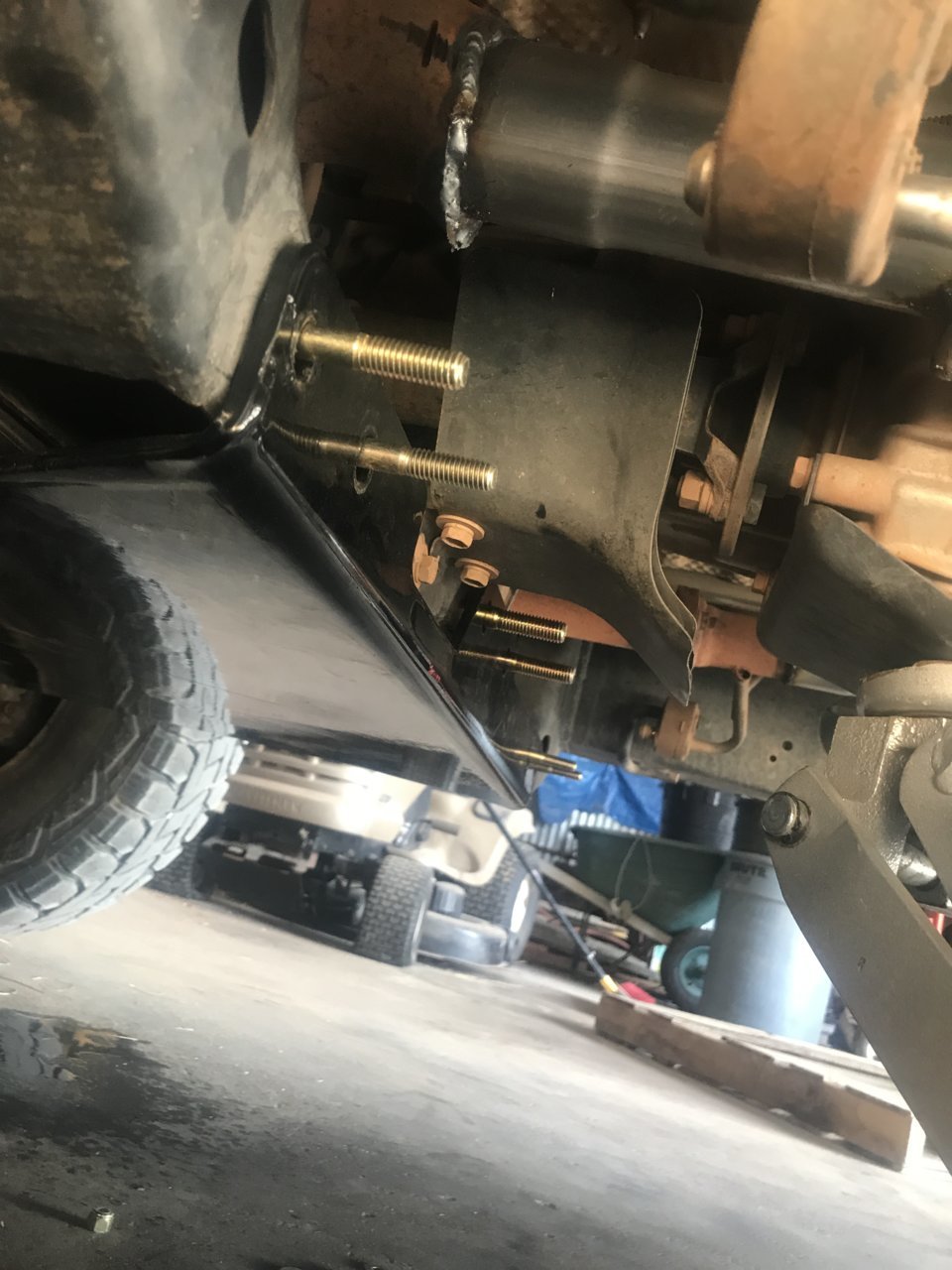

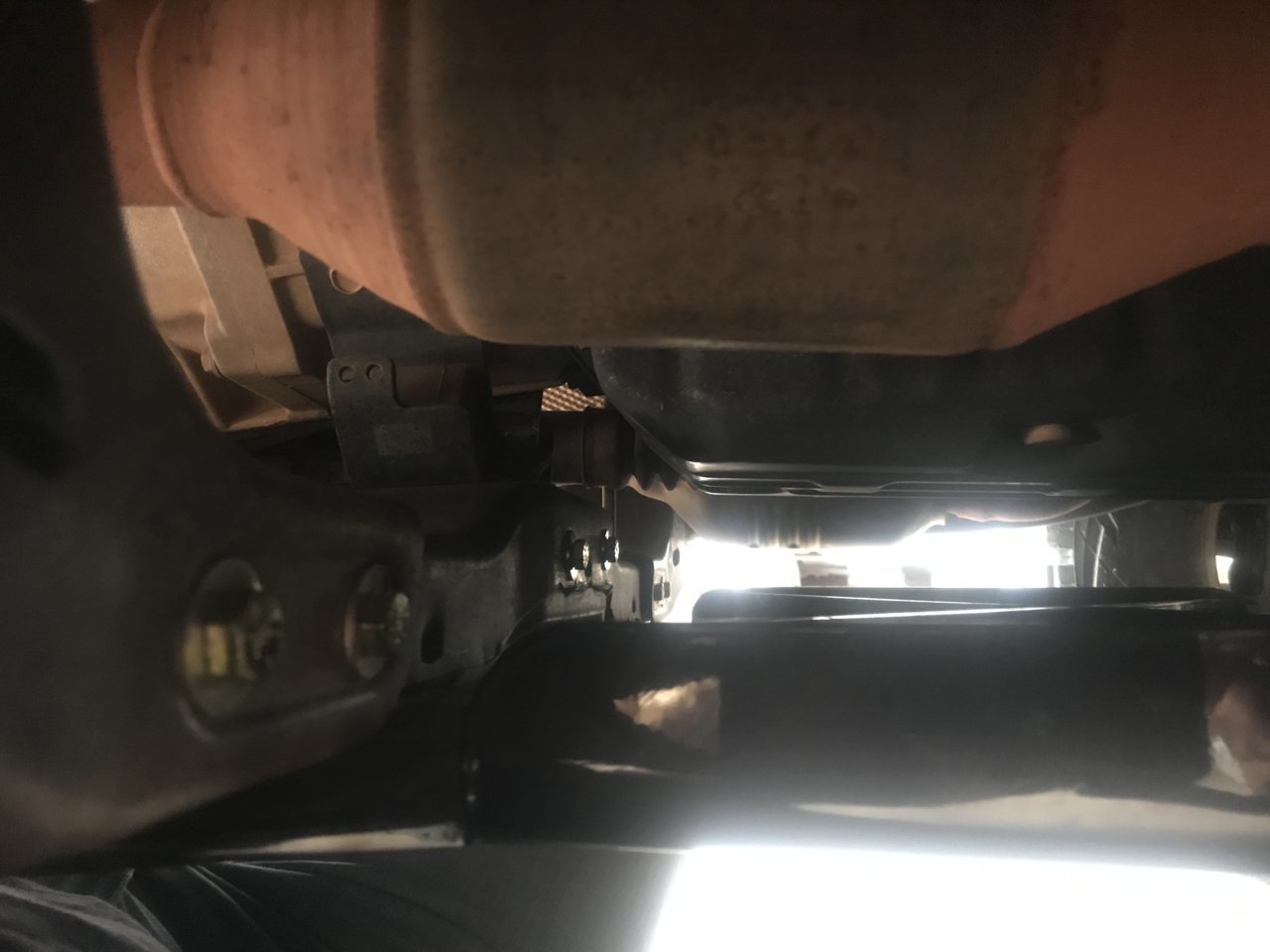

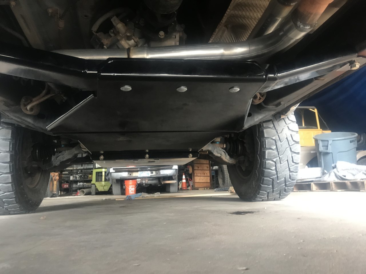

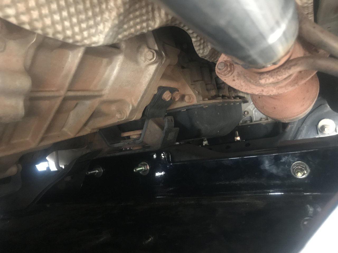

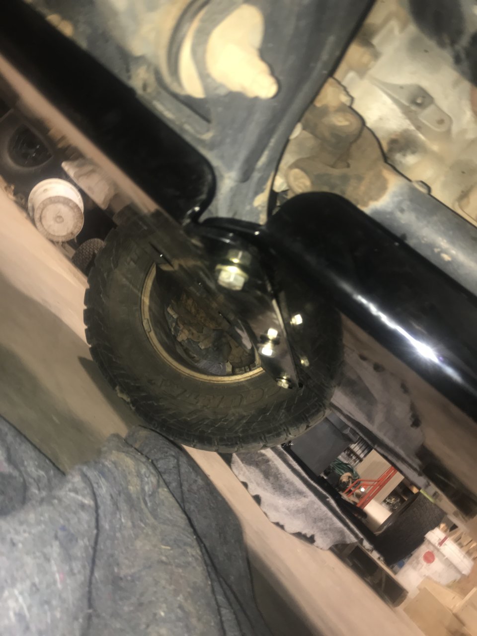

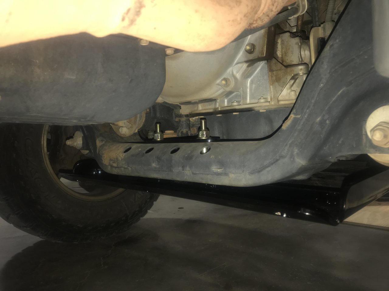

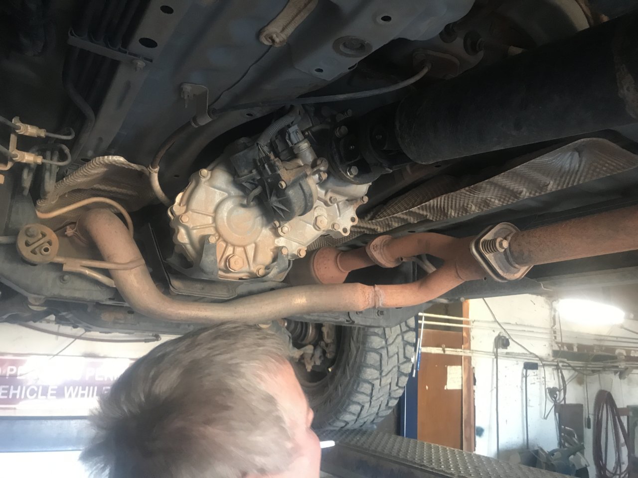

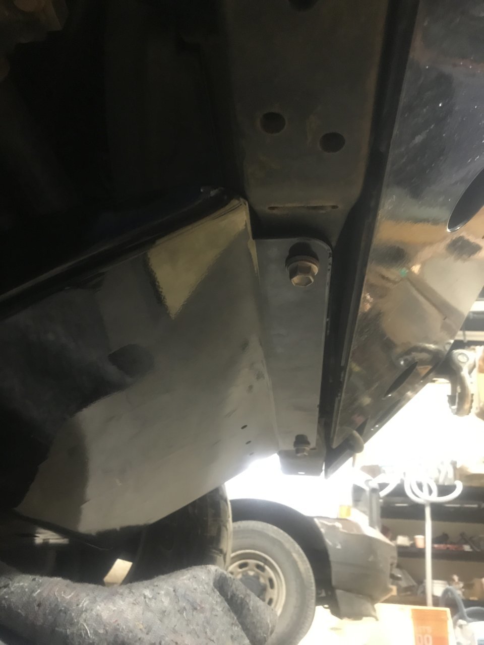

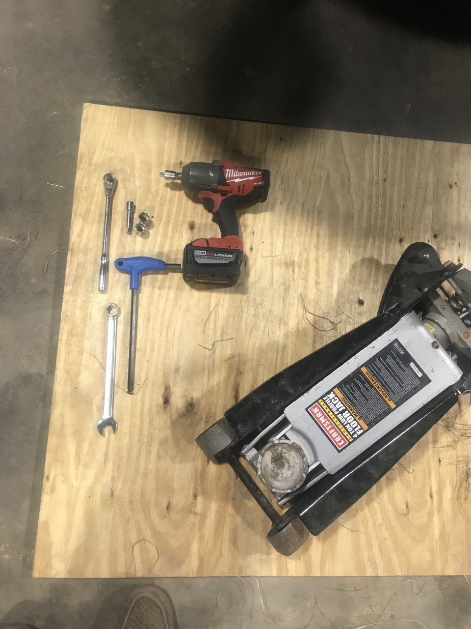

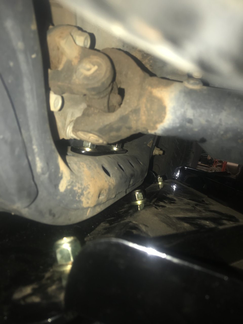

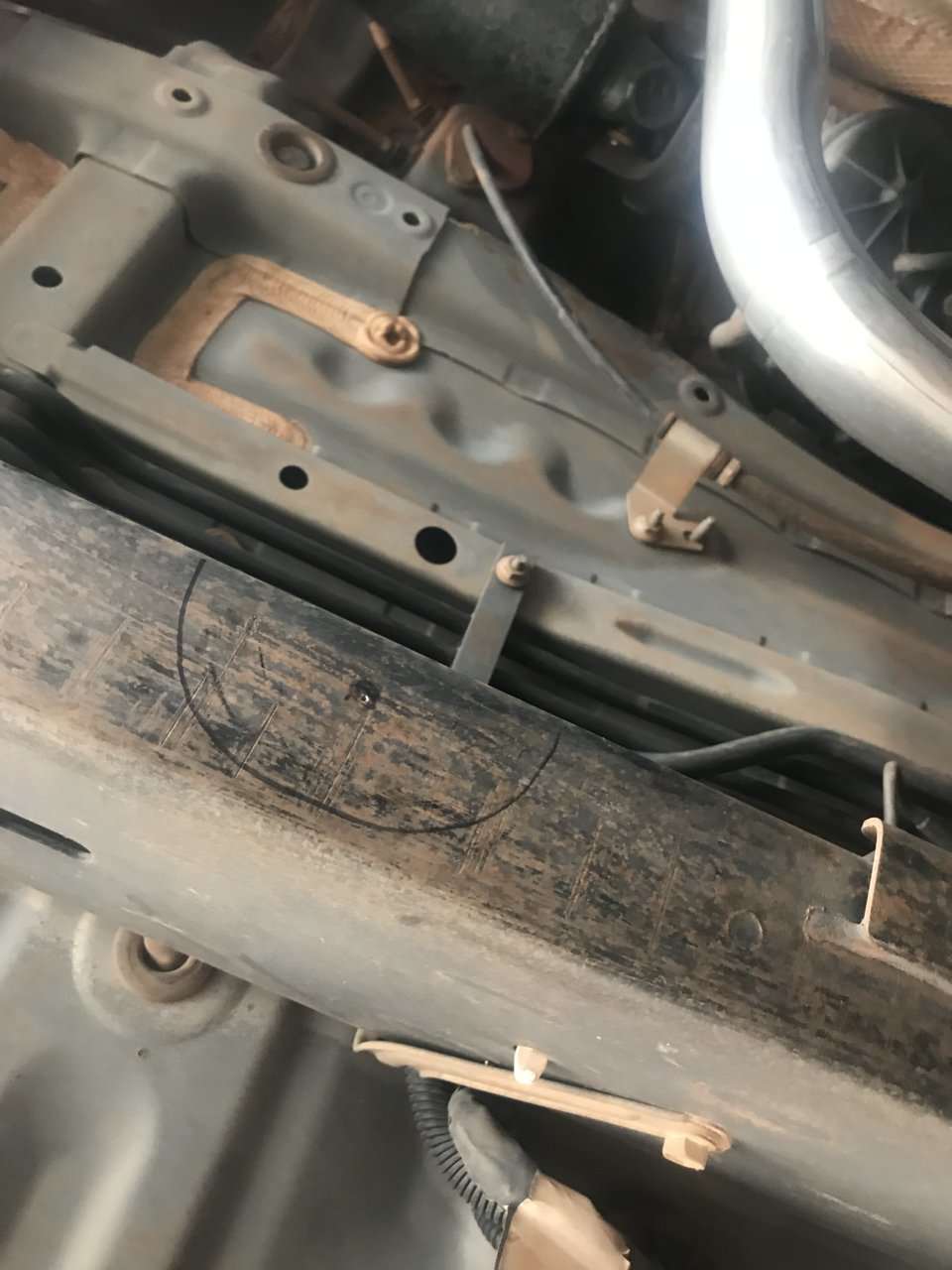

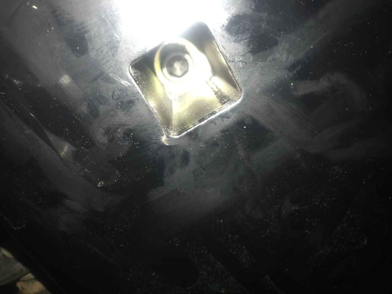

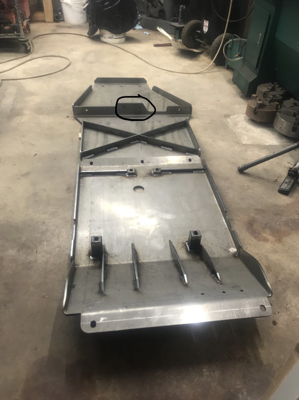

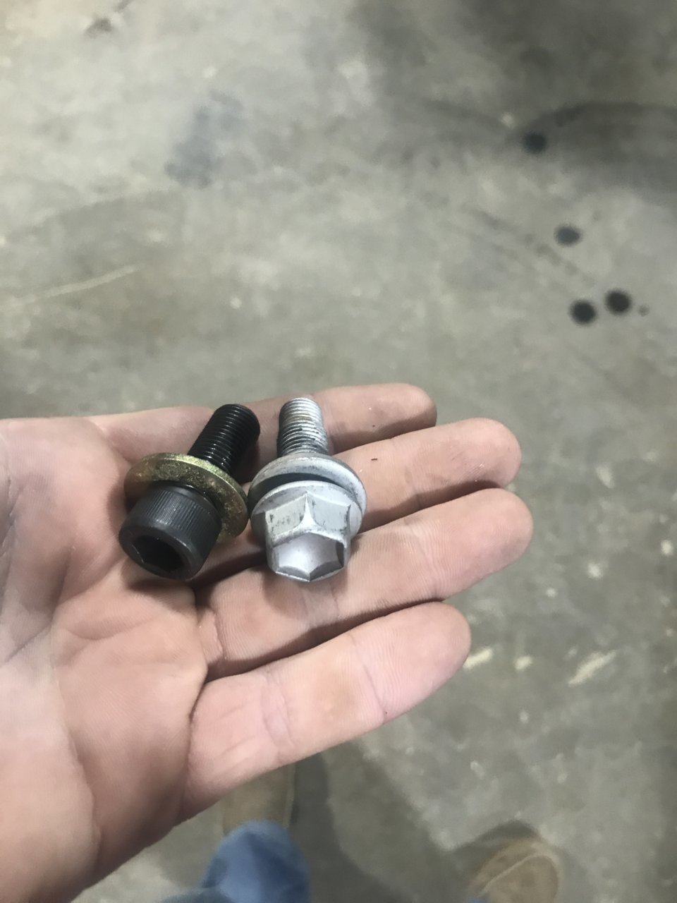

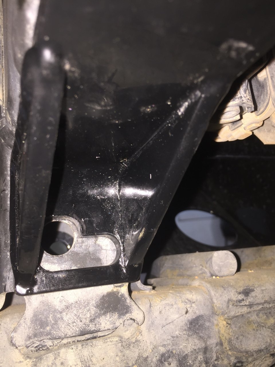

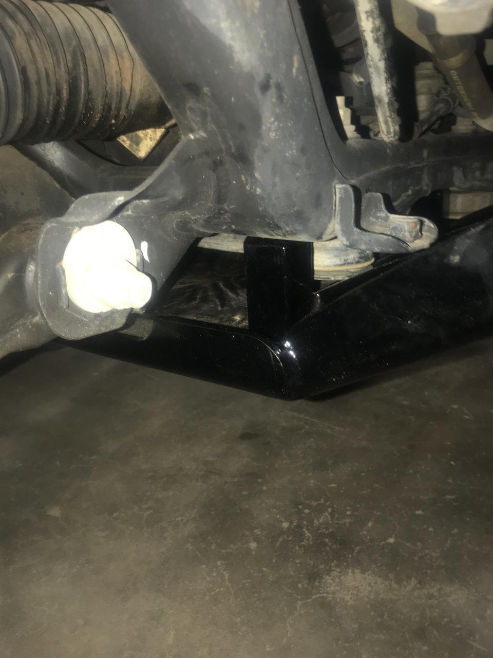

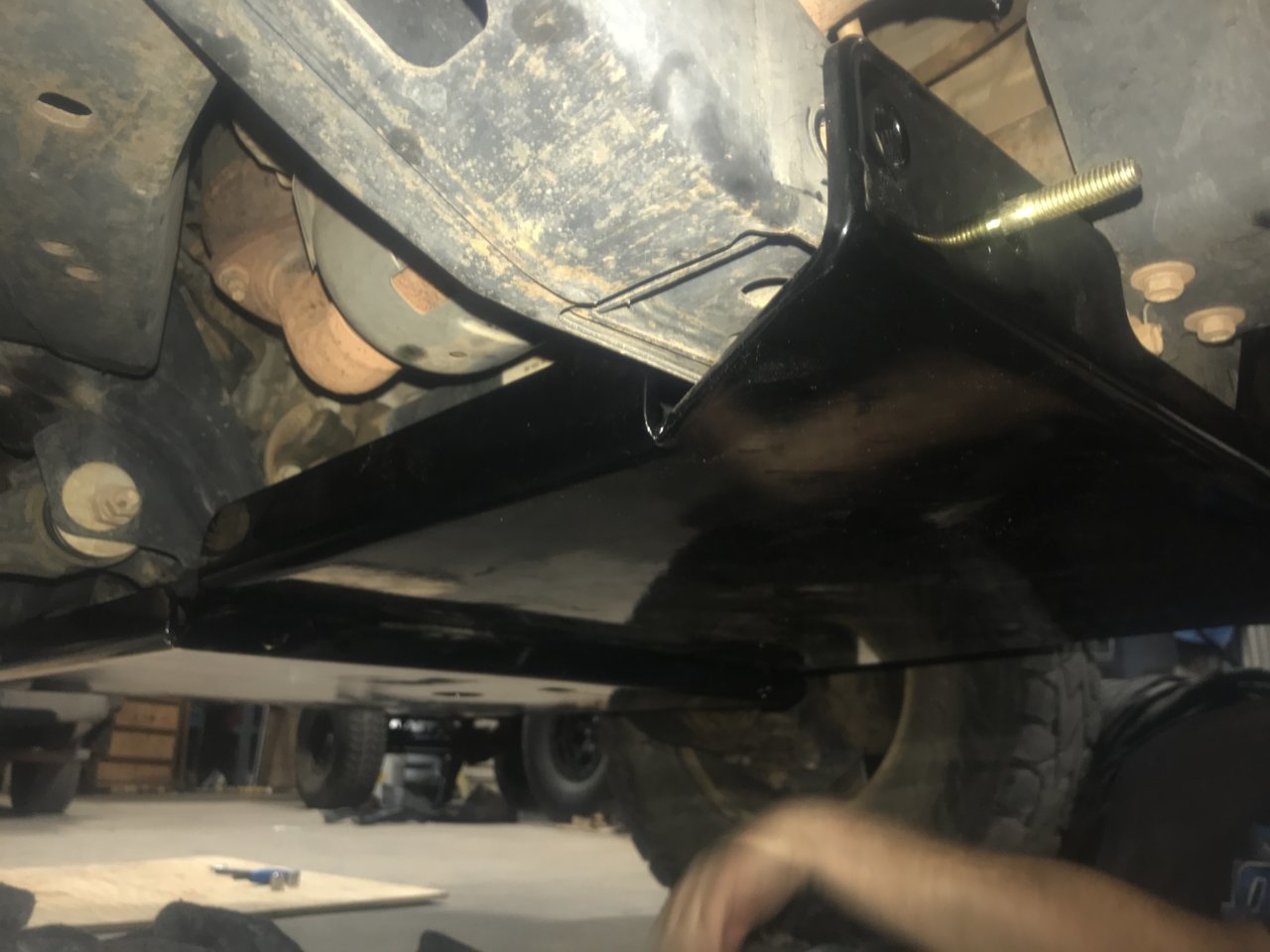

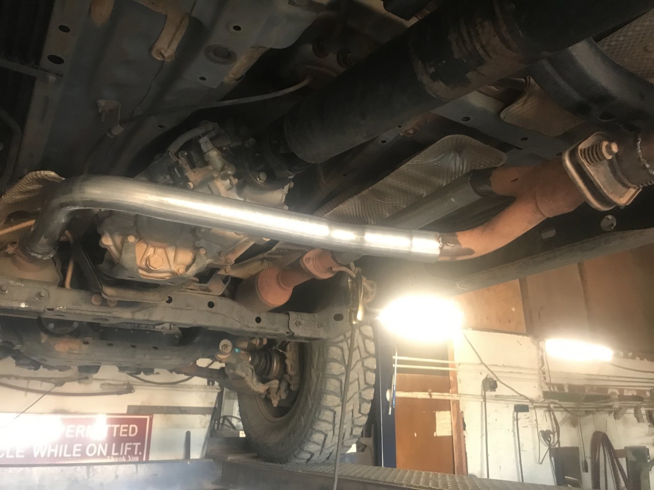

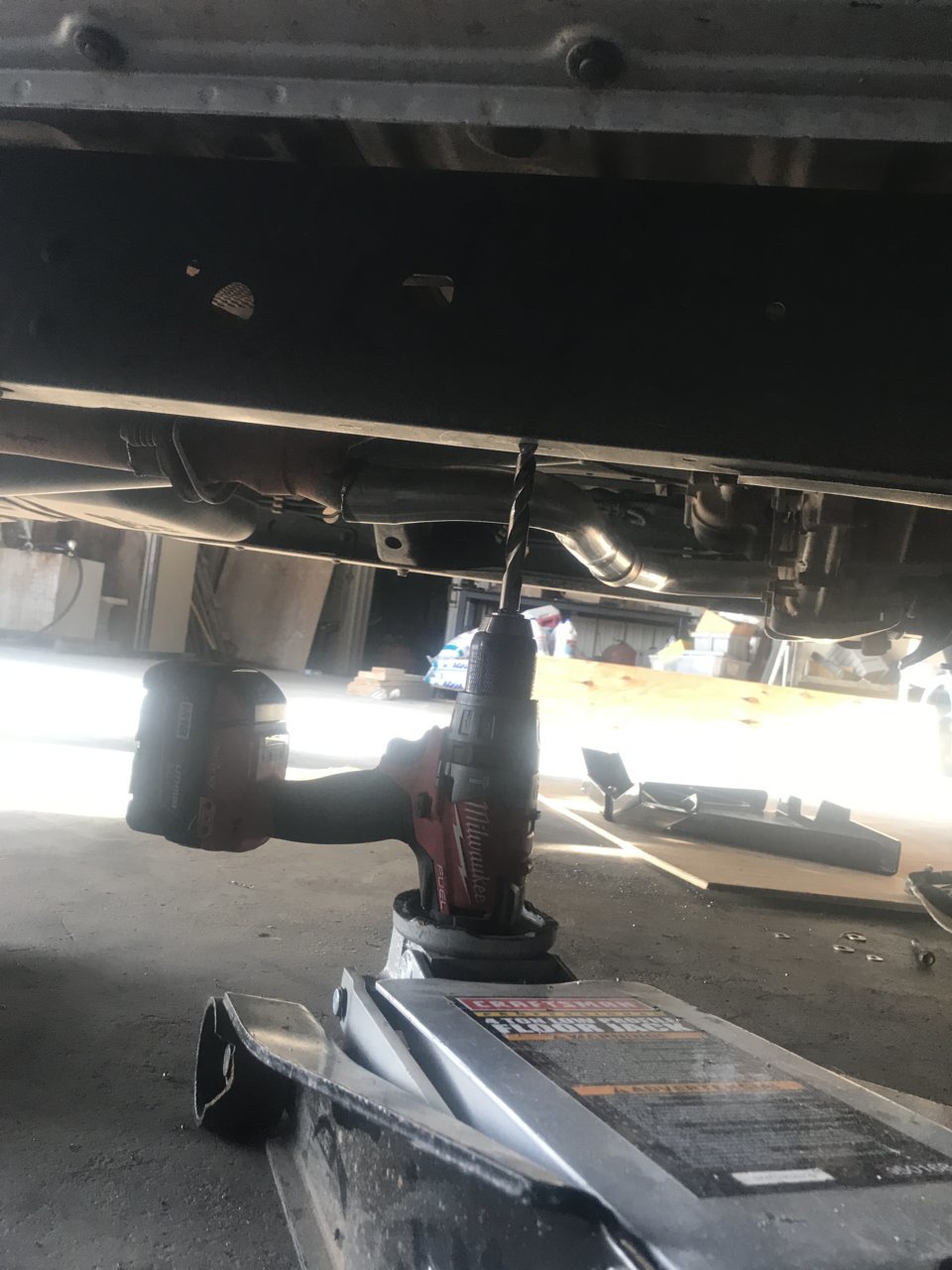

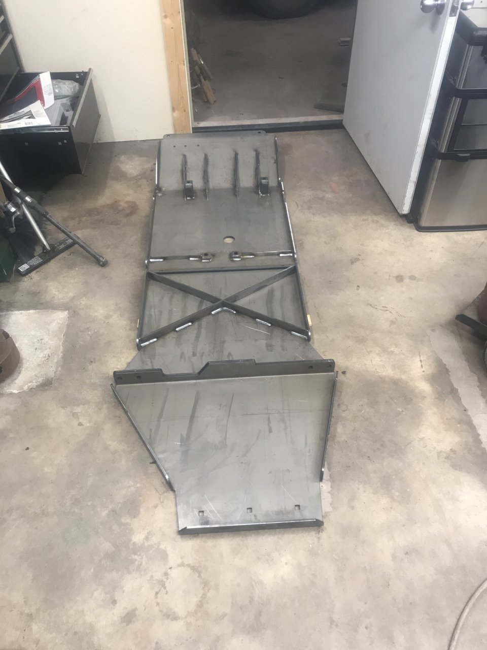

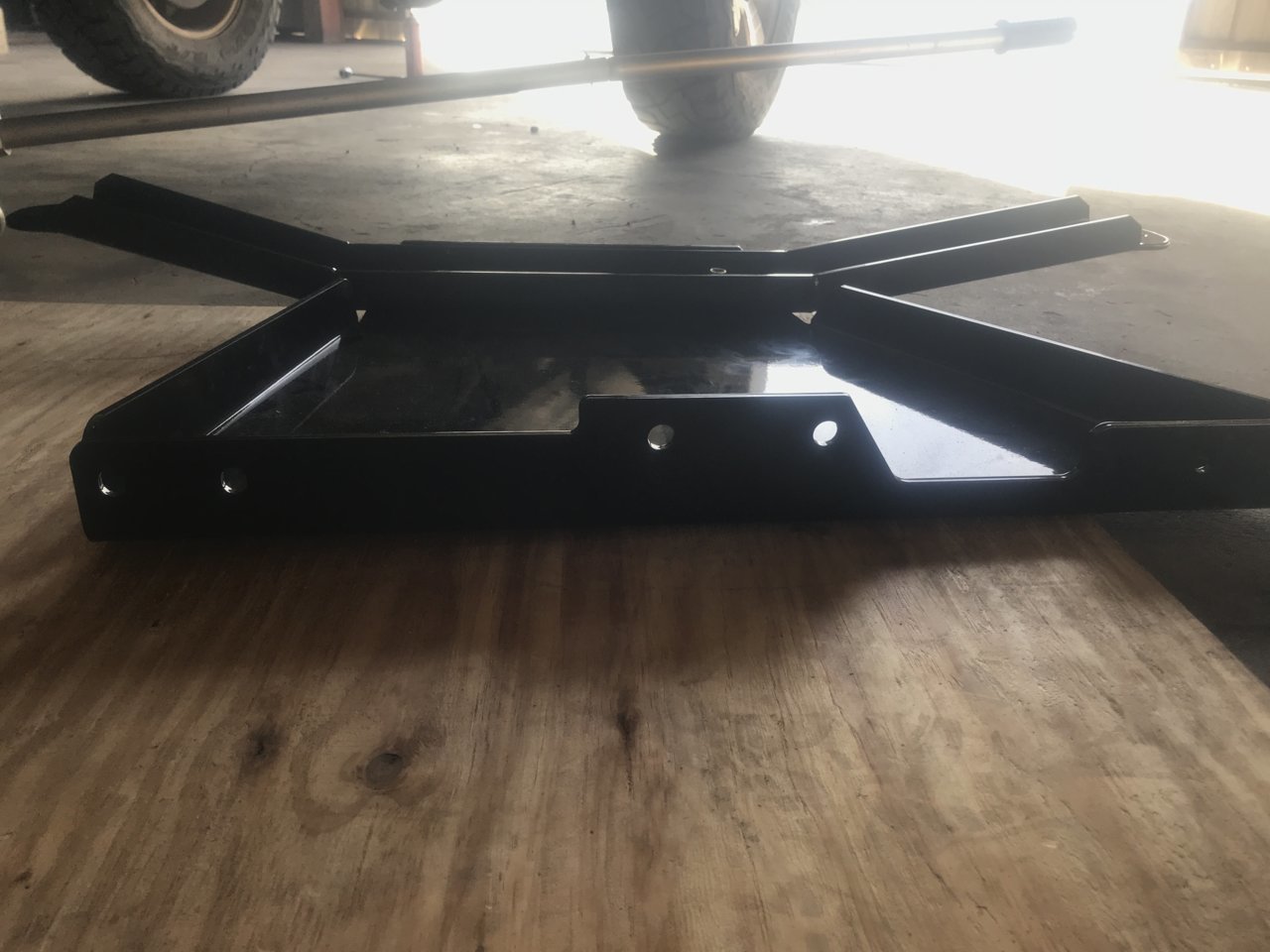

    Well Figured it was time to do a update in here of some progress I have made on the truck. So prepared for massive photo dump. I toke a bunch of pictures with the intentions to make a how to thread on install BAMF trilogy skids, but its been a minute since I installed these so I don’t remember some details. So I’ll attempt a half-ass write up in here. That been said If you damage yourself or your truck using these I take no responsibility.
    You'll have to get a exhaust re-route to be able to run these skids. I got mine done for $80 bucks down at the local chop and weld place.

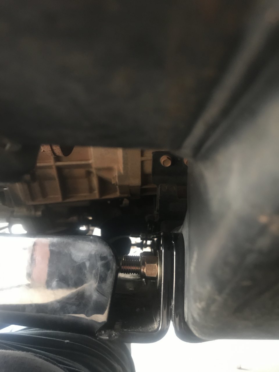

    The skids themselves. These things are beefy af and well-built. These things are heavy, but perfect for some that actually wheels their truck or thinks they are going to.

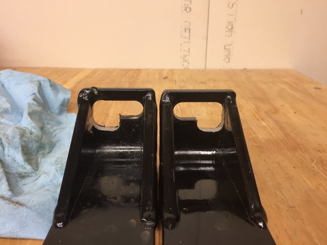

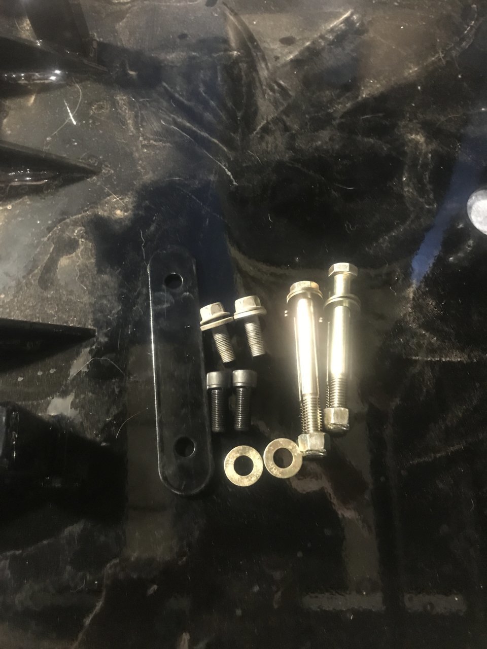

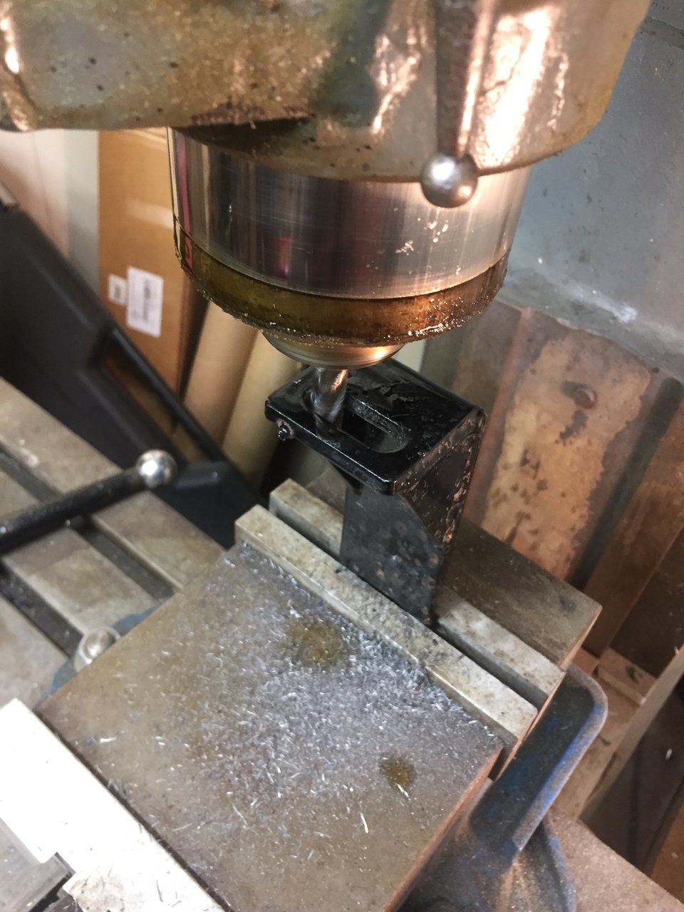

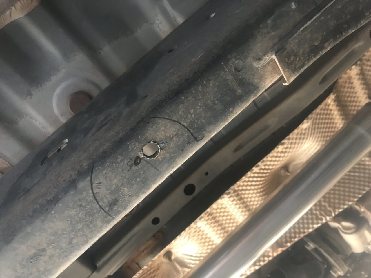

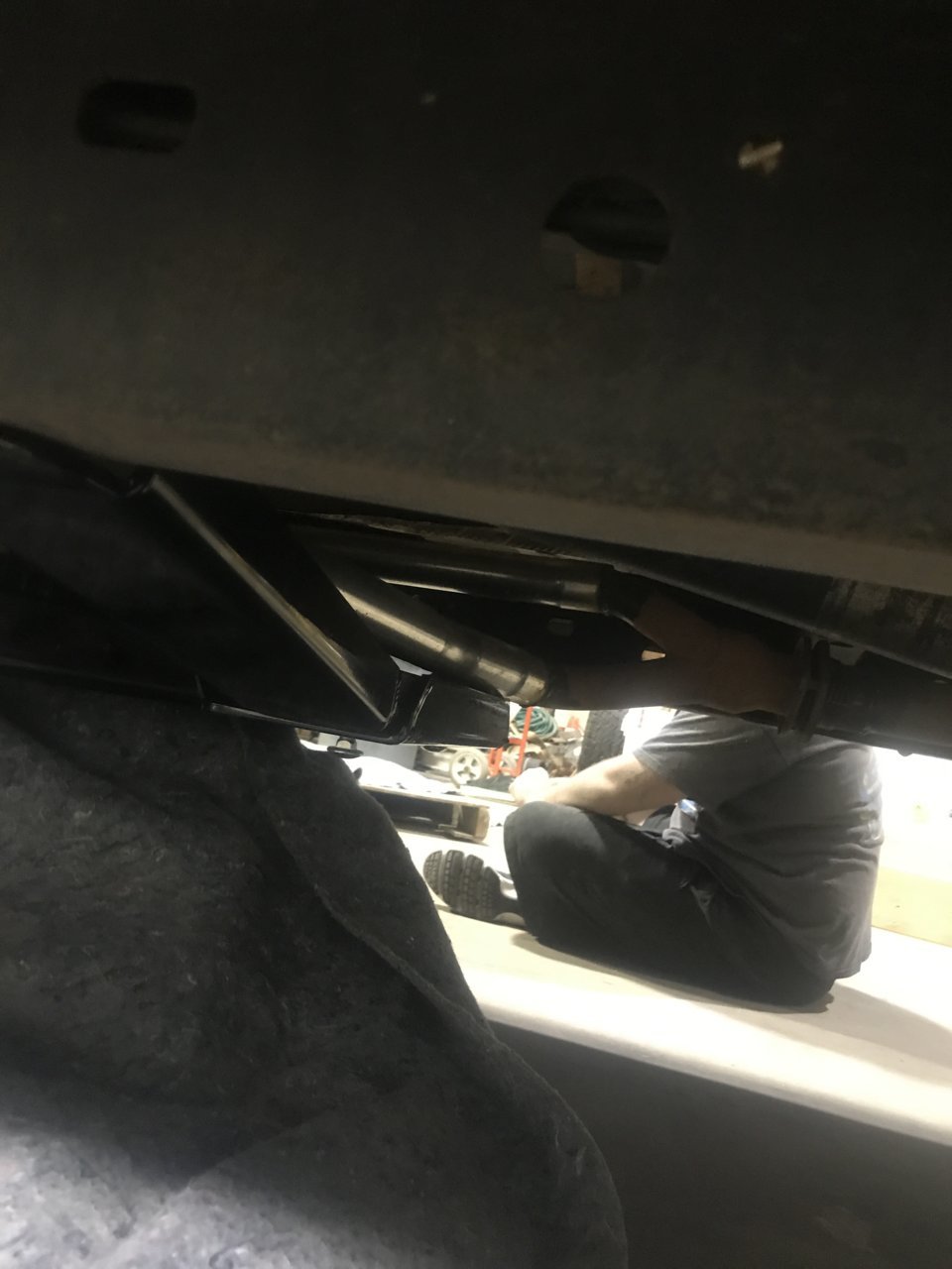

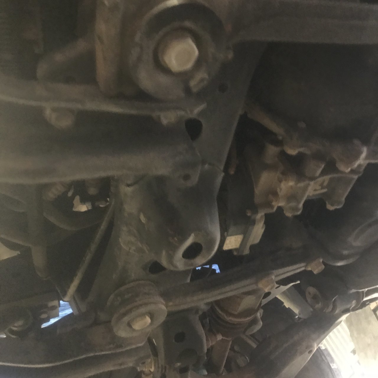

    So I called @JLee to ask if the transfer case skid had missed getting these holes cut out (that are circled) he said I had got a mid skid that was in between making the switch from not cutting out the middle holes because they were not needed anymore with proof of testing. I went ahead and drilled them put so I could run the bolts in the middle as you can see thru the install pictures. UPDATE: So after running these skids for about a year now, the middle bolts are pain in the ass to remove when you have to remove the skid to work on stuff, and I believe Jerry is right they don’t add any extra integrity to the skids.

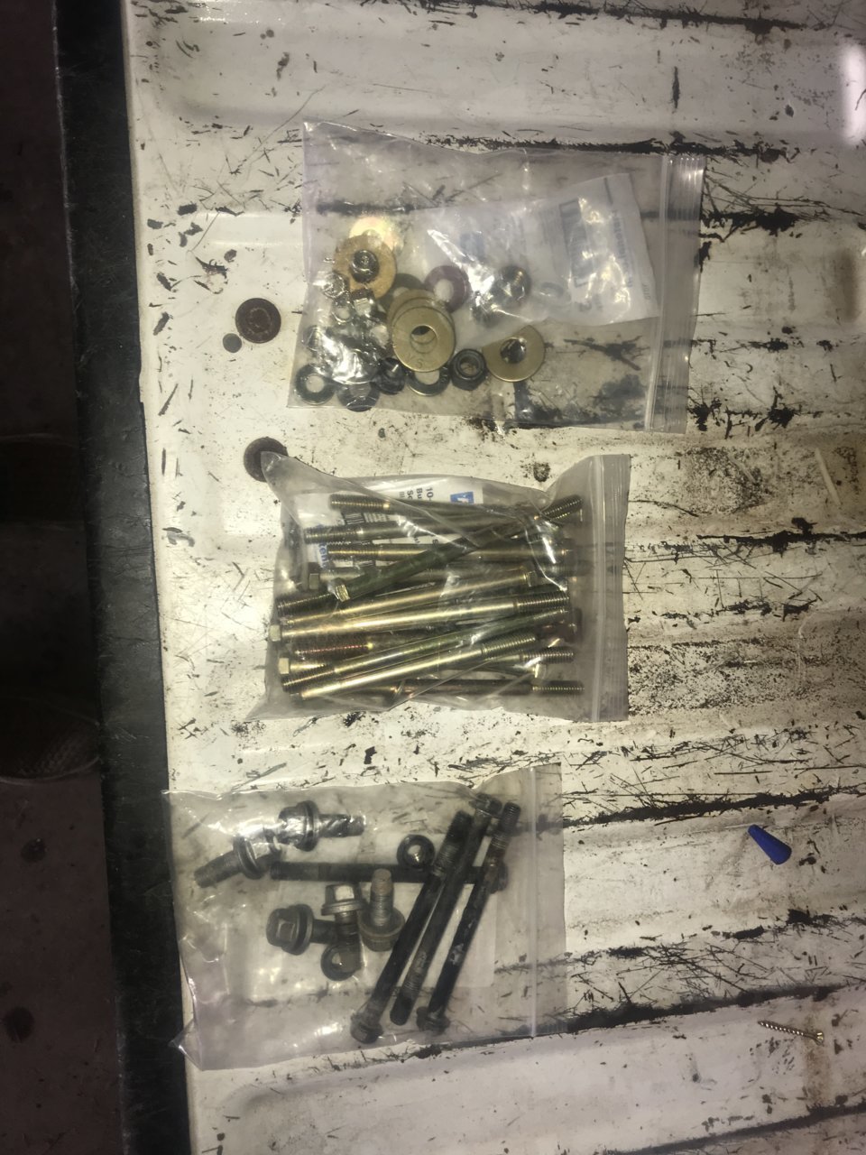

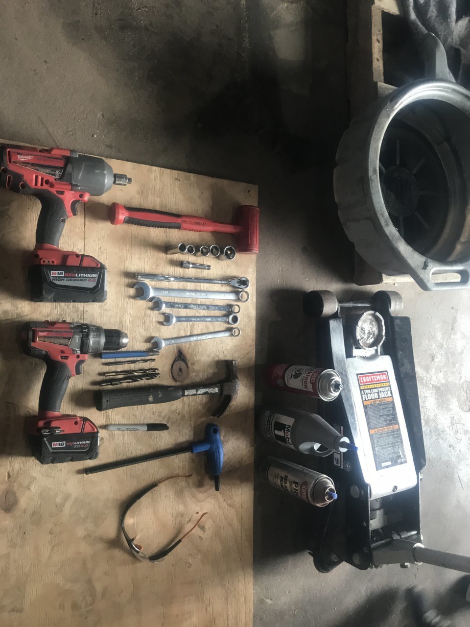

    So above are all the tools you will need if you are doing the full trilogy install. You may not need the allen wrench anymore as I believe the new set is using the factory bolts instead. I also changed my front diff oil while I was at it, so I didn't have to remove it in 10,000 miles.
    Tools:
    Safety glasses
    Gloves
    Jack (Daniels)
    Impact ( not required but dam does it make it easier)
    Drill with a 1/2" chuck
    Hammer
    8mm Allen Wrench or socket (socket is easier)
    Dead blow hammer
    Two 9/16" wrenches ( a ratcheting one will help you wonders with putting the transfer case skid on)
    One 14mm wrench
    One 3/4" wrench ( a stubby would help with the tight space for the mid skid bolts)
    Ratchet
    3" extension
    3/4" socket
    17mm socket
    9/16" deep and shallow socket
    14mm socket
    various drill bits to step up to 1/2" hole needed
    1/2" drill bit
    center punch
    sharpie
    can of paint
    a friend or someone you tricked in to thinking this would only take an hour I promise.

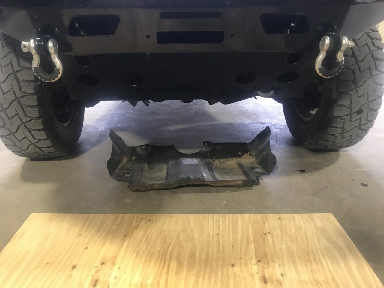

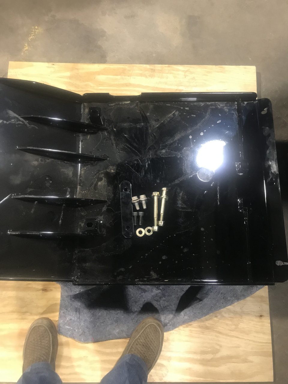

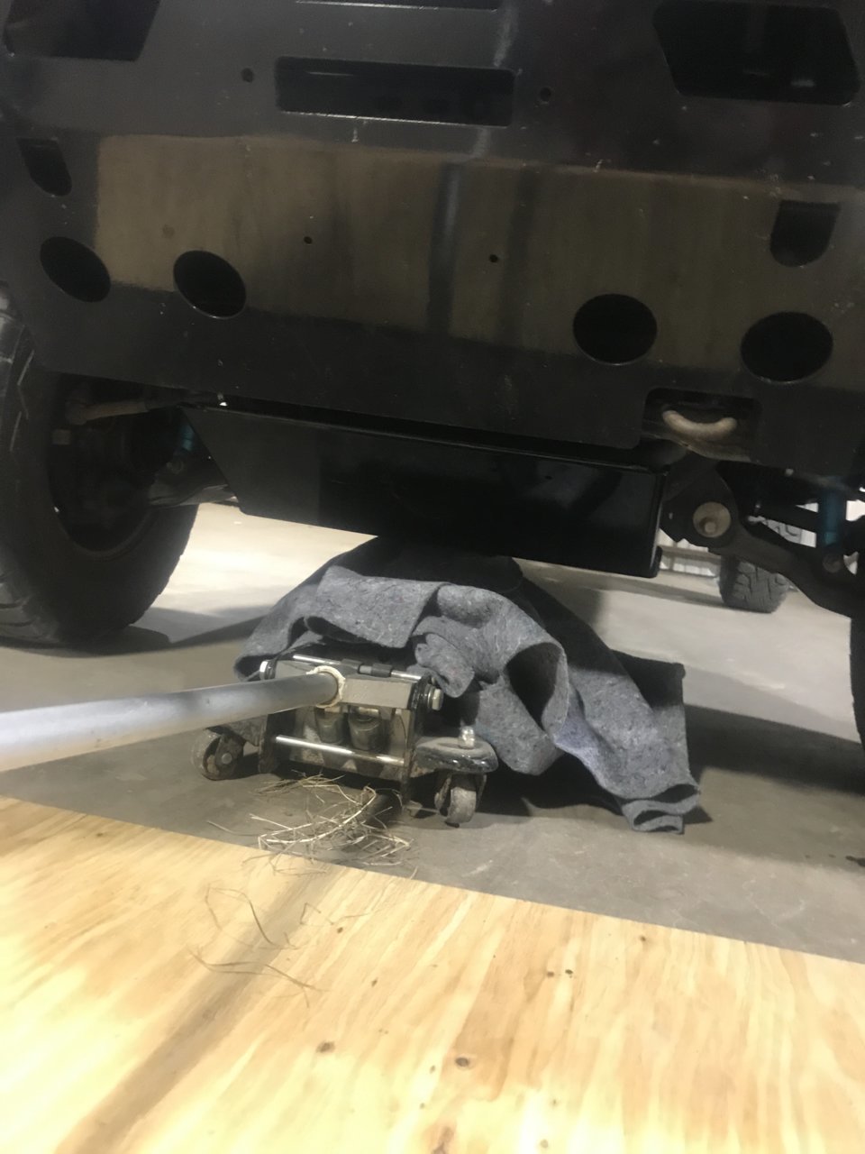

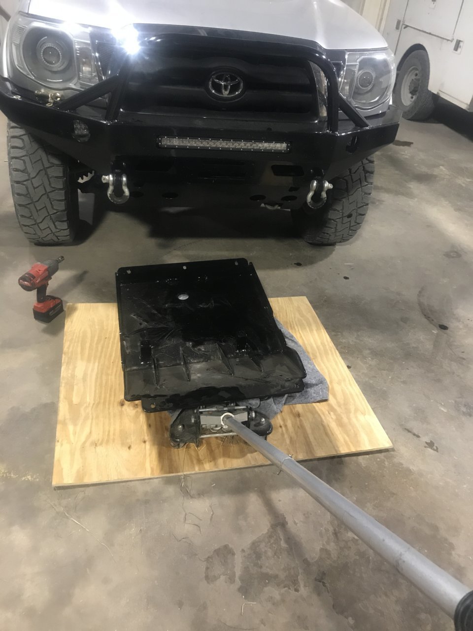

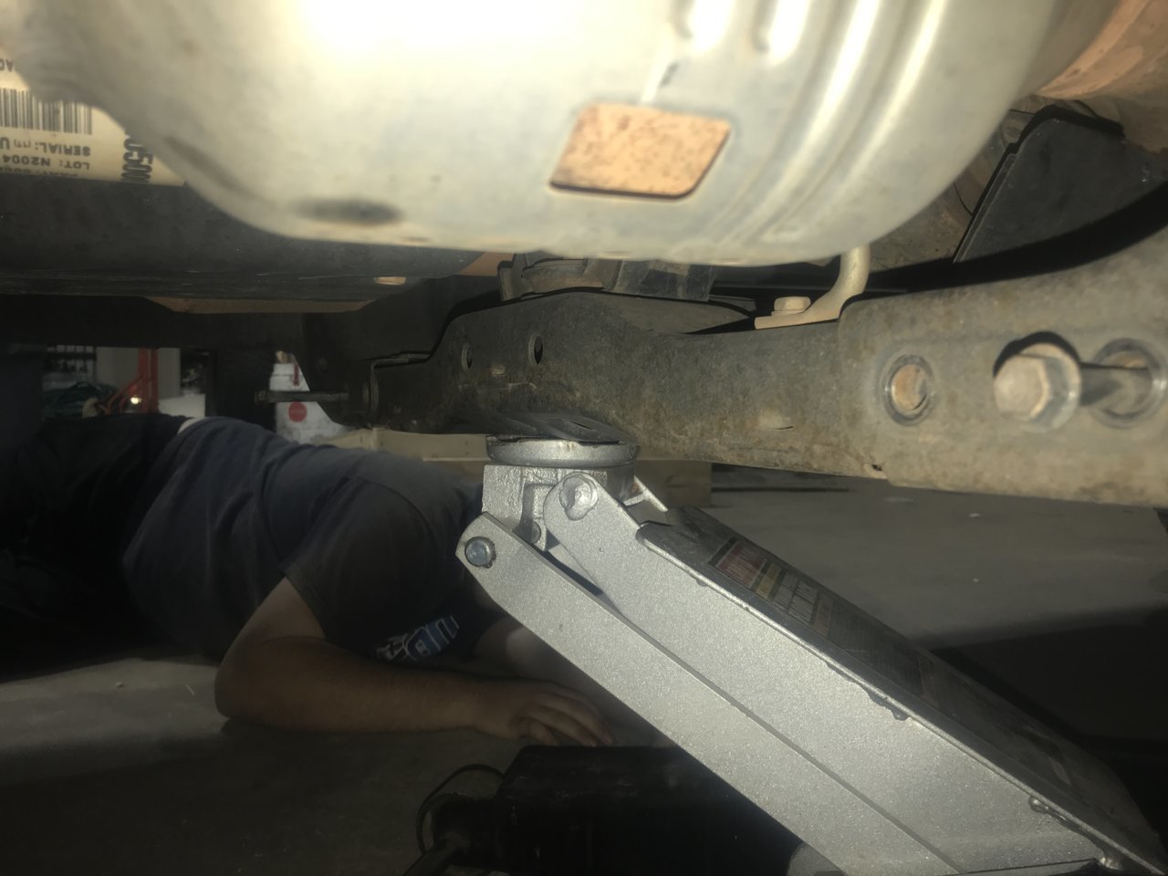

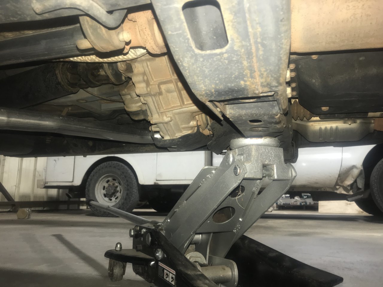

    Above is the picture of tools if you are just installing the IFS Skid. Once again I believe the new design doesn't require a allen wrench because it uses the stock bolts.
    Tools:
    Jack
    Impact
    Ratchet
    3" extension
    3/4" socket
    17mm socket
    3/4" wrench

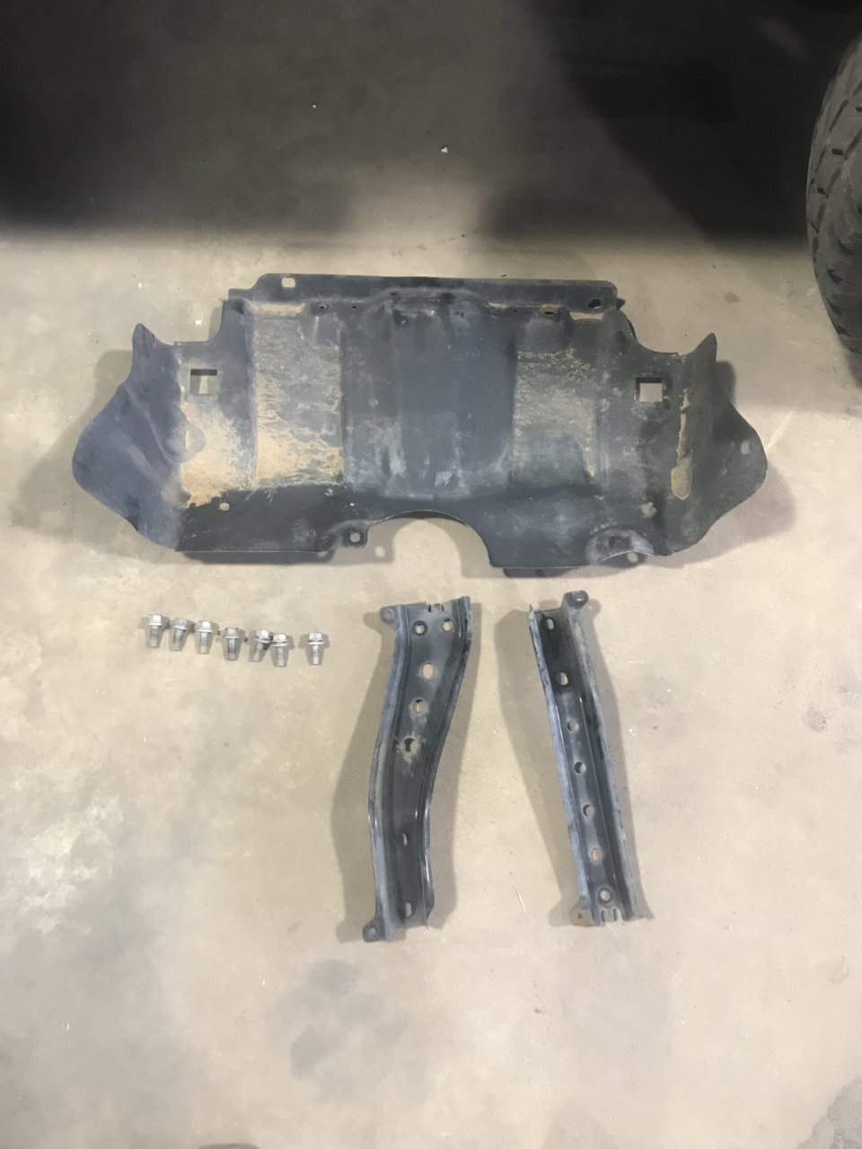

    First you're going to want to drop the stock skid.
    Then your going to need a 17mm socket you remove these support brackets 3 bolts per side. You'll need two of these bolts to install the new skid, so don't throw them to far. upload_2019-5-12_15-15-1.jpg
    Heres what you will be removing.
    Heres what you will need to install the IFS skid
    There is a bunch of 3/8" bolts included in the packaging use the two shorter ones for this.
    This is the easiest way I found to put it up and take it down for maintenance, and yes I used a blanket to keep the jack from scratching the skid. :rofl:
    Use the stock bolts here to secure it with the jack still supporting it, then put the allen bolts in using the 8mm allen wrench so that way the skid will support itself and you can remove the jack to get to the rear bolts.
    The flat strap piece goes on top of the cross member then feed the bolts thru. Use a 9/16" wrench and socket to tighten the nuts. Torque spec 3 ugga duggas.
    Where the allen bolts go, a socket here would have been easier than a wrench. upload_2019-5-12_15-21-43.jpg
    Okay so now for the mid-skid, if you only bought the IFS skid go back on BAMF website and order the rest of the skids so you can continue follow along! So the mid skid gave me the most trouble, mostly because of my jack placement, and I had to switch the bolts out after realizing there was not enough thread showing on the bolts to properly tighten. upload_2019-5-12_15-22-19.jpg
    So here is the important part about jack placement so you don't have to reinsert the bolts to move jack later. DON'T put the jack directly on the crossmember like I did, put it on the transfer case because the mid skid wraps around this crossmember. Use a 14mm wrench and socket and remove the 4 stock bolts and discard.
    Here is what you will need to install the mid skid.
    Heres where it pays to either have a friend or another jack to lift this heavy sob in place. My friend that I convinced this wouldn't take that long.
    So the easiest way to put this up is the rest the lip of the mid skid on the IFS Skid then lift up in place and each person feed one bolt thru the crossmember so it supports itself. Here you can also see I had to move the jack to a different place.
    Put the three 1/2" bolts in the front of the mid skid. The mid skid should be on top of the IFS Skid and they bolt together. Use a 3/4" wrench and socket to tighten.
    Here you can see the problem I was having about not there not being enough thread showing. Yes, I put the transfer skid on to see if it added enough metal so I could tighten and it didn't. No biggie a quick trip to Fastenal, and we were back in action.
    Now we are ready to install the transfer skid. Go ahead and install the transfer case crossmember so you can test fit it and mark holes for drilling.
    Using a jack get it up there and somewhat in place to mark holes
    Using a center punch give it a good ole whack to give your drill bit somewhere to start
    I also outlined it with a sharpie, still to this day don't know why
    Time to break out the poor man magnetic drill press. Be very careful doing this and take it slow. Wear some safety glasses and gloves here. The drill will kickback if you add to much pressure to fast. Start with a smaller drill bit and work your way up to 1/2"
    So I marked this side then realized I was on the frame rail on the other side, so I had to readjust but just punched this side and didn't remark. Here is the final 1/2" hole. Don't forget to spray paint the holes to ensure no rust occurs.
    You can see the difference in exposed thread here after switching the bolts.
    Go ahead and jack up the transfer skid. Insert the front of the transfer skid in the bolts going thru the transmission crossmember, but don't put any nuts on. Go back to the transfer case crossmember and put the 1/2" bolts and nuts in and tighten that. It will hold itself now.
    Now for the fun part of tighten these bolts down on the transmission crossmember. These are a beach, I found having a ratcheting wrench saves a bunch of time. I understood right here why Jerry Said I didn't need to have the middle bolts. I gave them all the ugga duggas I could.
    Boom you done! Congrats, now go slam on some rocks worry free.
    This is all the bolts and nuts I had left over. He gives all kinds of extras just in case.
