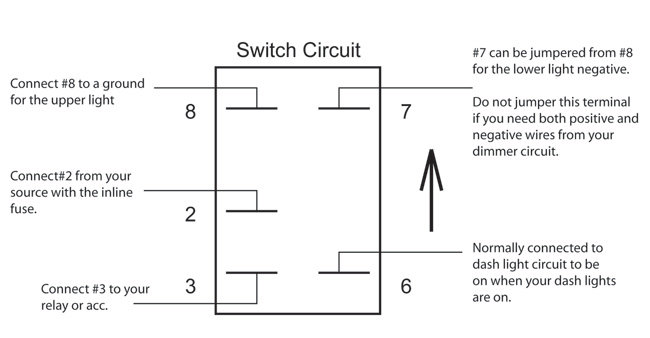

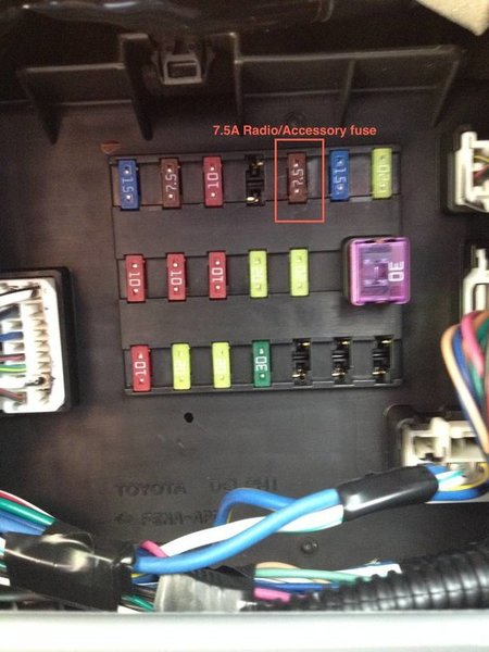

    i need help guys, where can i tap into to get ignition power to my rocker switches ?

    Easiest place is to add a fuse to the ACC fuse spot behind your coin tray. I forget the fuse location, but you'll see it. That way your switches light up along with your interior lights. I have mine wired differently since they only have one light (for when the powered item is on), in pulled power straight from my fuse block and daisy chained them together. I know most guys have switches with two lights (one for the accessory and one when the switch is powered).

    yes i have the dual light otrattw switches might need a little more help lol

    Does this help? You can jump 7 and 8 together (ground) for all the switches in the group. 2 is your positive "in" (from the fuse block/relay) and 3 is your positive "out" to the lightbar or whatever. 6 is from the add-a-fuse that you can tap into your fuse panel behind the coin tray which can again be jumped together for all your switches. That should be good. Let me know. If you can wait for mod-day, I can bring my goodies and help you with this.:thumbsup:

    much appreciated Serg. i actually daisy chained all 4 of my switches and got power to all, the main thing im trying to do is find a suitable wire to tap into for dash lights lol and maybe ignition, so my switches arnt always hot

    Ah! Gotcha. Well, when using the aux fuse block (blue sea or bussman), the switches are always going to be "hot", unless you wire the entire fuse block from an acc fuse with a relay. Wiring it the way I showed you above, the switches are still going to be hot all the time, but they will not light up unless your car is on, or the light bar is on. That way you don't see the switches glowing while your car is parked at night.

    thats my plan, im just trying to tap # 6 on that picture to the dash lights so when i turn on the headlights at night the lettering with light up

    @2015TRD4X4
    Here's a pic I stole from someone else's thread. You can tap that! Haha!

    boom, thats all i needed lol
