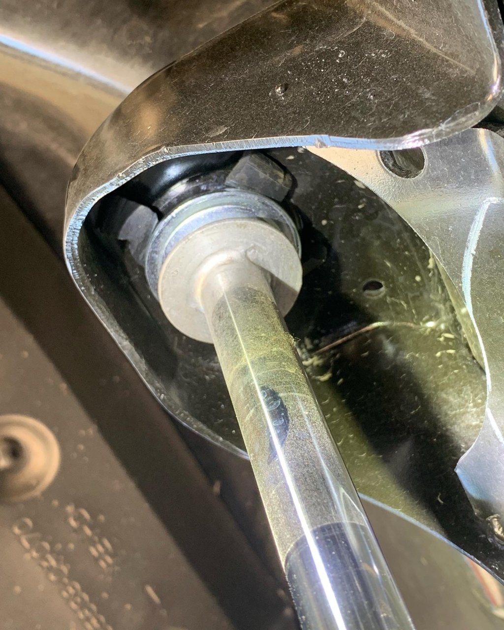

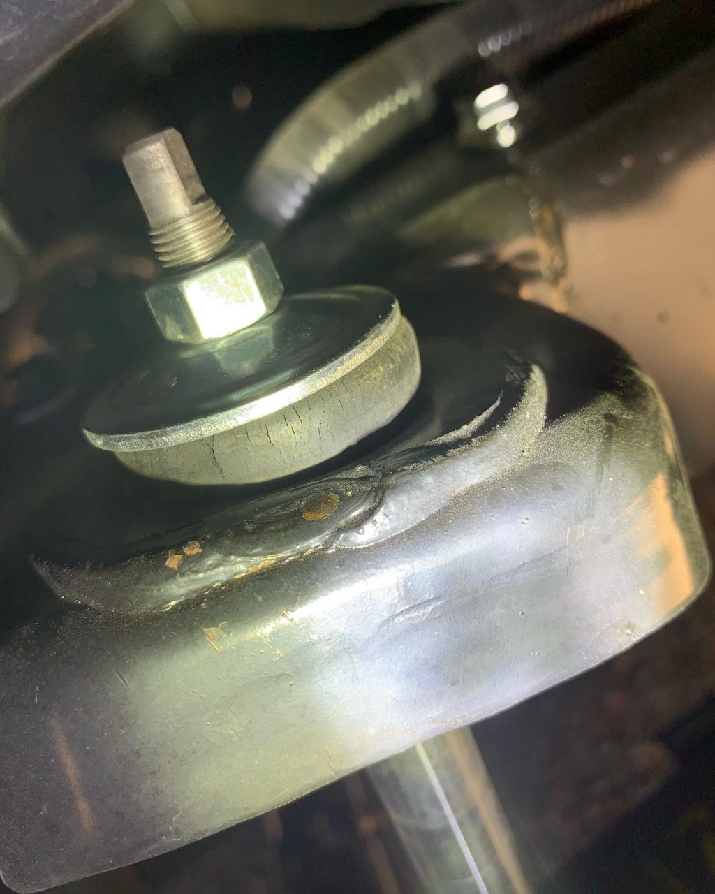

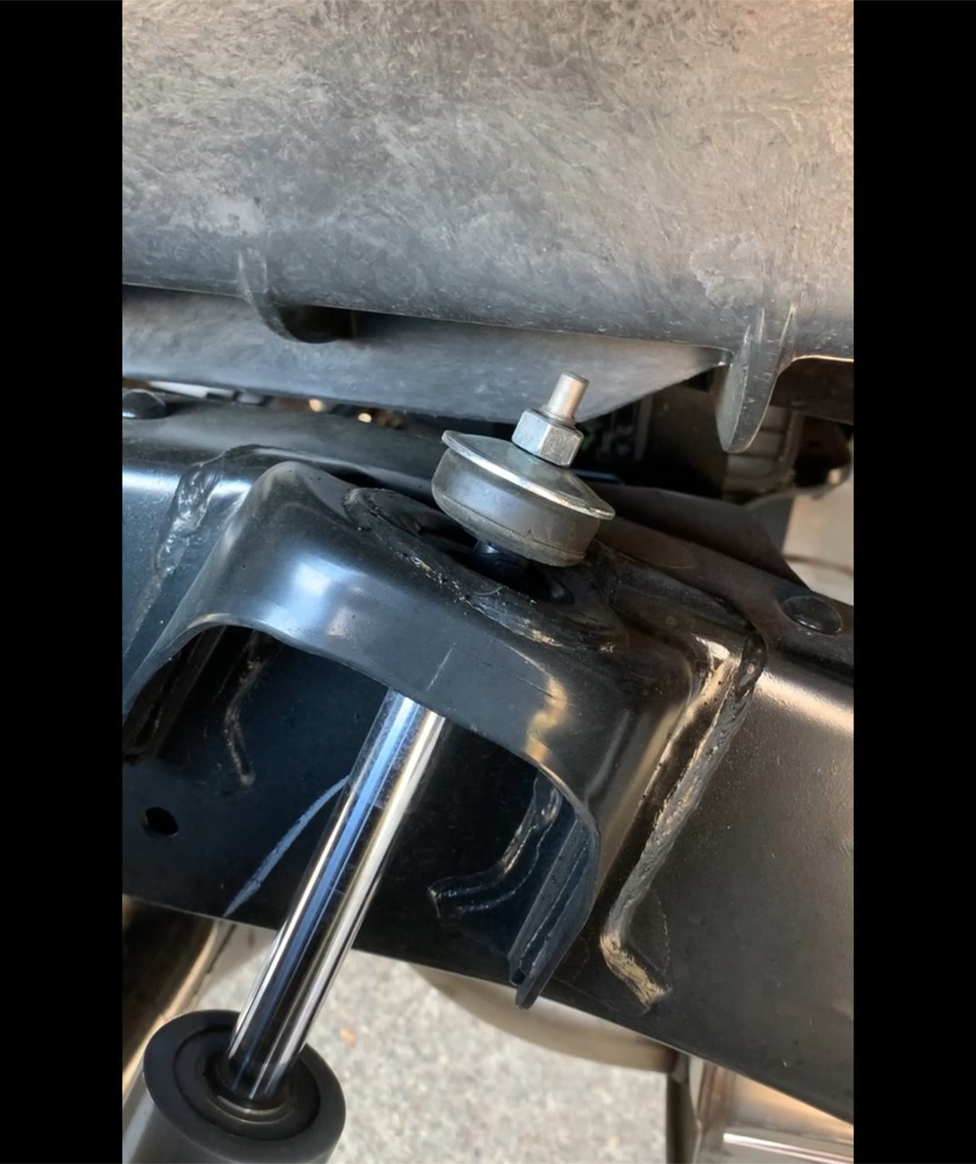

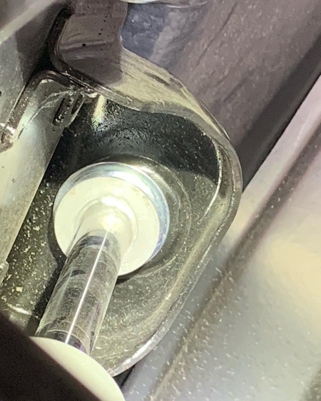

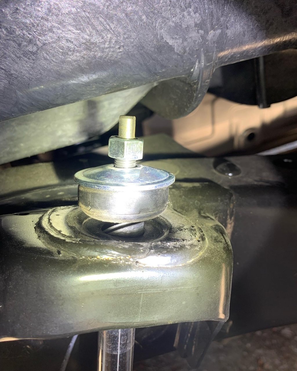

    Anyone have there rear shock come lose this lift was installed by my dealer ship that put it on the truck before I bought it brand new it’s there appearance package i was curious if it could mess anything else up I could fix this but I’m gonna drive it down there the way it is I already went in for one issue I was told to come back if it gets worse now this happened today I’m afraid to drive it

    That is installed improperly, go back to the dealership. its not the end of the world because your leaf springs is what holds up the truck. the shock just makes it more comfortable and more stable. also, learn how to use a period haha.

    It came lose I’m concerned they installed the whole kit incorrectly they are gonna go thru and re torque everything would this cause the truck to pull to the right I guess they gave it a alignment but it does not feel like that

    Look at the other side and count the threads showing above the nut. It looks like they forgot to tighten that shock. Not enough threads showing on that one.

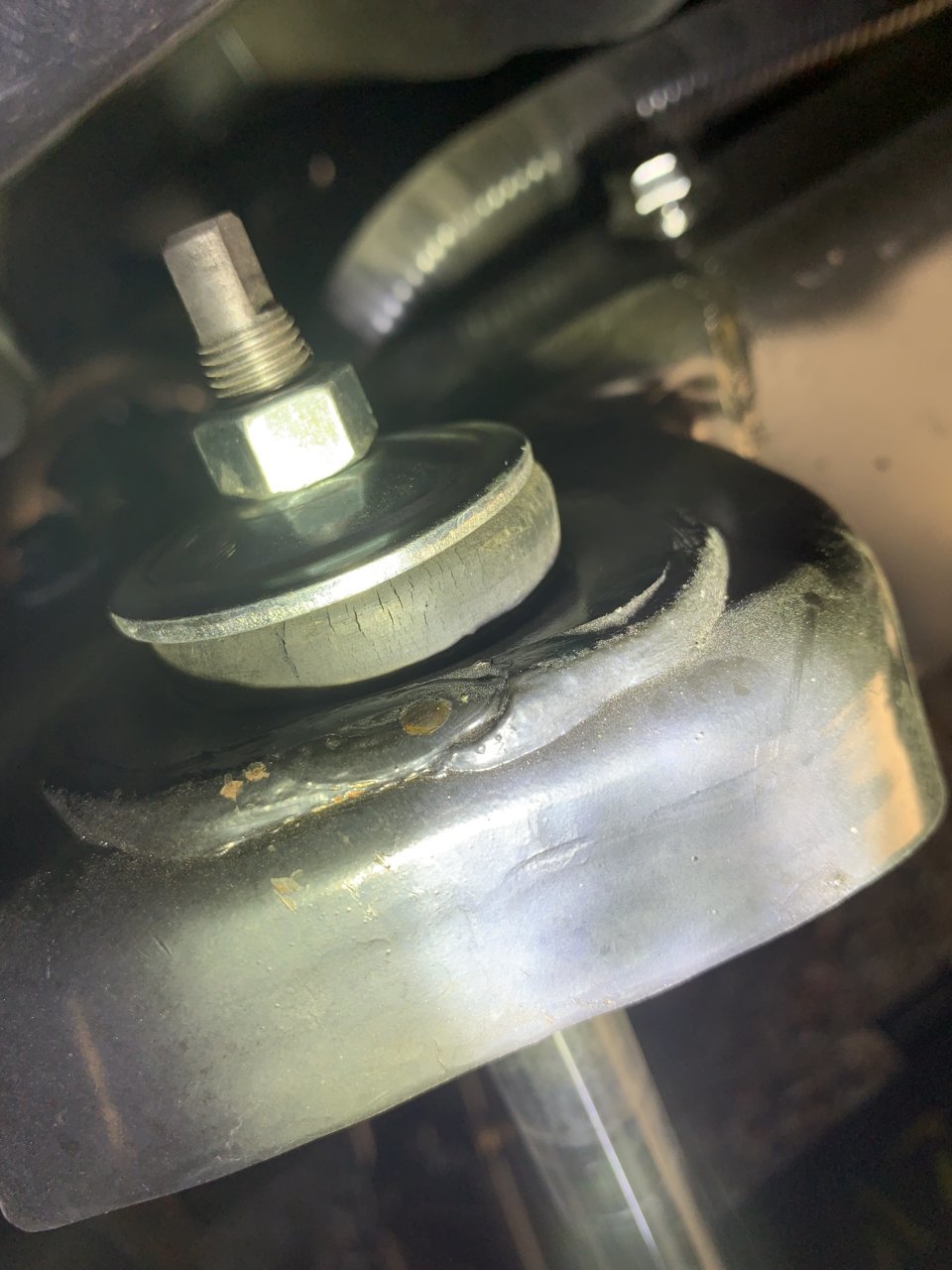

    Dry rotted crush bushings
