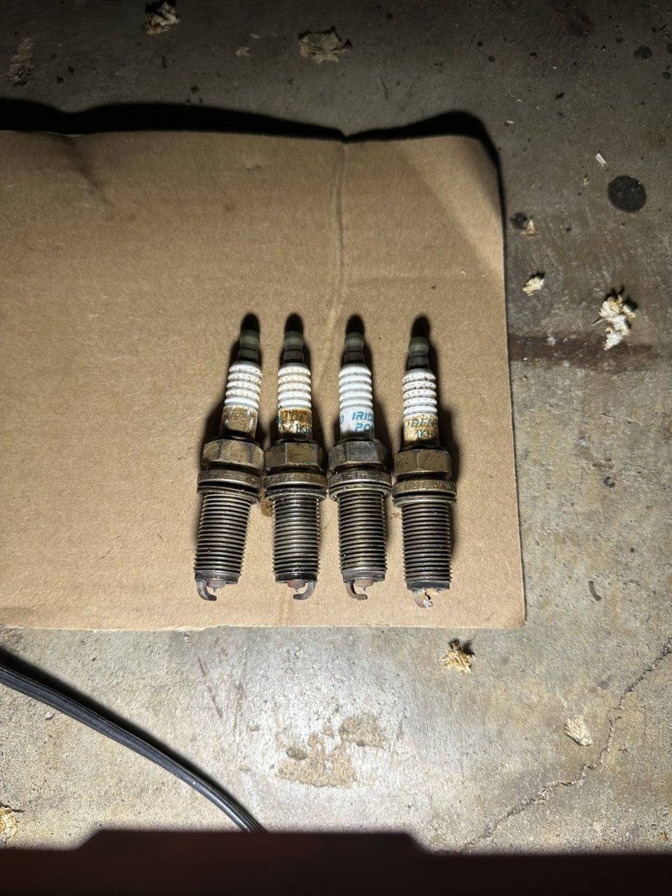

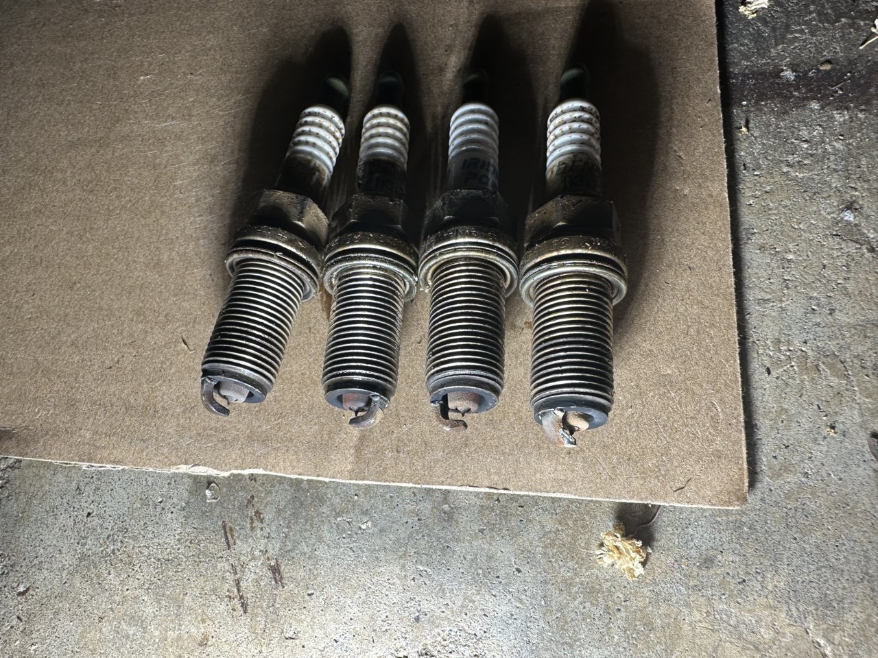

    the two on the right look kinda rusty and crusty, not sure if it’s the lighting. Look into the cylinders with a flashlight, any look significantly cleaner than the others?
    If so, coolant is likely leaking into that/those cylinders and basically steam cleaning them.
    If not, we still can’t rule out a bad HG without a leakdown test. Either pressurizing each cylinder and measure leakdown/watch and listen for signs of it bubbling into the cooling system, or pressurizing the (full) cooling system and seeing if any coolant seeps into the cylinders (or anywhere else for that matter)

    All of the pistons look exactly the same so I really don't know. Tomorrow morning i will be borrowing a compression tester from someone, if all the compression is good it most likely has to be that bypass pipe or the radiator so I will replace both. I also noticed a tiny amount of coolant coming from where the bypass pipe is connected on the engine, but it doesn't really explain why it's losing so much? I also noticed when I got home from work that there was some spillage where the coolant reservoir is, so it seems like it's building some sort of pressure in the system
