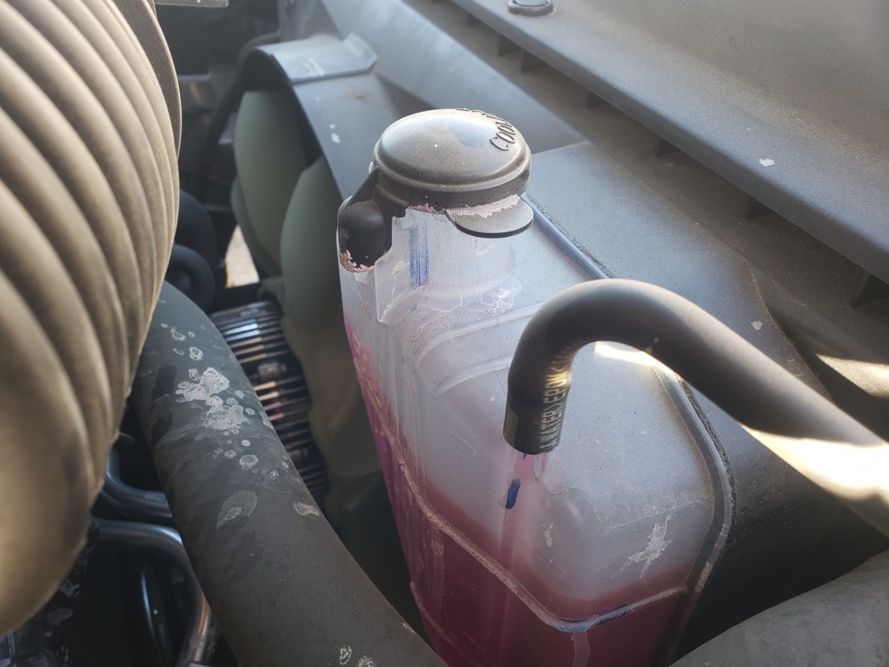

    Well I checked again today and I also think it might be the reservoir cap as well. It looked wet on the outside.

    Also if coolant is coming out of your reservoir cap the reservoir may just be over serviced. I cant see a reason for coolant to be coming out of there for any other reason.

    it looks as if you have an overfilled radiator, your about 1/4" over the fill line on the resvoir I would assume someone overfilled the system and excess coolant escaped thru the caps seal
