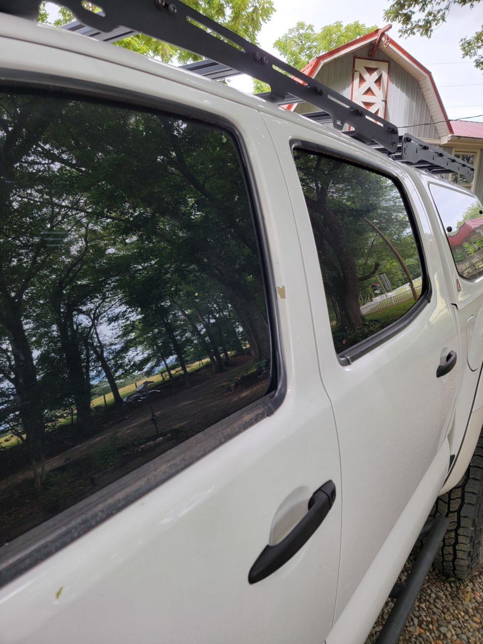

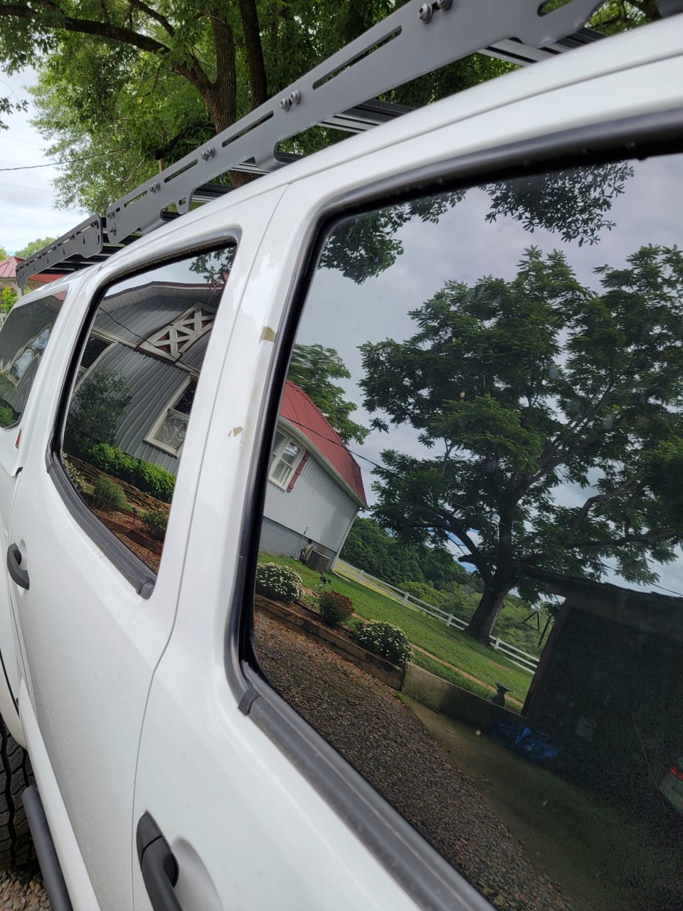

    This happened when I drove across country on the passenger side, my trip up to GA it happened again and now on both sides. Any recommendations on how to prevent this?

    This is a white paint Toyota from 2004-ish onward issue.
    You can try touch up paint and some clear vinyl rock guard stuff. If it’s like their other paint peel issues it’s due to shitty primer not bonding well to the color coat or vice versa.
    I’d not take any strong tape to any areas either, might pull paint with it, like if you go to mask off things to paint or wax, etc.

    That happens because those areas of paint was probably missed with the clear coat and the paint is not protected. The damaged has been done and it can’t be corrected without new paint. To protect going forward, use some paint sealant every 4 months. It’s easy to apply and really helps. I use meguiar’s polymer sealant.
