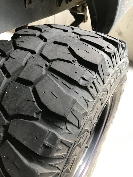

    Those are terrible tires for winter conditions. Big flat tread blocks with no siping are the opposite of what you want to be driving in winter conditions on.

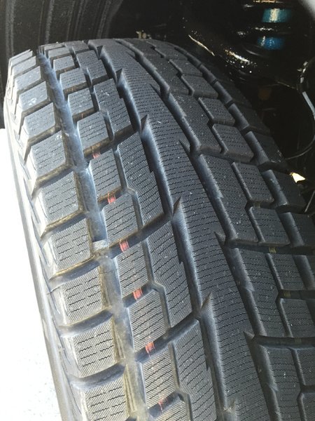

    This is probably the main issue. I run these Yokohama winters for about half the year. Big difference in design between these and mud tires.

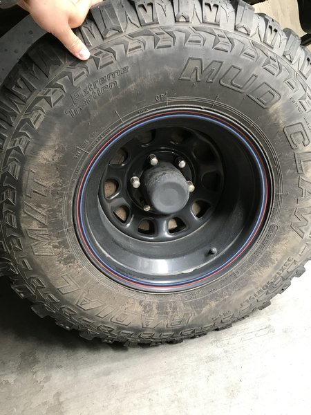

    Tires were one of my first thoughts of cause of problem. I didn't want to go spend the money and it not fix it. These are the ones that came with it when I bought it. If I were to get new ones for this coming winter would it be a good idea to get ones not as wide as these 12.5's

    Yea, skinny is better for on road driving anyway.

    Those tires will be terrible in ice and snow. Go with something narrower and look into dedicated winter tires if you will be driving in the snow and ice a lot. The problem with those tires is that they have no siping and very large tread blocks, which is gonna suck in the ice especially.

    You have cheap mud tires on that have reached or passed their wear indicators. Those have stepped lugs. From what i can see most of the tread pattern has reached the bottom step, which is also the hardest rubber. New they would do badly. Worn they will do very badly. You're essentially trying to compete in track wearing a pair of flip flops with a broken strap.
    Some m/t will work better than others.
    For cost I ran treadwright guarddogs on my toy, replacing the a/t it came with. I don't remember the brand but they weren't suited for the offroading and weather i went out in. They worked really well in deep snow. It crawled up icy hills we had to turn around and winch others up. Definitely some hum on the highway though.

    Mud tires are horrible in snow; they don't have traction for nothing; however if you took it to a shop that can sipe the tires; you may gain a bit more traction. What your experiencing with driving in snow is normal, especially with a tire that doesn't grab well. In fact Mud tires suck in the rain too.

    Yup, contrary to what all the kids write on the interwebs, mud tires are the worst tires for winter driving and yours are bald making it even worse. A good set of all terrains like ko2s or duratracs will be ten times better (I prefer ko2s especially on slick rodes), and true snow tires even better yet but then you need summer tires as well. Also keep in mind that a 1st gen tacoma is a light vehicle compared to most other trucks, which is goin to increase sliding.
