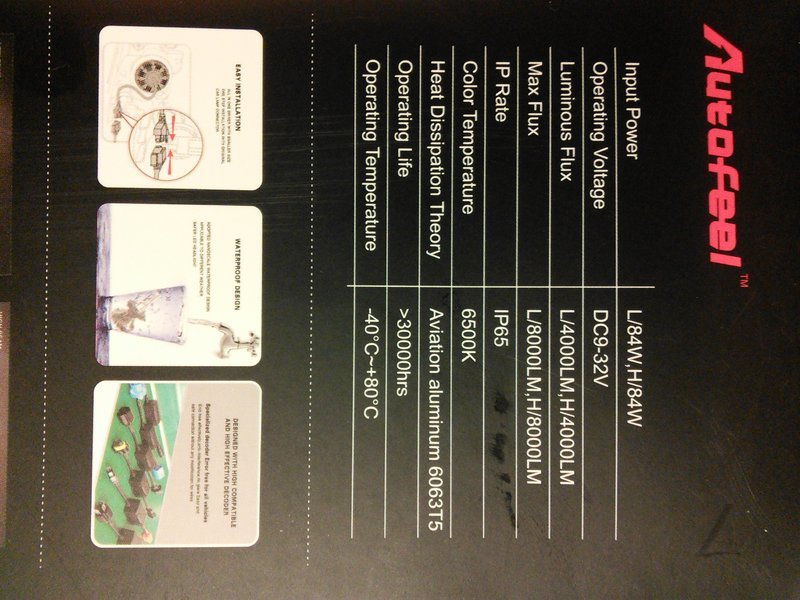

    Hello everyone.
    I started up grading my truck lighting. I put a 50" 678 watt LED light bar on the roof and a 32" 485 watt LED light bar in the front lower bumper.. lover the look. Then I didn't like the headlights to yellow and dim. So I bought new 165 watt LED headlights. They work great but now when I turn on the headlights my radio dosent want to work. It's like the signal is lost and it's just static. But turn off the lights and the station comes right back. Didn't do this before I replaced the headlights even with the light bars the radio was fine. But now with the new headlights I get no radio only when lights are on.
    How do I fix this problem. Here is a pic of the lights I bought. IMG_20170118_222322.jpg IMG_20170118_222339.jpg

    LED sometimes have no shielding on their PWM (Pulse Width Modulation) circuits and interfere with radio waves.

    Put a ferrite choke on the headlight wiring - they used to sell them at Radio Shack, might still. They snap over the wire and "absorb" the RFI

    try a ferrite choke like TaterHarry said, no guarantee but its not ur alternator, its a known issue with adding LED bulbs. inexpensive generic bulbs emits too much electromagnetic interference on the same band with your radio because they were designed for the purpose of lowest cost, and did not consider Electromagnetic Interference mitigation. I would go with some name brand bulbs if the choke doesn't do it. I'm not expert, I just did a little bit of googlefu.

    thank you everyone for the replies it has been helpful.. I tried the ferrite and it seemed to help a little not to much but it did help. my brother suggested that i try running a ground wire from the cooling fins to the body.. i'm hopping that does the trick.. if not going to go with HID lights.
