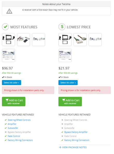

    If you just hooked up the system like a basic deck you will lose the JBL sub. Go to Crutchfield.com, plug in your truck, choose any stereo deck and then click on "See the installation gear you'll need." Doing the basic install does not retain the sub.

    I did the aftermarket harness as well as the steering controls. When a song comes on, you can here a very subtle sound coming out of the subwoofer, but it's not bass. It sounds more as if the sub has been blown, which I know it isn't because it was working just hours before.
