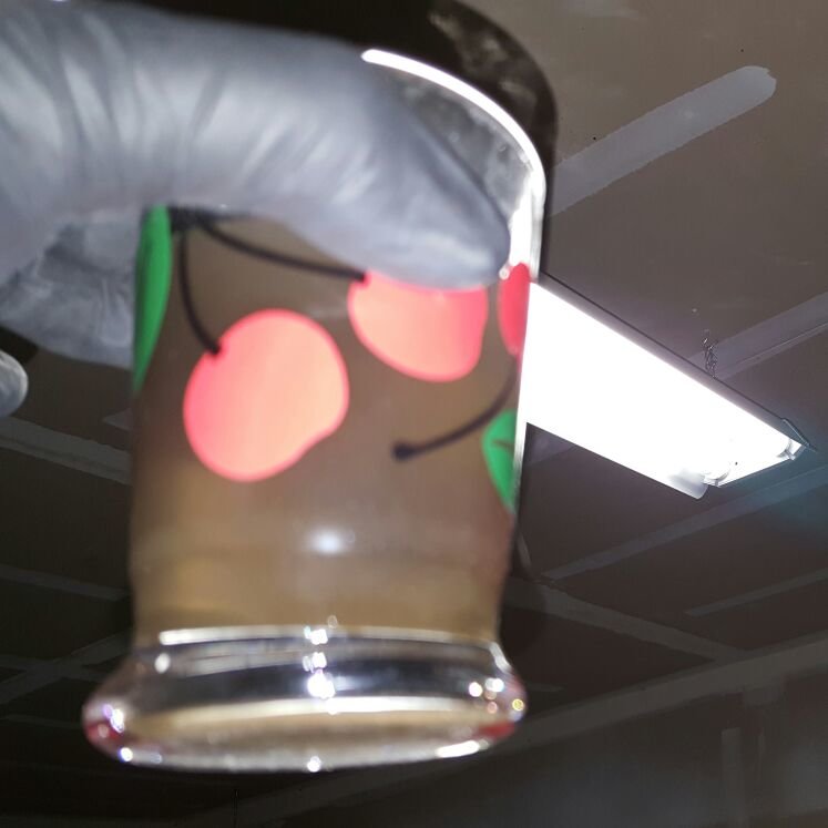

    Fuel filter is saturated. Promise. Need to do the fuel pump upgrade from URD, so that you can change out the fuel filter.
    There may also be other issues, but that is certainly one.

    Came outta my fuel filter.

    Nothing like a picture to nail down the message.

    looks like a chocolate shake...;)

    Nesquick :hungry:
