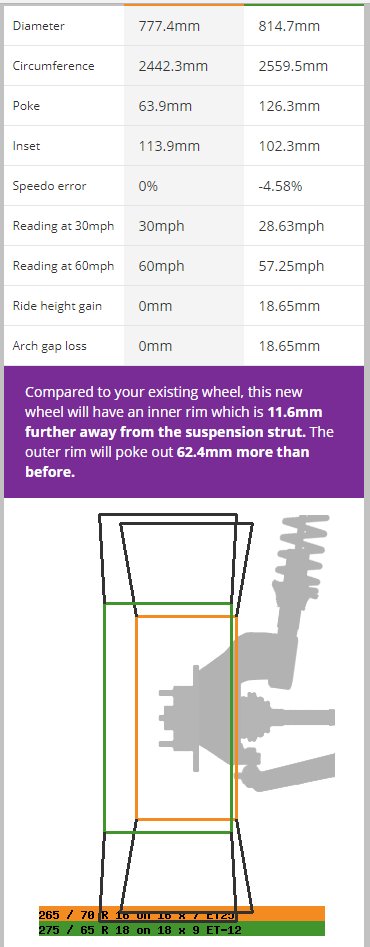

    Your new wheels will sit out 62.4mm (~2.5") more than the stock wheels. Take a tape measure or ruler and measure out to see where your wheels will sit.
    ^ Great resource to check this kinda stuff :thumbsup:
    OP, your wheels will fit very similarly to this ^

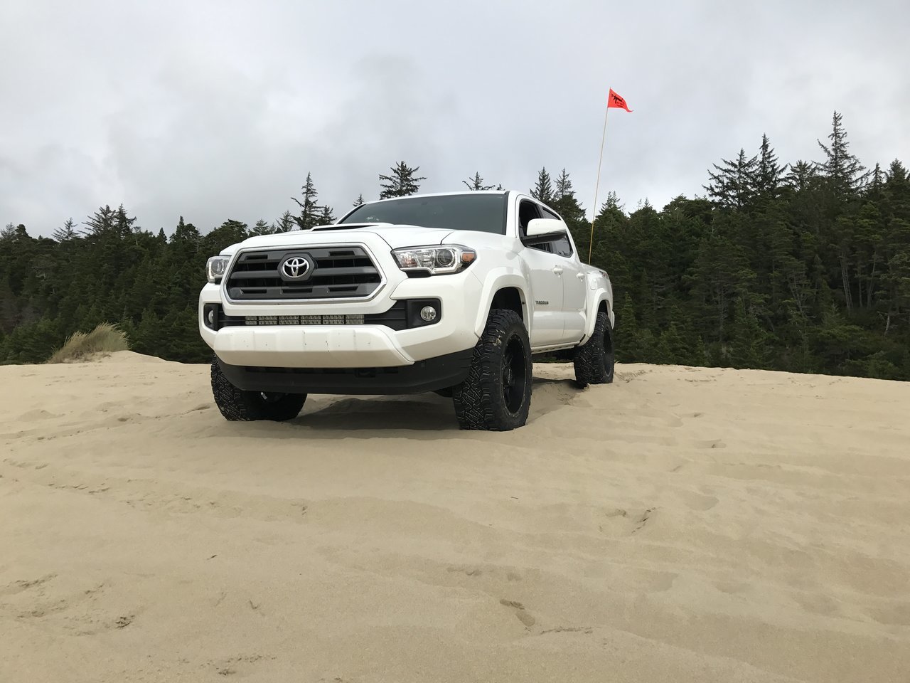

    I have 275/65/18 with -12 offset. I'd take a better picture but truck is being held per recall. If I get it back soon I can take a better shot. Hope this helps
    Fyi I was afraid of to much poke but in my opinion it's just enough IMG_0912.jpg
