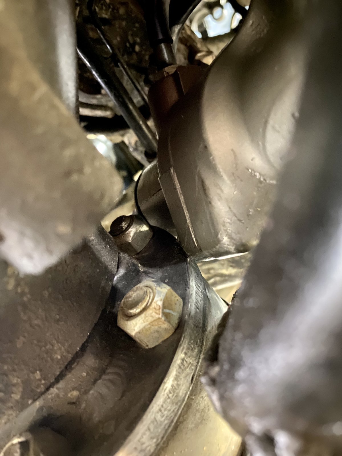

    When the modified tundra steering rack was installed years ago, the 934 CV axles were rubbing on the rack. It eventually went away. However, after removing the steering rack to reseal it, I ended up making contact again. Ricardo helped me out with a solution by adding spacers between the bung and the rack. All gravy now.

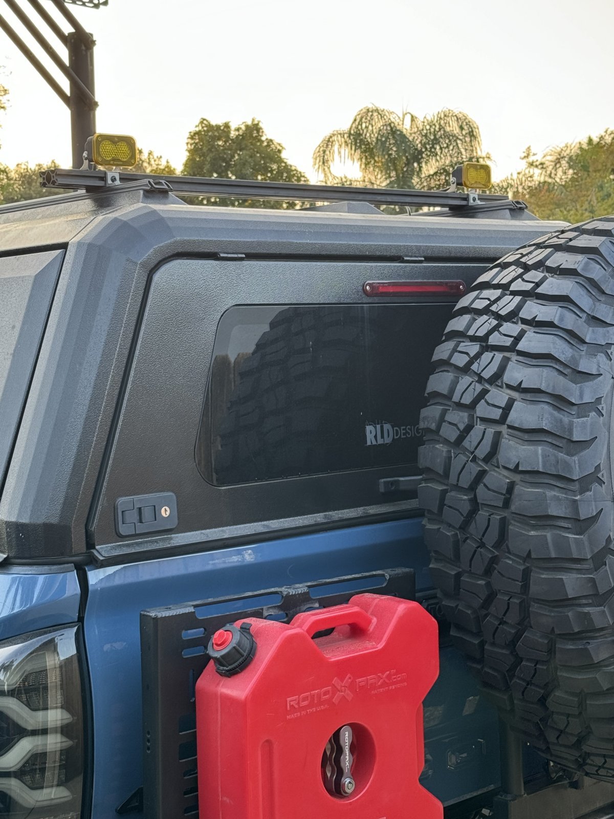

    Mounted the Baja Designs chase lights on a Prinsu bar mounted on top of the RLD topper.

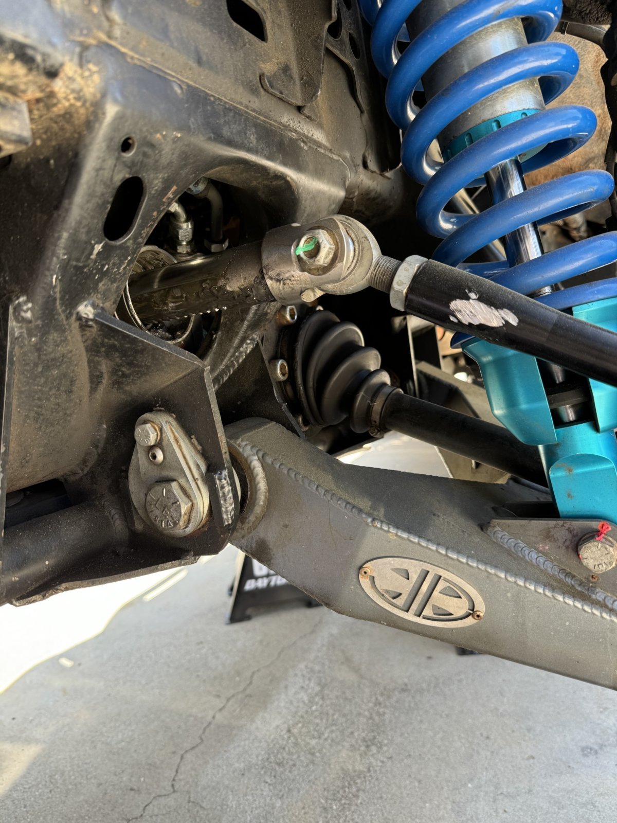

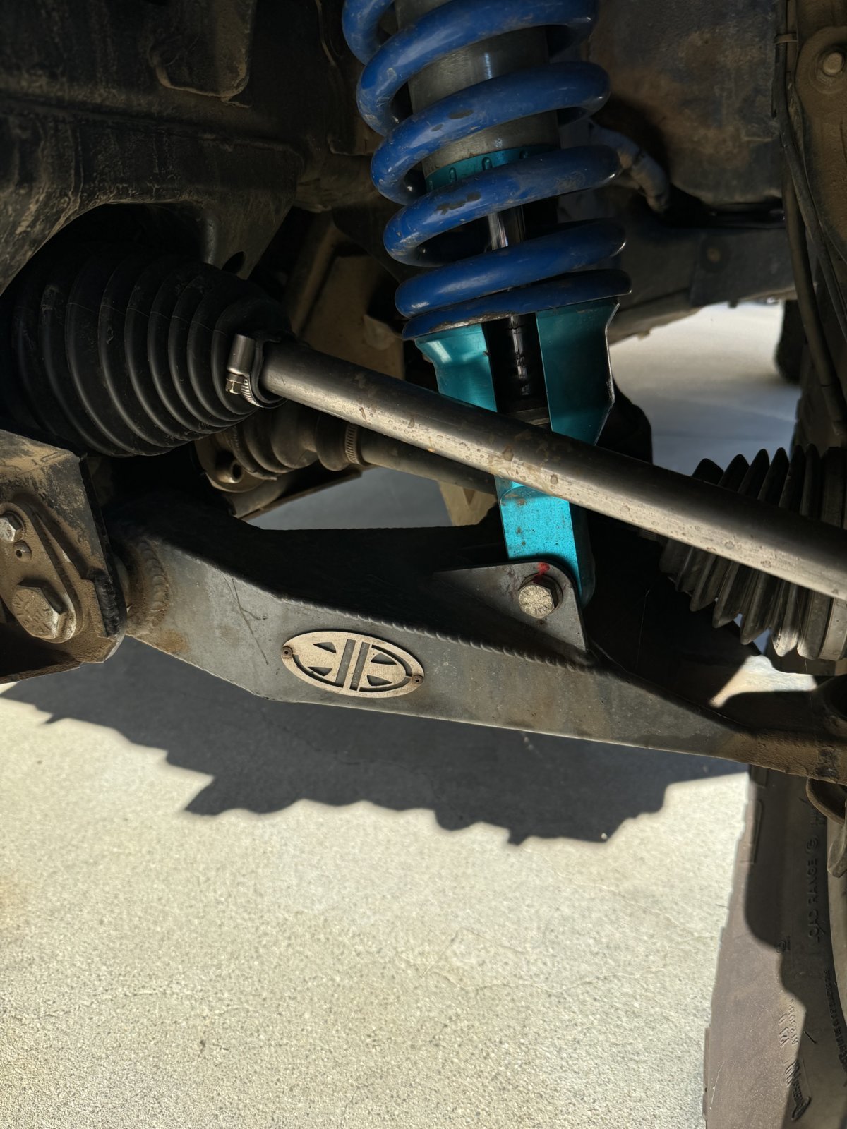

    Put chromoly tie rods on and put on proper clamps on the boots. Very minimal rubbing now on full lock. The new chromoly rods are thinner by the jam nut part compared to JD fab’s billet tie rod which causes all the rubbing on the shocks. Not done though, gonna add custom shock towers to make more room and clearance. Anywho, here’s how it looks.

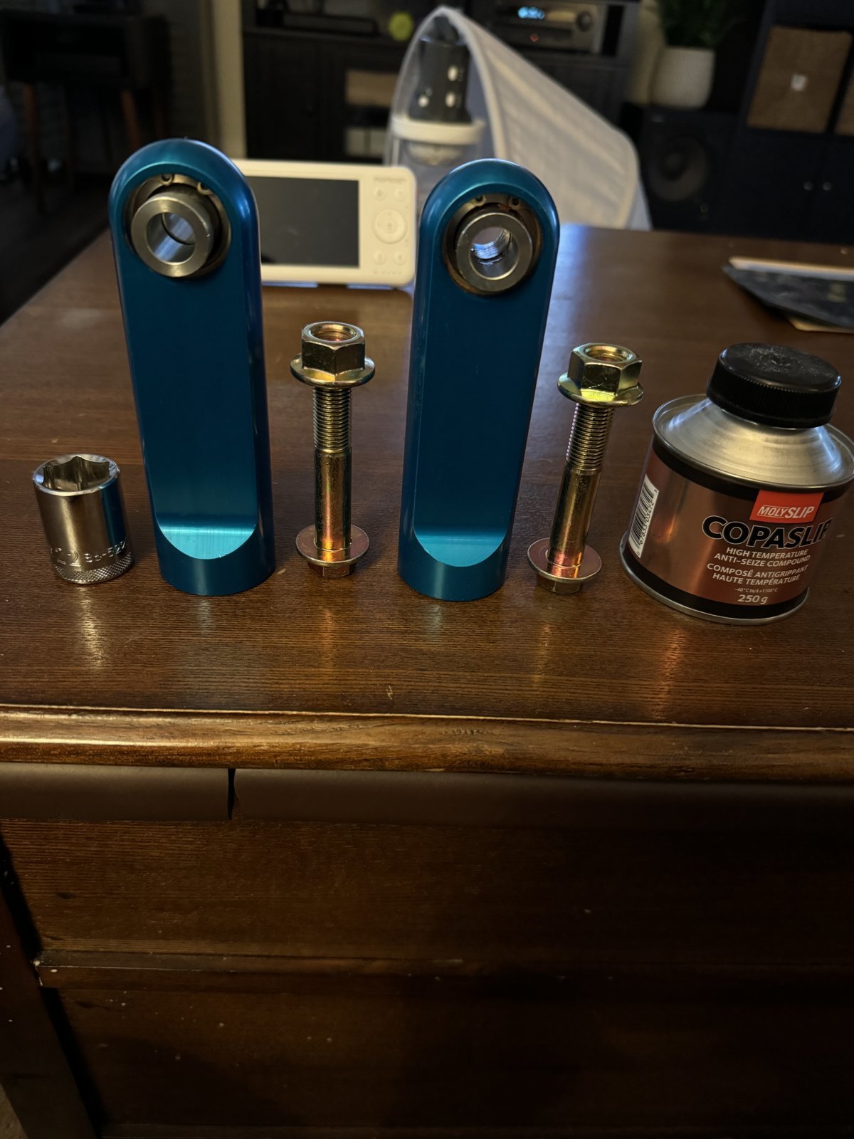

    Put new spherical bearings on the longer shock rod ends. Also added a new straight bolt to go with the lower shock mount. Notice how it’s not tapered. It’s straight and also won’t rust. That should prevent caked up dirt/mud/gunk from getting in which causes most King Shock bearings to clap out.

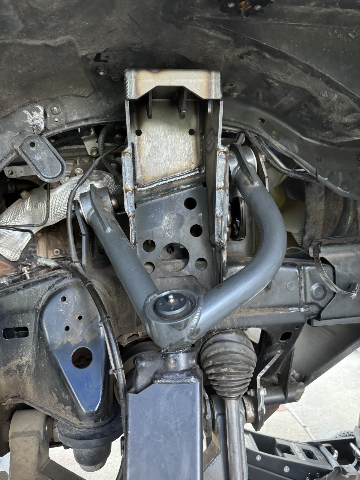

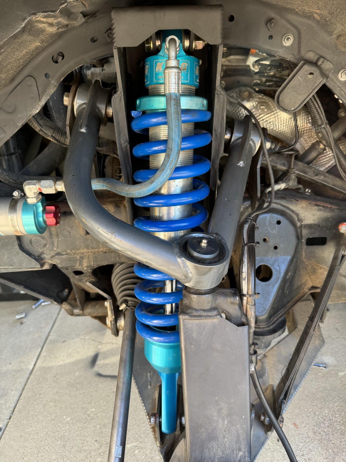

    @Ricardo13x going ham on these JD fab shock towers. This new shock tower is not only beefier but it moves up the shocks 2 inches up. All you do is add the longer rod ends (by 2 inches) and good to go!

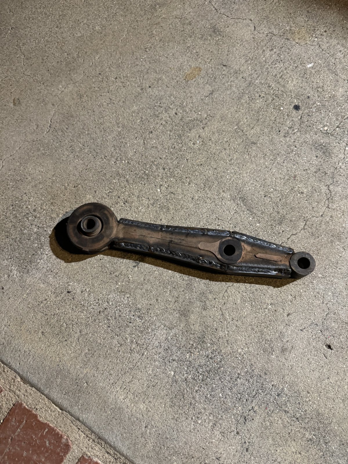

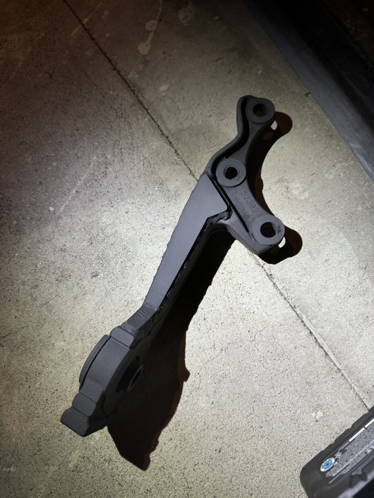

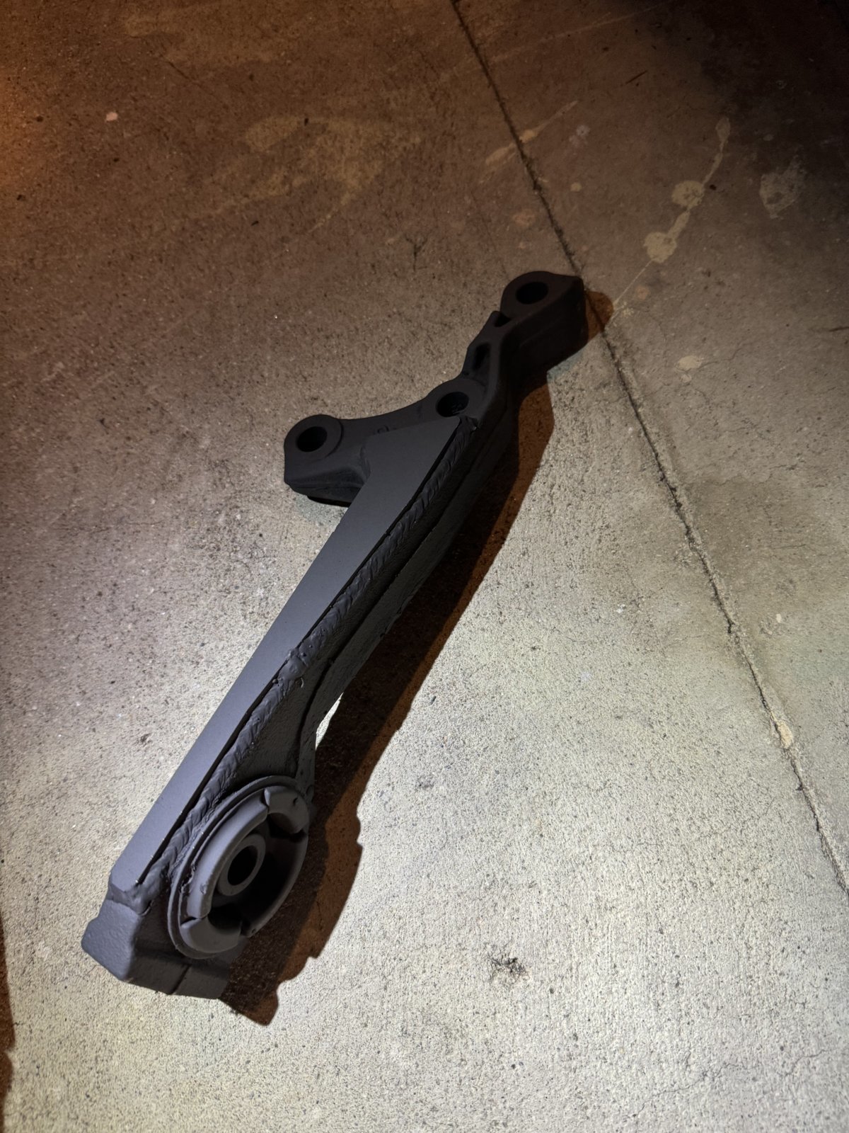

    Finished the night off with a bang on these thick 1/4” diff arm gussets from Coastal Offroad. Having the welds taco front diff reinforcement and the JD fab 934 CV’s mean the next to grenade are the diff arms or the ADD axle tube (I just carry a spare). So now only one weak point when locked in the front!
