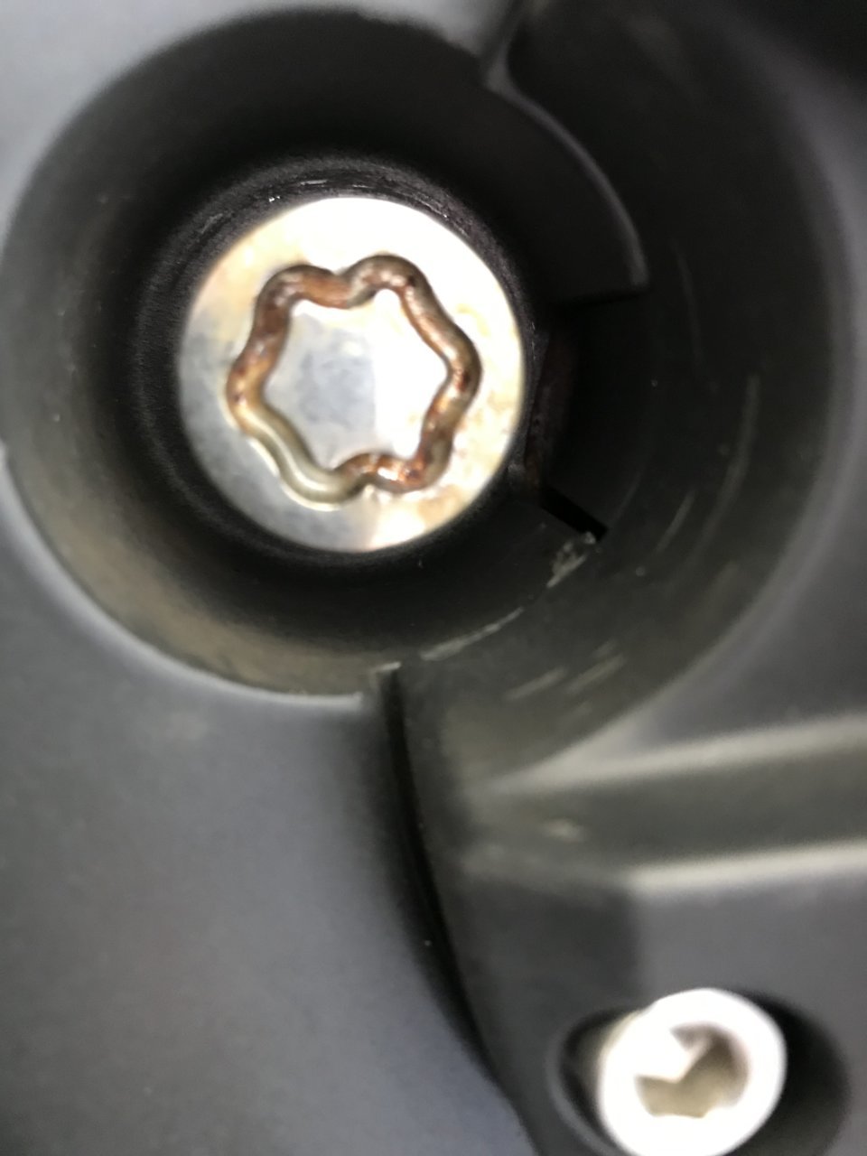

    got new wheels put on my truck a couple months ago at a tire shop, went to get my tires rotated only to find that my lug key was not in my glove box! Any ideas? Anyone know the brand or part #?

    Check the cubby with the jack and if it's not there call the shop. They should have one and if not they probably have the key to remove. At least you figured it out now instead of at night on the side of a snowy highway.
    If you want to try and remove yourself you can probably get it with an air chisel but it may cause some cosmetic damage to the wheel. Another option is to try and pound a socket onto it then use a ratchet.

    Hammering a slightly too small 12 pt deep socket works pretty well. Or tack weld one on if you have access.

    If you go to the dealership they can give you a key number (using their master key set) and you can then call Gard and order a replacement.
    The tire shop should be paying for it though.

    Maybe a gator grip socket and pound that on. Never tried it but it's been suggested before

    Use an impact socket. They don't go to pieces the way a mild steel 12 point will.

    If they were original equipment there ought to be a card in the owner packet with the McGard part number on it. Go to their website and they will send you one. Also they can usually identify the key if you send them a high res photo of the pattern.

    Most wheel locks come with a unique code used for a replacement, which is long gone for sure. Other guy above was right about them being more harm than good. Mistakes happen, and it's bound to happen again even if you get a new one. Most guys at my shop can remove a set of wheel locks in under 5 minutes with a sledge and wheel lock removal socket. They have specialty sockets for it with a spiral inside. What shop did you take it to?
    This is the socket:[​IMG]

    Check with a few local tire shops. Some keep keys (usually from when people have new lug nuts installed) for when customers dont have them.
