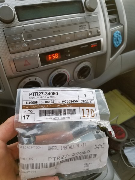

    These are keys for the baja on Amazon finally came in the mail
    Puzzel key
    McGard 25257 Chrome Tuner Style Cone Seat Wheel Locks (M12 x 1.5 Thread Size) - Set of 4Box
    Spline-drive lock
    Genuine Toyota PTR27-34060 TRD Lug Nuts

    Can this key unlock your existing lock nuts? I would think that it has a different pattern.
  13. May 4, 2017 at 5:48 AM
    #33
    bajaruda
    bajaruda [OP] Well-Known Member
    Mar 15, 2017
    #213427
    74
    East Coast
    2013 TX Baja Barcelona Red
    Yes they work

    BTW, those aren't really 'locks' or locking lugs that are shown above.
    It's just a specialty socket that fits in the recessed holes to allow removal of the nut. Any thin wall deep socket of the proper size should fit, you'll just need an extension, ratchet or breaker bar to use it, as the OE 'lug wrench' won't attach to the socket.
