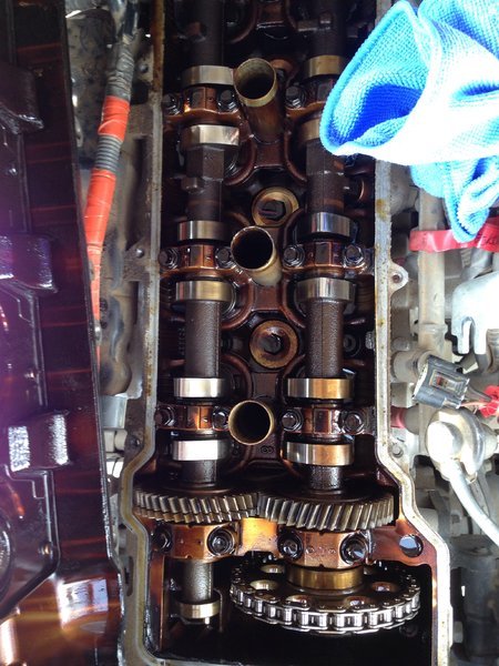

    My 2002 Prerunner started losing oil pressure and started making a rattling sound. The noise got louder. Per a mechanics request, I removed the valve cover and was told I would see something out of place. Herein lies my problem, I am not a mechanic therefore do not know what it should look like under there...please help me!

    If you take some pics and post them, someone here will be able to tell you what you are asking for.

    Definitely post pics

    Here's a pic

    Is that a pic of under the valve cover ?:lalala:
  11. Jan 3, 2017 at 4:17 PM
    chaosrob
    chaosrob Well-Known Member
    Nov 11, 2016
    #202140
    329
    Looks like a pic under a cam cover to me :dunno: :)

    Like a said, "I am not a mechanic and what little I know, I've learned on my own." So like one comment that was made, it might be a pic of under the cam cover! I looked to all you geniuses that may have a little or a lot more knowledge of these damn little trucks than I do! I've have been trying to research my problem to no avail. All I know is that the oil pressure light came on, it ran great to my destination and did not lose any oil at all. After having dinner, I came out, started it and heard a faint rattling noise. The noise grew louder, I got on the highway and it didn't really want to shift into 4th; it is an automatic. It did though, but shortly thereafter I started to lose power. So I decided to pull over instead of risking blowing my engine up. Nobody can seem to tell me what is wrong or what exactly may be causing the noise. It is still premature in my investigation. So like I said before, if any of you holier than thou "geniuses" have any helpful ideas of what it may be, I would love to hear your insight! but other than that please refrain.

    Could be many things, Clogged oil pick-up screen, failed oil pump, blown crank bearing, etc. Need more data. Where is the noise exactly? Lower engine, upper? Right side, left? Harmonic balancer wigglin all over?

    You posted a picture of a head with the cam cover off, nothing else, no explanation and now you are posting my response as being a negative one? Not sure about where you are coming from. You're going to want to start with draining the oil and looking at it closely. If you lost oil pressure to the point where you were driving and losing power chances are there is already some real damage done

    Ok, if this is the way you want to approch this then, here we go.
    I'm the one who suggested postign a pic.
    Lets start at the simple.
    1) Does your oil smell burnt?
    2) Replace your oil filter and cut the top off it. (The end with the holes in it)
    3) Cut the filter at the top and bottom once you have removed it from the metal shell
    4) Open up the pleats and inspect with a light. (I like to spread it out on a white background, papertowels or soon to be dead to me tee shirt). IS there any chunks of metal in there?
    5) Go over the spread pleats with a magnet. How much is picked up with the magnet?
    6) Take pics and post on here or back on your original thread with the picture under your cam cover
    7) Request advise and it will come...
