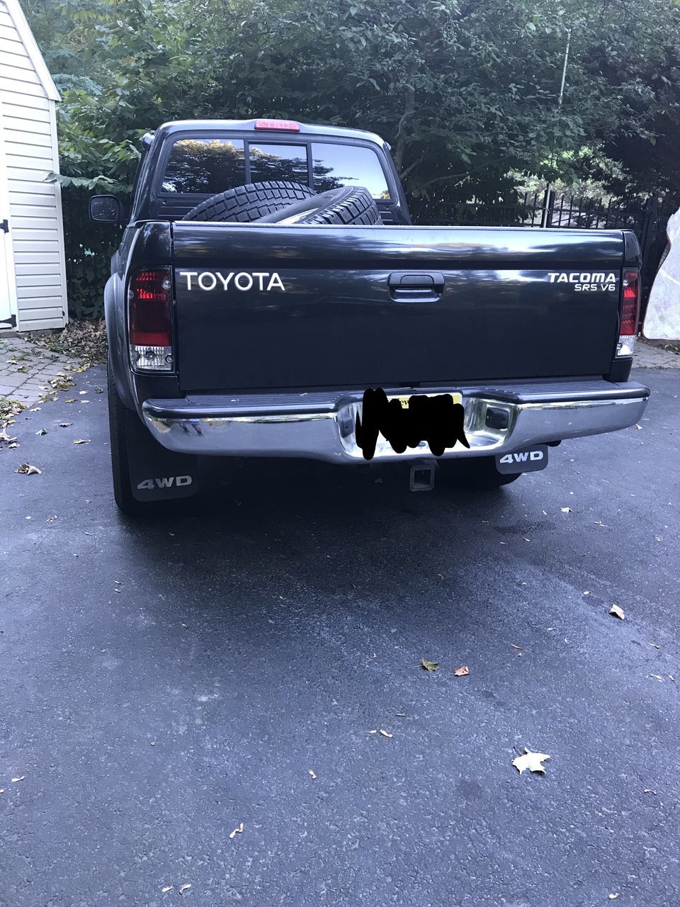

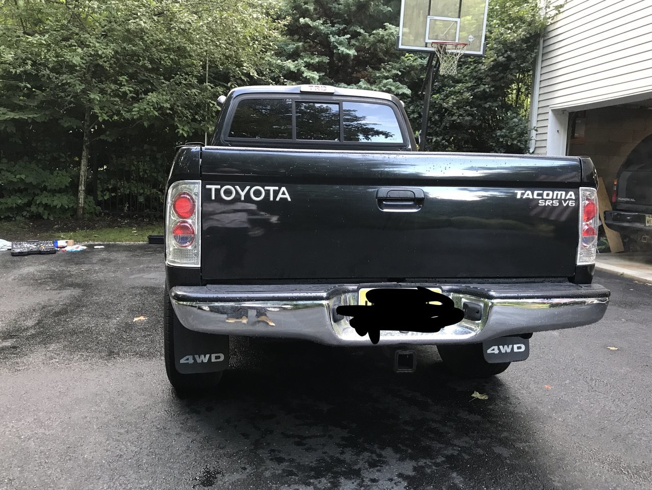

    This is my first actual post so I will do my best to provide a good description and pictures. So, I have a 2002 tacoma ext cab v6 manual that came with stupid looking after market tail lights. I wanted to switch them out right away and was going to go back to stock ones but
    Sicyota04 Had a set up LED spyder ones I liked. He gave a sweet deal (which was much appreciated) and I got them. I plugged them in and they did not work correctly. Here is what my observations were.
    If i have the tail lights in that came with the truck they work fine.
    If i plug in both new LED tail light on the driver side only then everything works fine.
    As soon as I plug in the passenger side LED tail light and have my head lights on and my blinkers the driver side tail light blinker is dim and the LED tail light part (which is always supposed to be one when the head lights are on) blinks. At this point the passenger side tail light part is no longer on at all.
    If only plug in the passenger side LED tail light it screws up the tail light that came with the truck.
    Those are my observations and I am at a lost I have tried switching the LED's to make sure the bulbs are all good and they both work fine so its definitely my wiring or something. After messing with all this I have also noticed that right after putting everything back together, I was driving and had my blinker on, and when I stepped on my brake I lost my blinker and it would blink super fast on my dash. That went away but thought I would mention it.
    (the first picture is my old tail lights, the second picture is my new ones.)
