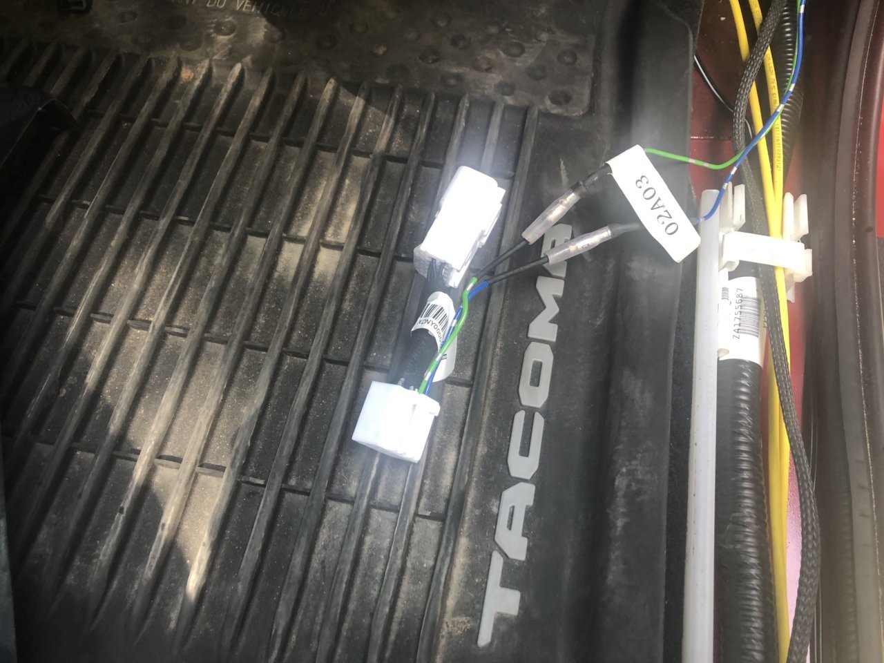

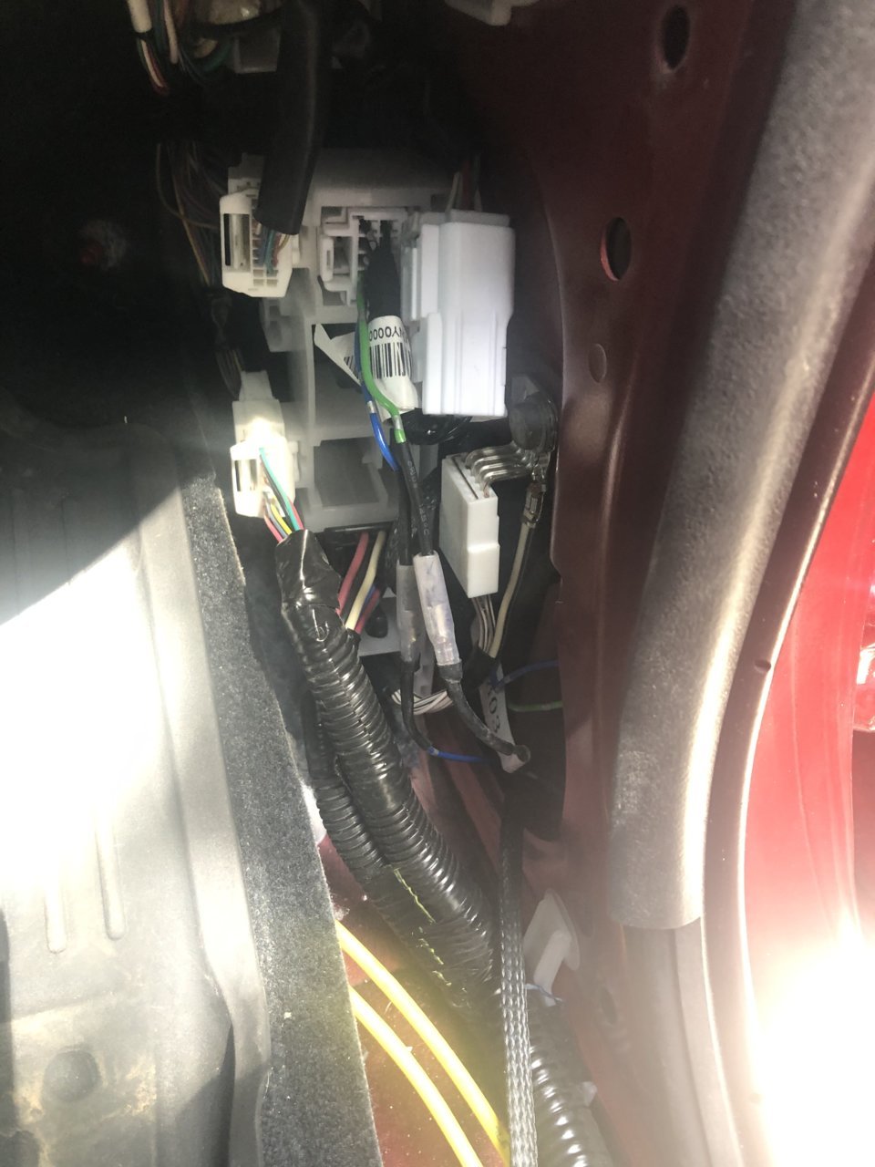

    Well finally got around to finishing up the KTJO tailgate lock setup, this will now allow me to hook up the lock on the rear window of the shell.

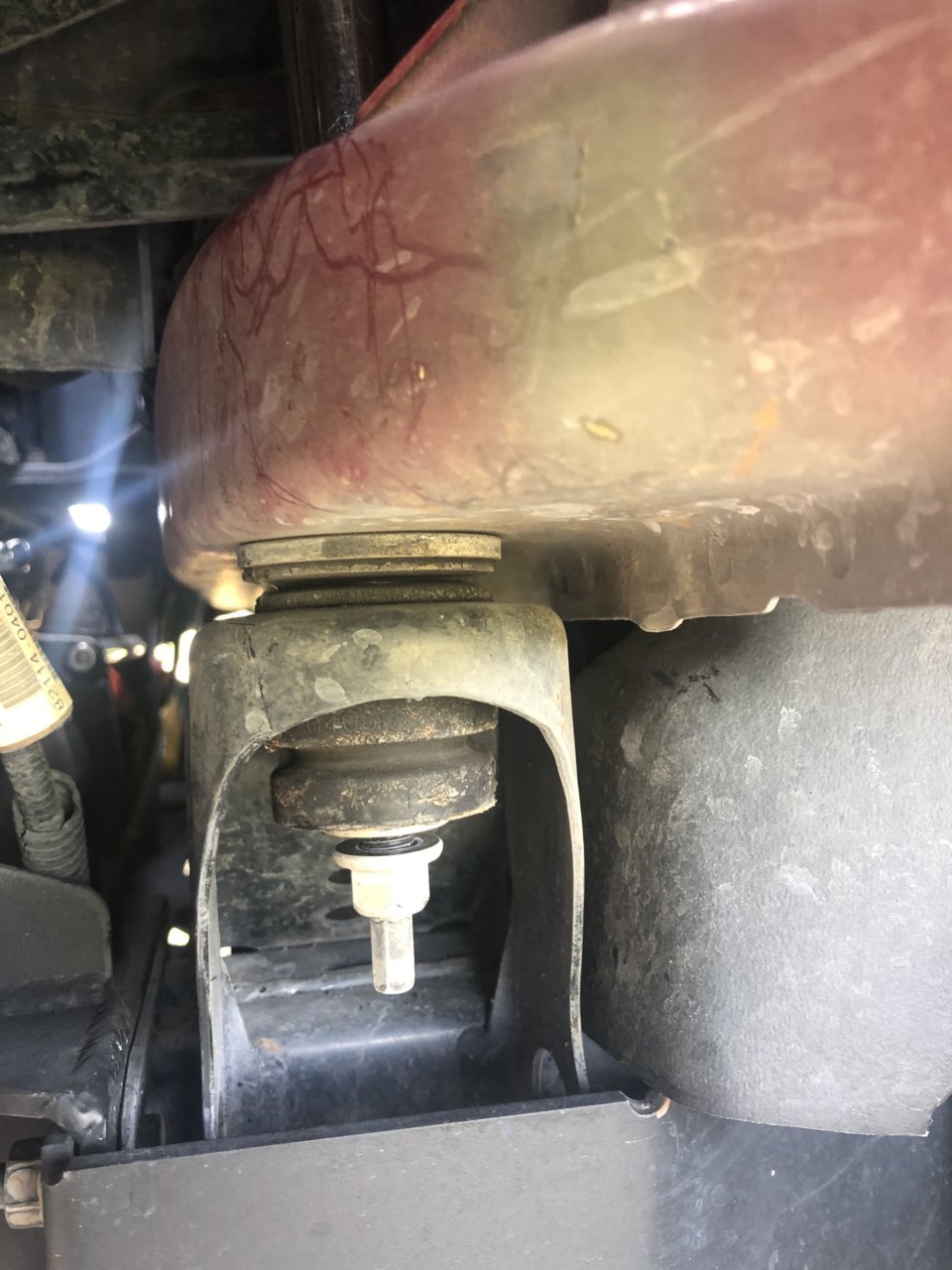

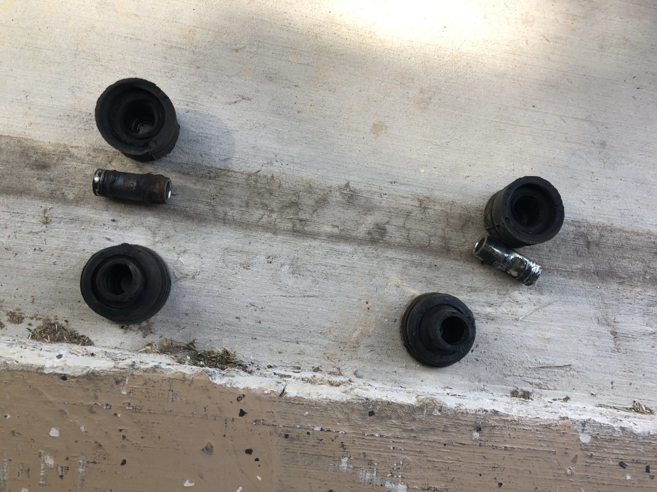

    Well been hearing some noises from the front end, figured I would work the radiator bushing swap first using energy part number 9.4101G as I this seems to be a norm for a bunch in the 2nd gens and it was straight forward and only took me about 20 min to complete. You can see the old ones then the new ones, it was recommended to use the big on top but in doing so it made the gap between my bumper and the body too much so swapped them around. Old ones you can see are pretty warn out.

    Ya it is, will tie it to my camper wiring thread that I made...maybe someone can use it as when I was looking originally there was not much info for this shell.
