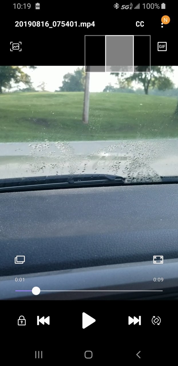

  18. Aug 16, 2019 at 7:20 AM
    #58
    nickrick78
    nickrick78 Well-Known Member
    Feb 25, 2019
    #284492
    392
    Nick
    Pittsburgh PA
    Tacoless for now
    Found this today for the second time since purchasing my 2019. Once was after snow was covering the truck overnight, this time no snow, just some rain yesterday.
