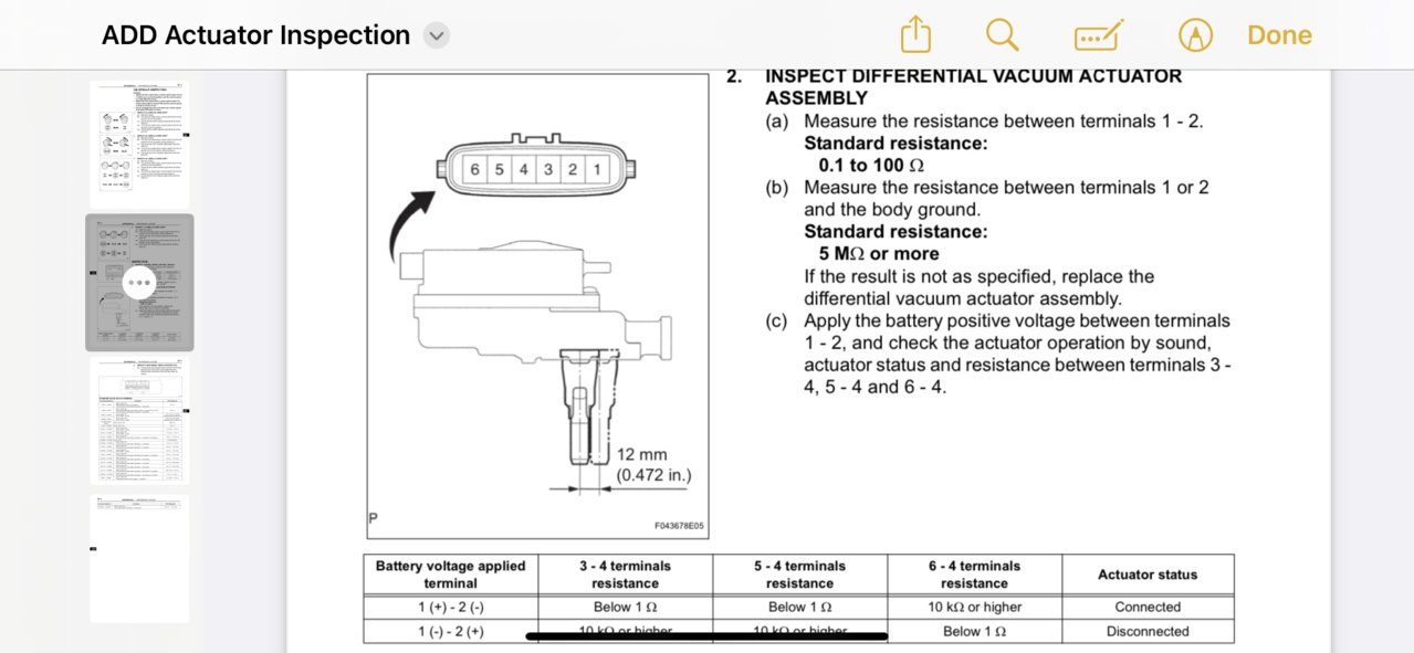

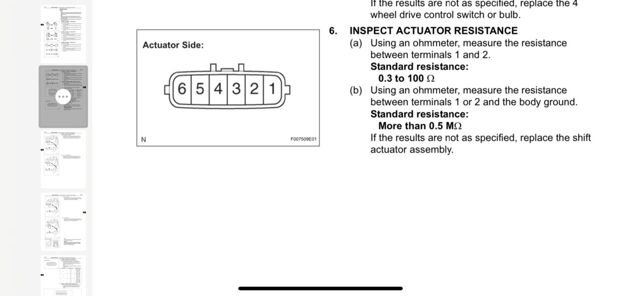

    Hey! I recently purchased a 2013 Tacoma TRD with a ton of problems. Items I need help on
    1. SOLVED - 4wd has been out for 3years… Yikes. ‘4-low’ light is flashing constantly on the dash while driving. The thing is stuck in 2wd. Previous owner replaced the actuator in the differential but only cleaned the transfer case actuator before giving up (*I plan to buy a new transfer case actuator on RockAuto ASAP*) thoughts or common known fixes? *Note someone has modified wiring to add a switch to turn off traction control/vcs… does this sound like an issue?
    2. SOLVED - CV’s need rebuild. Boots are torn open, not sure if axles are OEM. The thing is lifted (Bilsten 5010’s up front with a puck spacer on top.. thoughts?) but came w a diff. Drop kit I plan to install. *I think I’ll buy CVJ inner boots and Toyota outer boots to rebuild. Thoughts? Will replace axle seals at the diff.
    (Bought a local set of TRD branded 5100's and replaced the shocks all around. Set my ICON RTX pack to setting 2. I have a little over 2" lift all around now. rebuilt one side with a Toyota kit and did the other with an Orileys for the lifetime warranty. I had needle-bearing issues too in the end... doing the bushing soon..)
    3. SOLVED - 4wd fluids. Opinions for front diff./transfer case Fluid replacement fluids? If there’s legit concern using non OEM fluid I’m OK doing Toyota fluid. I went for the Orileys 'MasterPro' synthetic stuff per the recommendation of the Dealership here in town lol. Make sure you get new Toyota crush washers!
    if you had specific threads in mind please feel free to link!
    I appreciate you guys!

    Dm93, I'll get that limit switch voltage test done this week and post my results! Your thread was super helpful!! Thanks a ton
    Thanks Pittsy for the input! I'll attempt to rebuild the axles and go Autozone if it doesn't work out. Just out of curiosity, what's your reasoning for wanting to remove the puck and not do a diff drop to help the CV's? I like the lifted look and would like to keep it lifted 2-3" when it's all said and done functionally for toying around in Montana. It has Bilstein 5010's in the front under the pucks if it makes a difference to you!

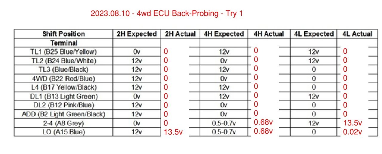

    Dm93, Please see the test results below! Looks like all of Harness A is working as it should but nothing in Harness B is.
    On harness B the ground (B26) doesn't have a wire going to it at all which felt wrong... Any thoughts?!

    That's very interesting, so you have no voltage on any of the limit switch pins?
    Are you sure your ground on your meter was good?
    I've never seen them all at 0 before.

    Me either.
    I haven’t been able to sit down and look at the diagrams.
    I can’t remember all the wires and routing. I have to refresh my memory.
    But I agree. Make sure the ground was good.

    The fact they are all 0v suggests they are all shorted (unlikely I would think) as the 4wd ECU sends out 12v on each limit switch terminal and the limit switches pull them to ground.

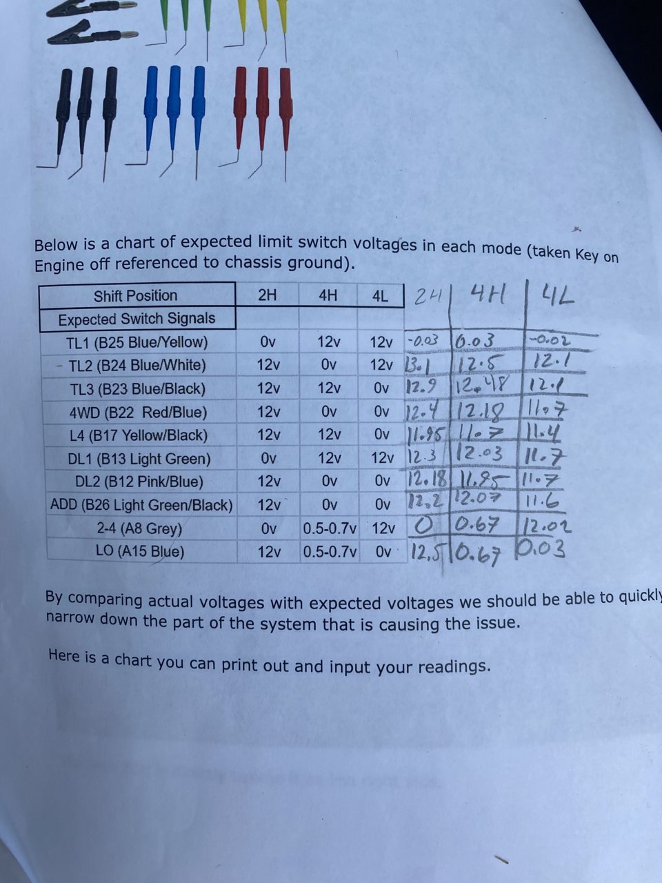

    I redid the test and used A6 as my ground. I was able to come up with much better results.
    let me know what you two think I should go after next!

    Looks like DL1 is the problem, you can ground Pin 6 (Light Green) at the ADD Actuator and retest DL1 at the 4wd ECU. If it goes to 0v your problem is in the ADD Actuator, if not you have an open circuit between the ADD Actuator and the 4wd ECU.
