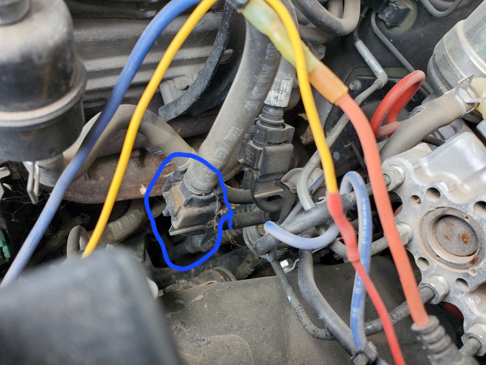

    I am working on getting this truck ready for inspection. Had a faulty purge valve but replaced the solenoid and I can now command open and close the new valve (I couldn’t command the previous valve closed) and this resolved the incorrect purge flow code. I havent performed a fuel pressure test yet, and while watching my fuel trims I do not see a drop while accelerating- my LT trims are reaching 40! Short term are in the norm.

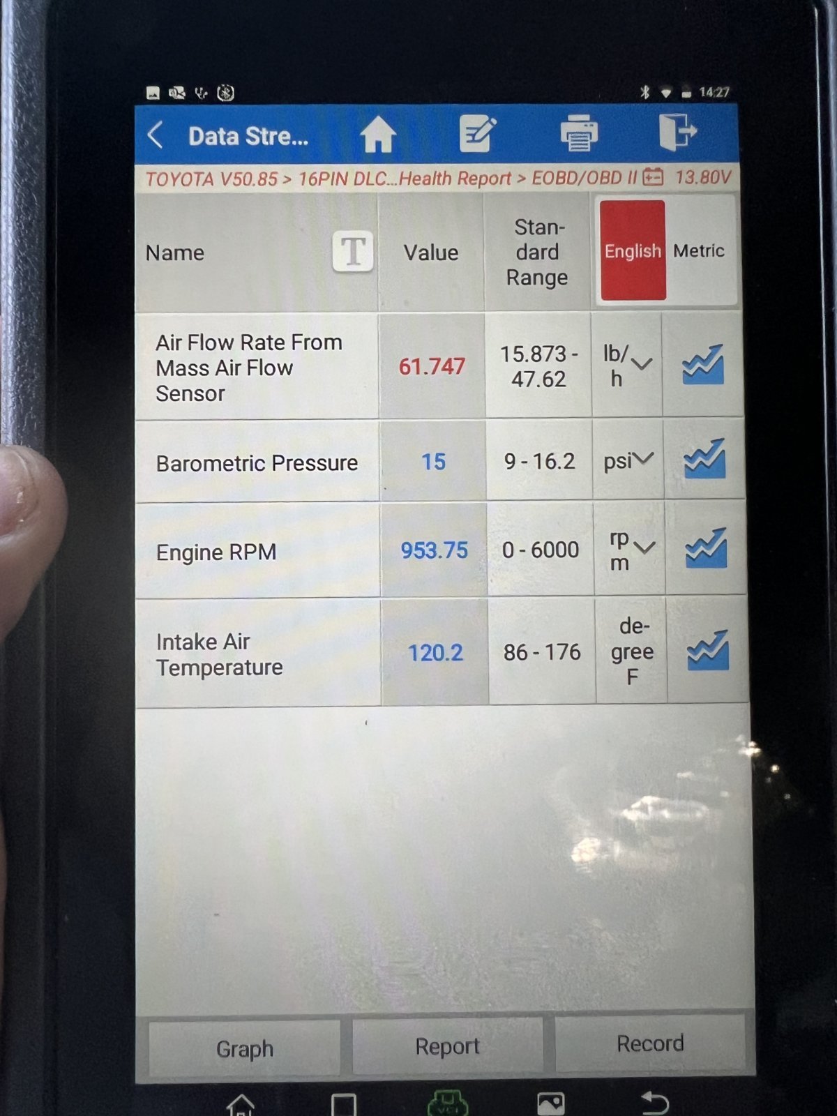

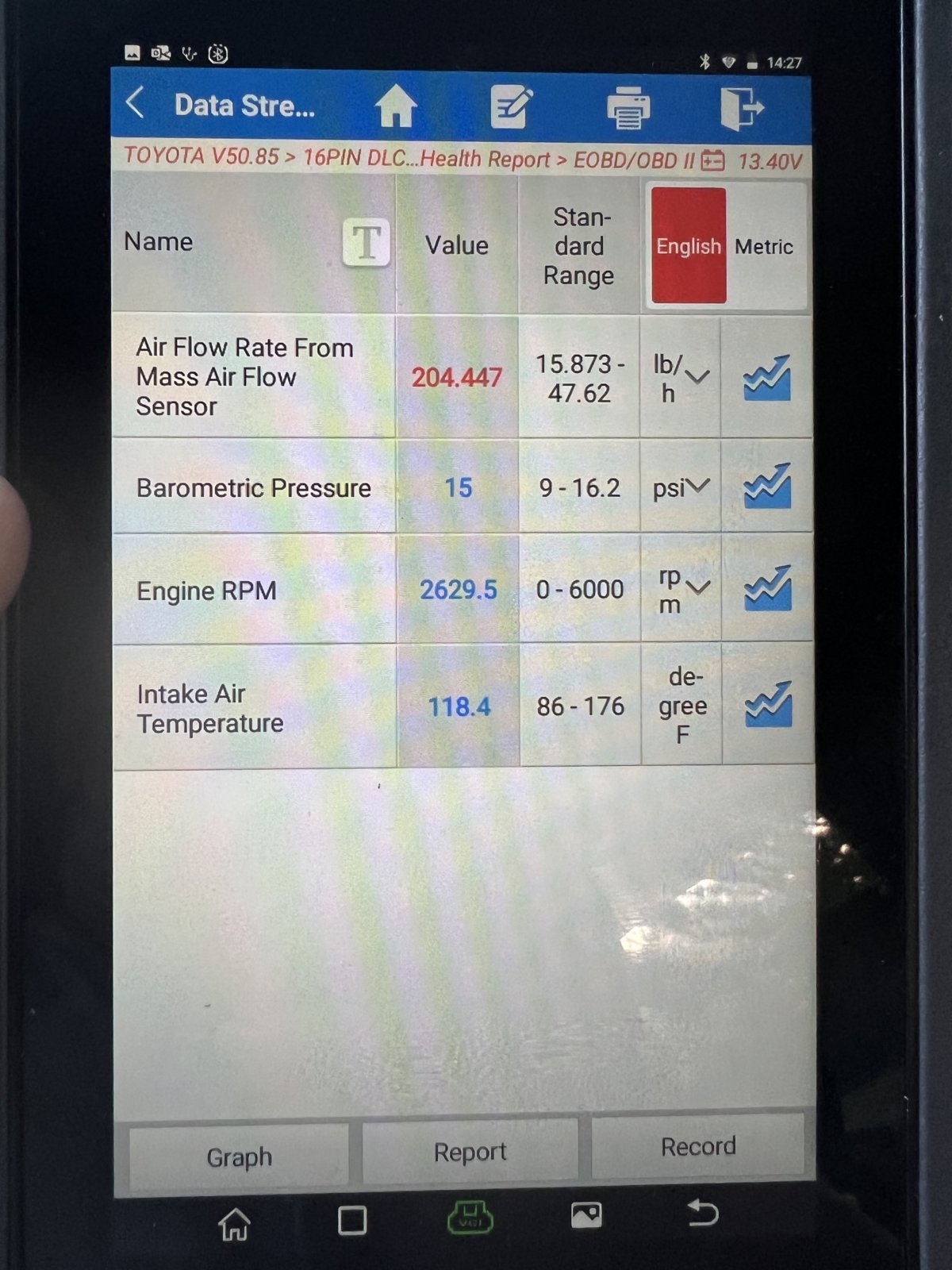

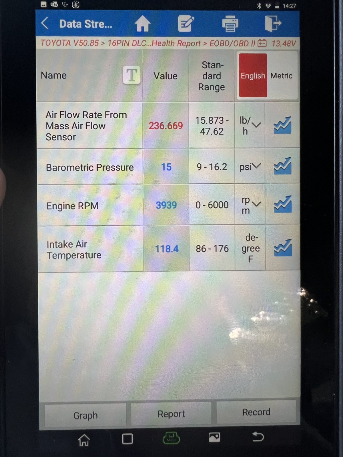

    I wouldn't start replacing anything yet, really need to check fuel pressure both at idle and under load (should be about 41 psi).
    If that checks good then do a VE test to see how the MAF sensor is doing.
    To do a VE test you want to record MAF, RPM, IAT, and BARO. Do a WOT pull through 1st gear, record the peak MAF (you will need to convert it to lb/min or g/sec) and RPM readings, and put those numbers along with the IAT and barometric pressure recorded during the pull into the calculator linked below.
    Typically you want to see 90%+ VE if everything is working properly.
    https://atgtraining.com/atg-volumetric-efficiency-calculator/

    thanks I ran that test earlier and ran to advanced auto and an grabbed an OEM Denso MAF and ran the test again with much better numbers. The pic is the first. Im going to check fuel pressure tomorrow am im also going to inspect the throttle Body as those numbers ate still off. I am not sure if absolute throttle position B at idle being almost 50% at idle is a problem or not but im guessing it is. I dont have any sensor codes for the TB.

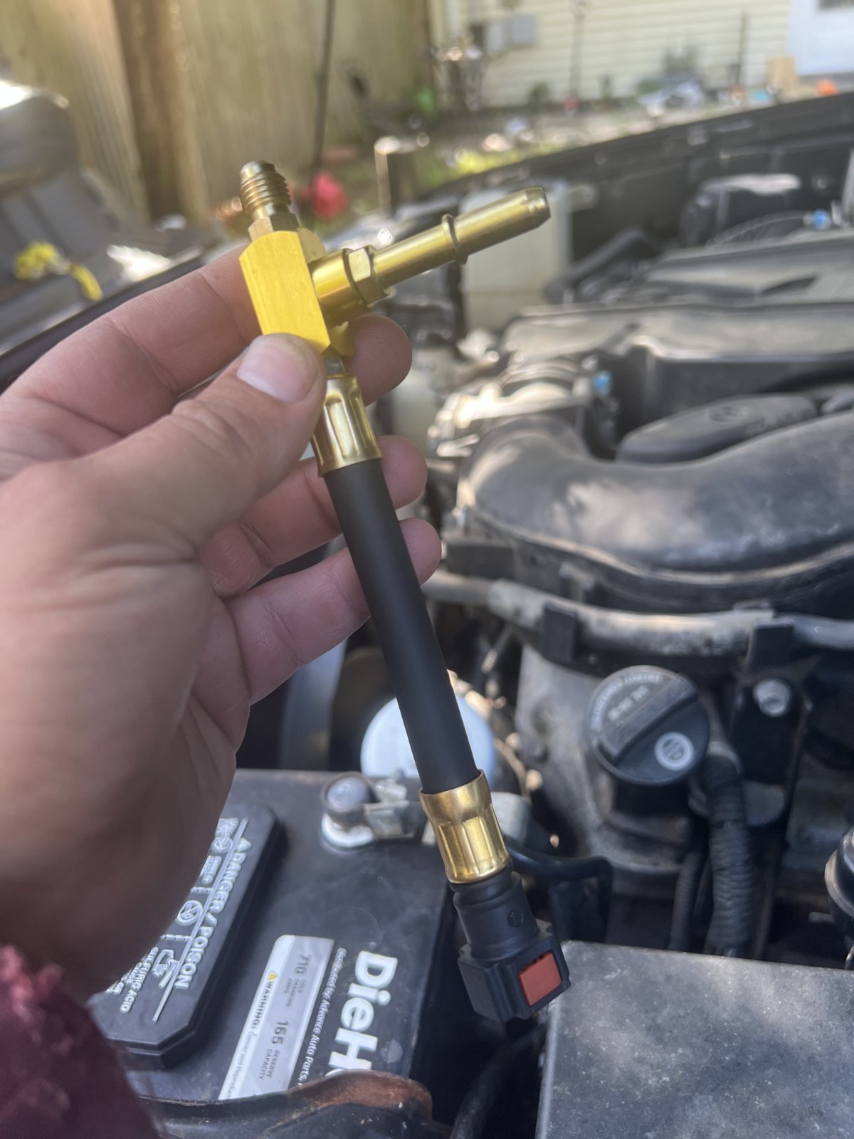

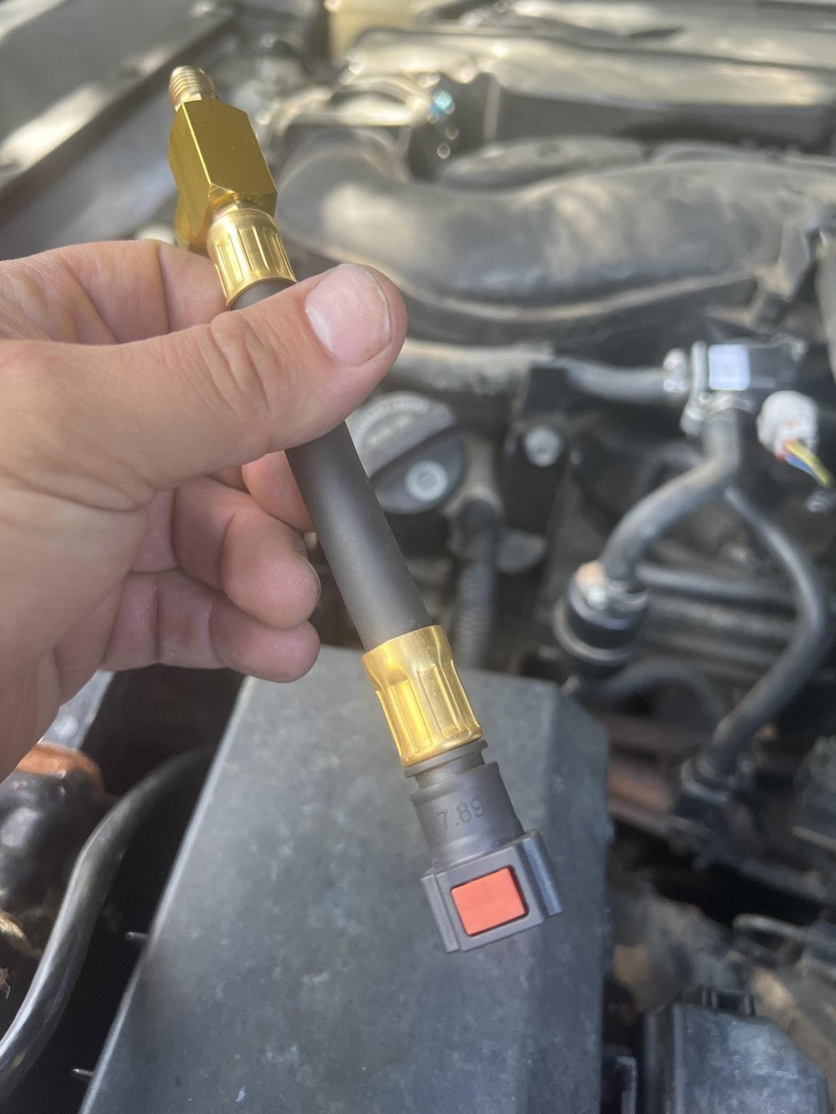

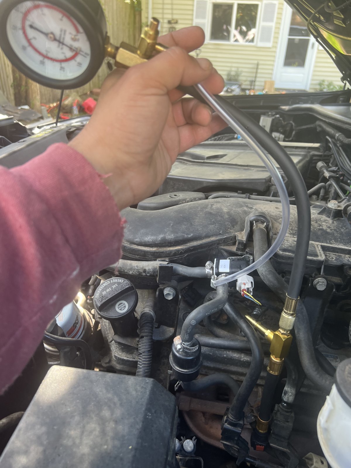

    I tried to perform the fuel pressure test, but the kits quick connects look like theres a lip missing, unlike the feed line on the truck which has two lips and secures the connection pretty tightly. When using the kit, you can easily separate the quick connection female connection w the tabs from the male end that has only one lip. Is that sufficient enough to be pressurized and not allow any leaking?

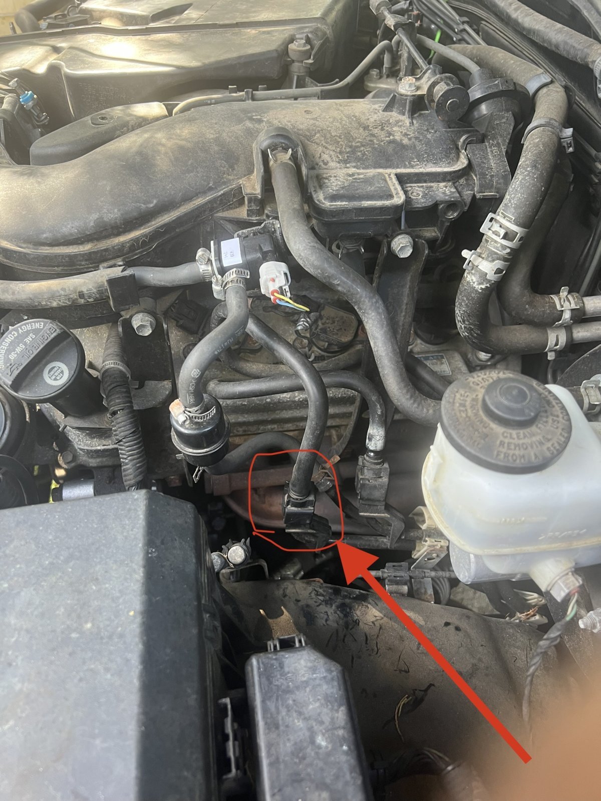

    You have a pic of where your trying to connect?
    The last one I did I put it between where the line connects to the frame.

    thats the one. Theres two lines let me tajw sone pics

    This is the one. And if you look at the bottom
    Where the quick connect comes off theres two lips yet this connector only has one. I didnt feel it was connected enough to start the engine

    I was thinking this was how I going to connect it
  19. Oct 9, 2023 at 8:48 AM

    Are you talking about the safety latch that goes over the top?
    If the tool clicks on and you can't pull it back off without depressing the tabs it shouldn't come off.

    Yes. It doesnt latch as it does when I reconnect the lines in the truck. Im certain the correct link that comes with the pressure kit is the 7.68
    I believe it is?
