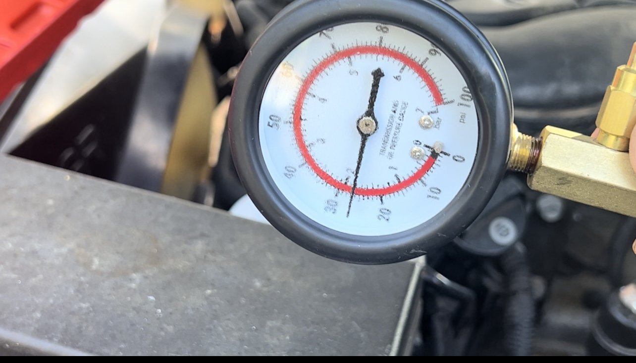

    I don't know why but I wasn't doing it during the day but I just got it to work and sure enough psi while running is at 27psi. When I opened the throttle there was a delay but the psi jumped to about 38 39. I shut the truck off maybe 5 minutes ago and it looks like pressure is gradually increasing. Its now at 29 psi.
    any thoughts!?

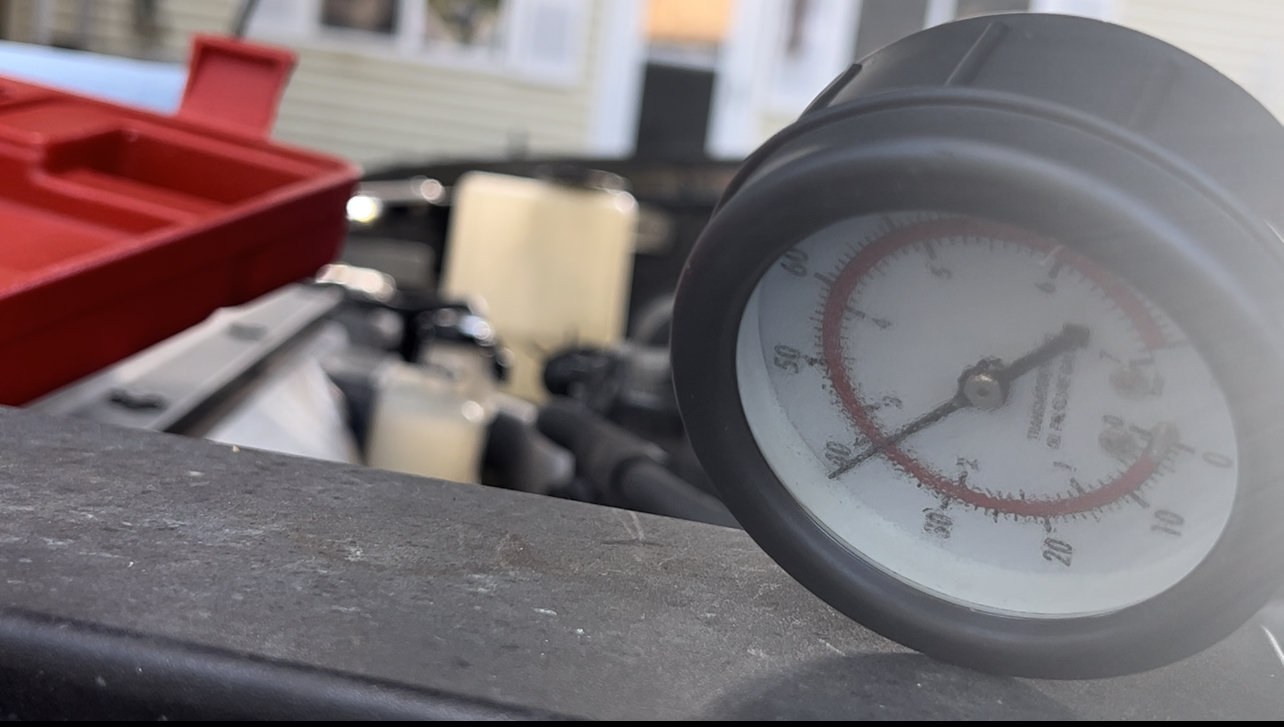

    Actually when I opened the throttle pressure dropped about 2psi before climbing to almost 40
    Attached pics of pressure at idle and at full throttle

    That's because the fuel pump kicks to high speed over a certain RPM and load. Looks like a weak fuel pump.

    I mean everything points to a weak pump, there's some advanced tests you could do to check circuit integrity with an oscilloscope but it's pretty unlikely to have low voltage at the pump and have the pump still run.

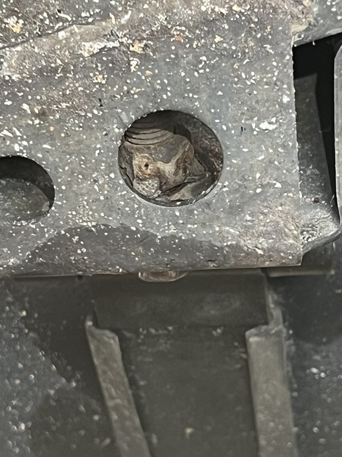

    Both strap bolts towards the driver side looks like the part of the frame that holds them in has snapped. Is it possible to replace with a new nut and washer? This is the one near the rear drivers side tire. Basically it’s just turning and turning now.

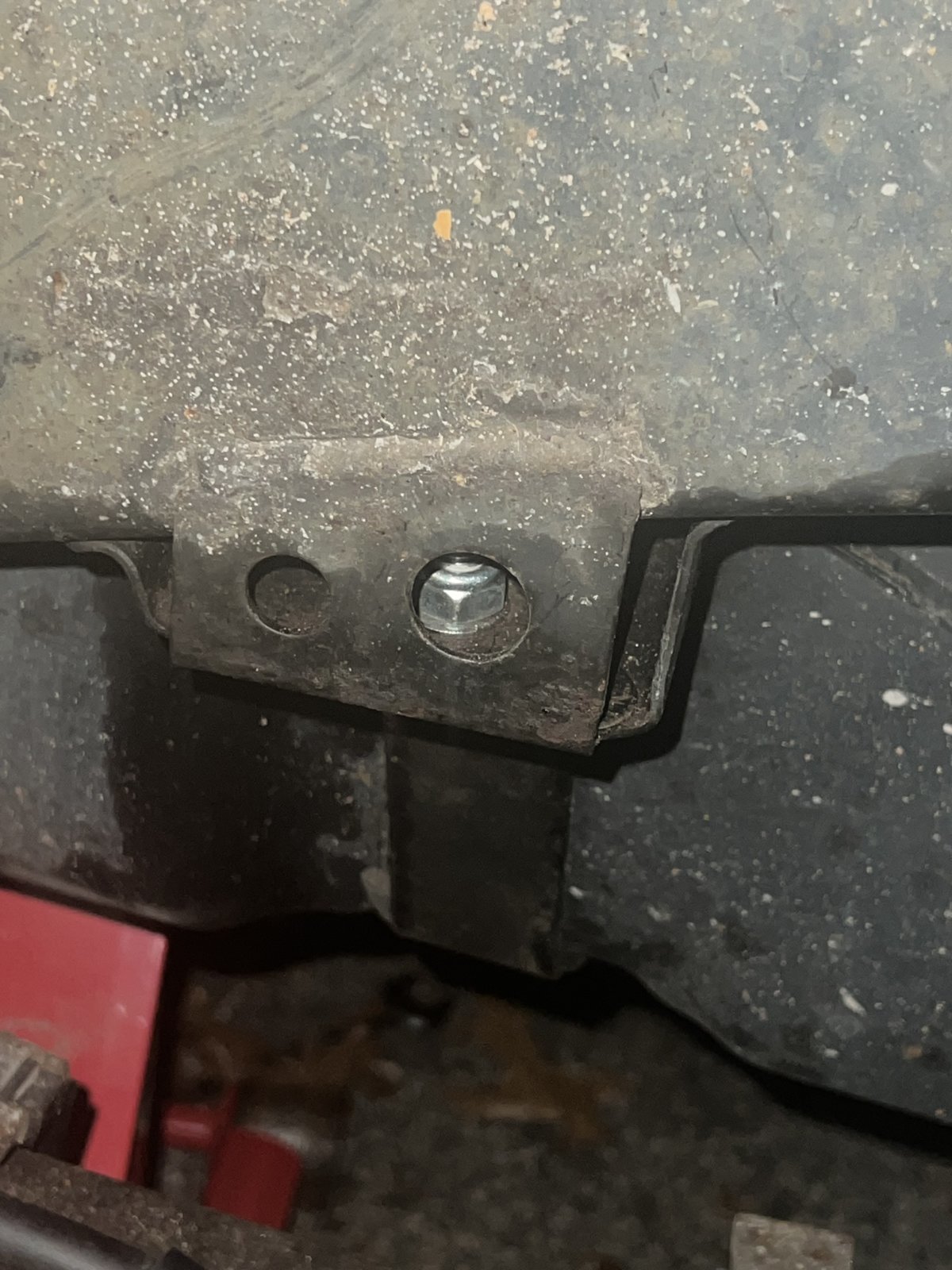

    Got that one out. The other I’ll have to cut. This Delphi fuel pump I got came with a broken floater. I ordered another Delphi from advanced auto they gave it to me for 232$ after tax - Uber to the store and they don’t even have it.

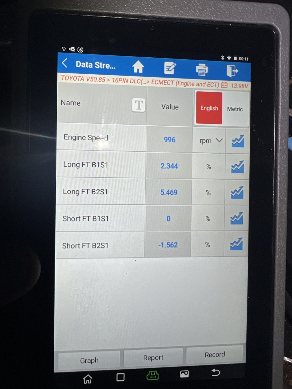

    LT Fuel trims were maxing at 39% prior to the fuel pump swap
    I am trying to figure out how to get that broken bolt that is holding the first gas tank strap (closest to the engine bay) as I cannot get the pin back in without being able to loosen that bolt first. It’s almost impossible to get something up and over into that small spaced area of the frame where the tac 4 pointed welded threaded piece of metal is spinning while the bolt is spinning. I am not sure how to even cut it while the tanks right there or even the fuel lines (even if they’re disconnected).
    I may need to have this towed but with a missing strap not sure how.
    but checkout the new trims - also, I shared a pic of the new bolt and nylock nut that was used to replace the other strap bolt and welded threaded part of the frame (closest to the rear of the truck).
