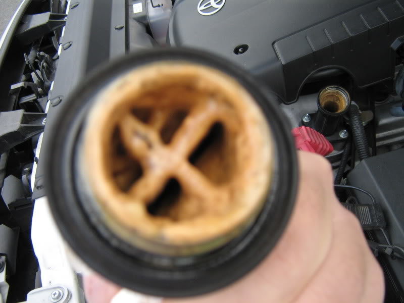

    This is what my cap looked like after my first oil change. I bought my truck used with 48k miles. The truck has extensive maintenance records indicating that it was never serviced by the owners so they probably never saw this. It is very possible this is 5 years and 48k miles worth of gunk. You can see the filler tube in the background. It freaked me out but after some research it appears this is a common condition.

    WOW!
    (and not in a good way)
    OK, I think I can safely say that is a little bit more than what most members were expecting. When I change oil there is a little, looks like like someone spit on the cap... I wipe off, no worries.
    Now MAYBE, this is what it looks like if for 5 years and no one bothered to wipe it off.

    First the picture of the oil cap posted by BBY2KS2K is definitely an indication of a problem. Oil with that appearance is not from driving short distance trips with a cold engine. An oil cap should never look like that.
    Milky colored oil under the fill cap may be normal if you exclusively make short trips especially at low temperatures. This milky oil under the cap is not just under the cap it in the entire engine interior. But it can also be an indication of a minor or more serious problem. First the minor stuff. The PCV valve on your engine is the component that is supposed to prevent this from occurring. The PCV valve vacuums the air from the interior of your engine. Every time you shut off your engine the interior walls of the engine forms condensation on them just like a cold soda can. This condensate in your oil will make the oil acidic if it is not removed. When you run an engine at operating temperature the condensate in the oil vaporizes to steam and the PCV valve re burns the steam in the combustion chambers. Check the PCV valve and make sure it has an adequate suction on it. A lot of folks say OH just remove it and shake it if it rattles it's OK. Wrong if it rattles it signifies it is not totally occluded but it could have buildup around the valve decreasing the amount of vacuum it is pulling. Decreased vacuum equals decreased water vapor being removed from your engine. It is a good idea to change your PCV valve every 2 years especially if you make a lot of short trips. You also have to check any hoses or piprs connected to the PCV valve as the may be blocked also.
    Now the serious stuff. Milky oil can also signify a coolant leak into the oil. If coolant is leaking into the oil it is via the head gasket or a cracked head. Usually it has no symptoms other than milky oil. First check if you are consuming coolant and if you are how much over how many miles. In a sealed coolant recovery system you should consume zero coolant.
    Second check to see that the coolant recovery bottle is percolating or have the appearance of the engine overheating (boiling) when the cap is removed. Do not remove this cap when the engine is hot you can burn yourself severely. This is caused by exhaust gases leaking into the coolant water jacket giving the appearance of boiling coolant when it is not boiling. Exhaust gases get into the coolant via a cracked head or cylinder block.
    If everything checks out OK and the oil is still milky change your oil more often every 3k miles. Using synthetic motor oil does not make the oil milky.
    Synthetic motor used in an engine that used conventional motor oil in the past will make the synthetic have a darker appearance earlier into the life of the oil change This occurs because the synthetic motor oil is actually cleaning the interior of the engine via it's different surface tension qualities versus conventional motor oil. After several oil change this will go away because the engine interior will be cleaner.
