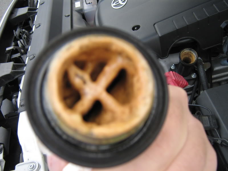

    I'm not going to sweat it too much. I watched the oil drain from the case and there was no indication of water in it. I'll get it tested next time through Blackstone to be sure. I would have done it this time, but I had already drained the oil when I popped the cap off. I'll check the PCV valve, maybe just replace it. It's a cheap part anyways.

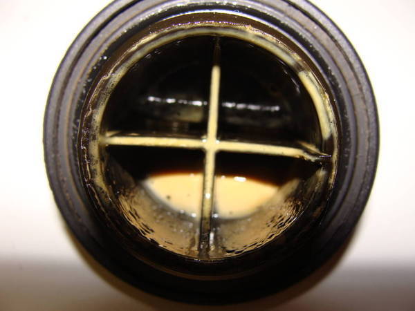

    I checked mine yesterday. I have the milky condensation on the filler tub & cap also. I checked coolant in recovery tank & radiator after it cooled and it was fine. I also checked the oil through the filler and dip stick. It looked OK too. Also, use Mobil 1.
    I cleaned it and took a short trip maybe 5 miles and let the engine sit until cool again. There was a small amount again. Cleaned it and took a much longer ride 20 miles and checked it this morning and it was OK. Checked the oil through the filler tube as the engine idled and it looked OK too.
    OK this is my DD and it's a one way distance of 4 miles most days with extended driving (20+) miles maybe once a week. But I've been doing this for 20 years and NEVER had this on either my '95 Tacoma 6cyl, '02 Camry 4cyl, or my '05 Solara.
    If its the extended filler neck I thinking of wrapping it in insulation and see what happens.
    Are others in warmer climates seeing this also?

    Not neccessarily. Like I said, I'm not gonna sweat it. I'll keep an eye on it, get the oil tested and go from there. I'm sure my 6 mile commute, 1 mile trip to the gym and the cool weather are not helping. Add the fact that I work graveyard, so my truck's longest trips occur at 11:45 at night and at 8:15 in the morning. Not exactly the warmest part of the day.
    I should add that a lot of the crud on the cap and filler tube in the picture was crusty and not sludgy (if there is such a word.) That to me would indicate that it is build up over time, perhaps since the truck was new. I just checked it again and there is a good amount of sludge but not nearly as bad. No funny smells, the oil on the dipstick came out clean and the coolant level is fine. I'll get the oil tested and keep you guys posted.

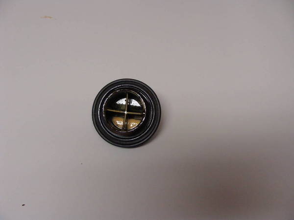

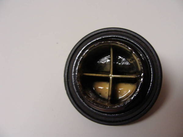

    I checked mine out today. This is after about 1,200 miles since last oil change. And like I said before, it doesn't really matter how long you drive because at least 1,000 miles or so have been pretty long trips ( 2hrs.) on the highway and the mayonnaise sludge did not burn off! :eek: [​IMG]
    I don't like the looks of this stuff. Coolant level is not changing at all either. :confused::confused:
