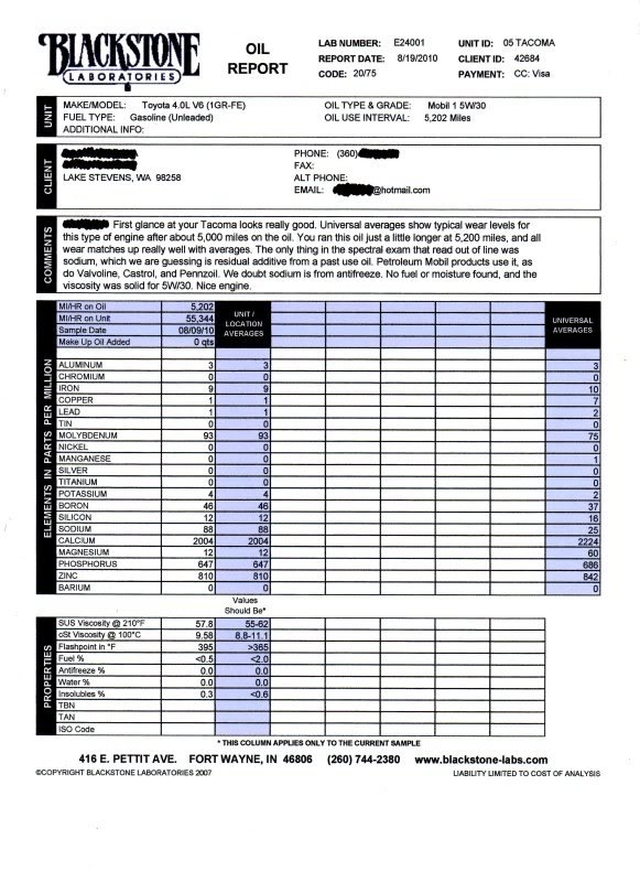

    Blackstone requests that you drive 10-15 minutes (or was it miles) prior to taking the sample. Its not required and if you dont, they just ask that you note that to account for the moisture that they will come across from taking a cold sample.

    But my point is, if there are other levels found in the oil that are reading high, it may not be directly related to moisture, as everyone is assuming it is. Moisture may be a contributing factor, but not necessarily the entire cause.

    That's up to you. If it won't put you out or you want some piece of mind, I say go for it. I'm the guy that posted the picture of the nasty oil cap and the Blackstone report above. I did it out of curiosity and to prove to the skeptics my truck was fine. That was four years ago and my truck still runs like a top (and still has the crap build up under the cap during the winter.)
