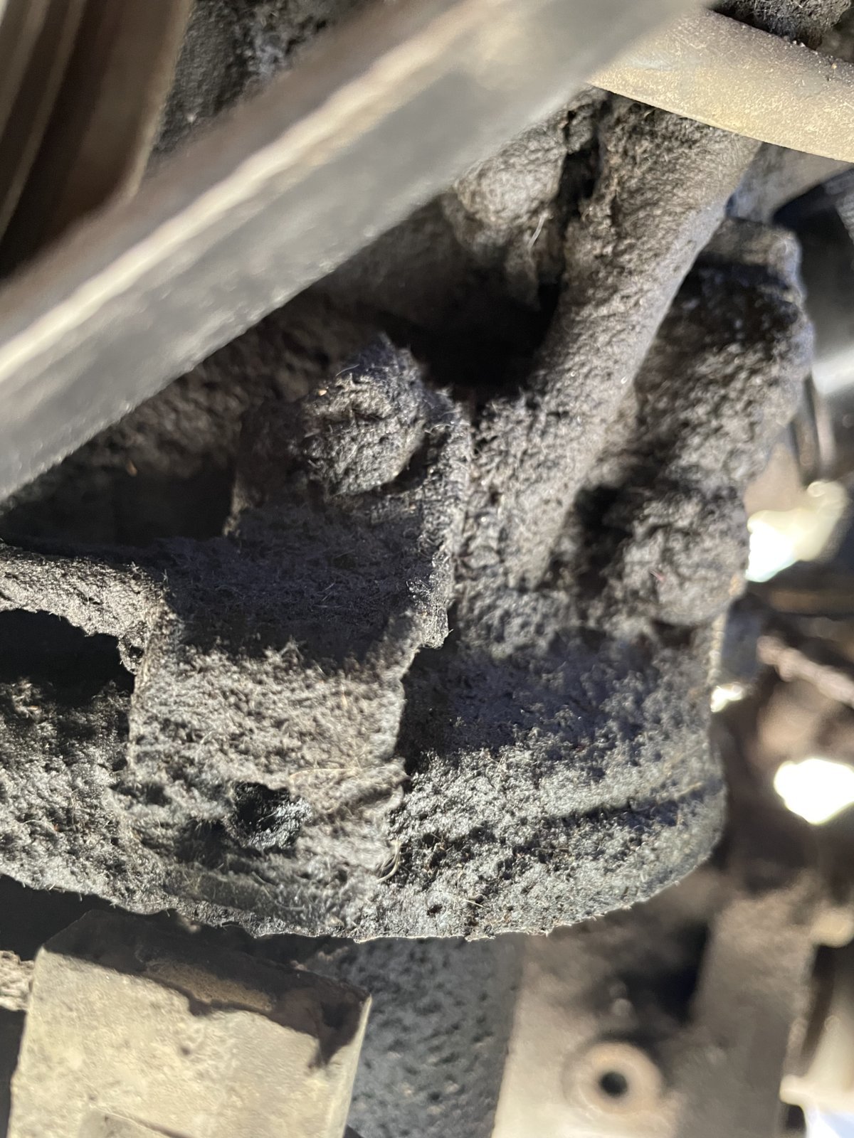

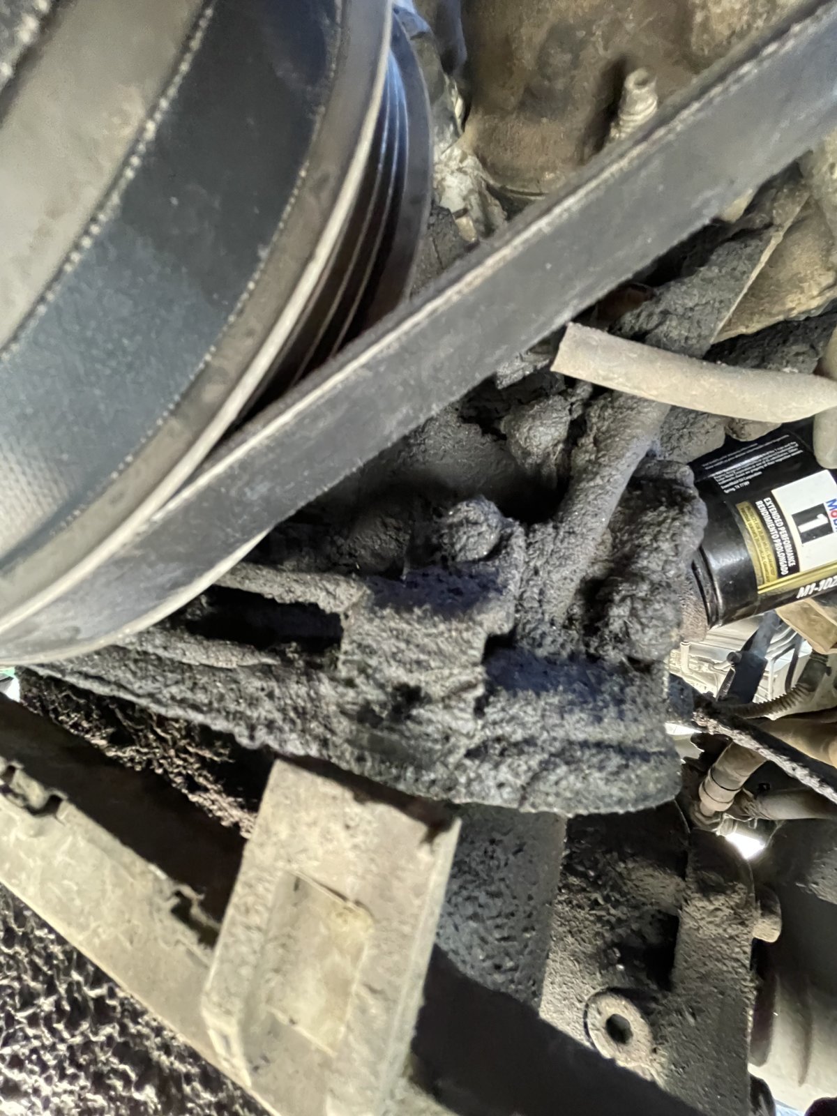

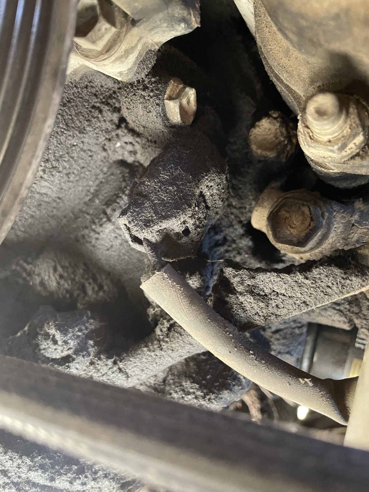

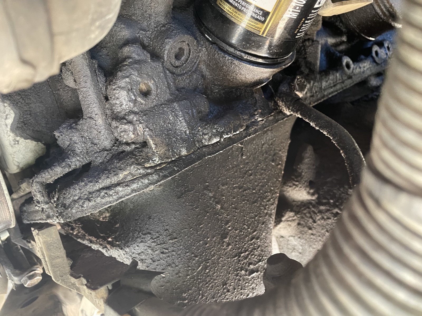

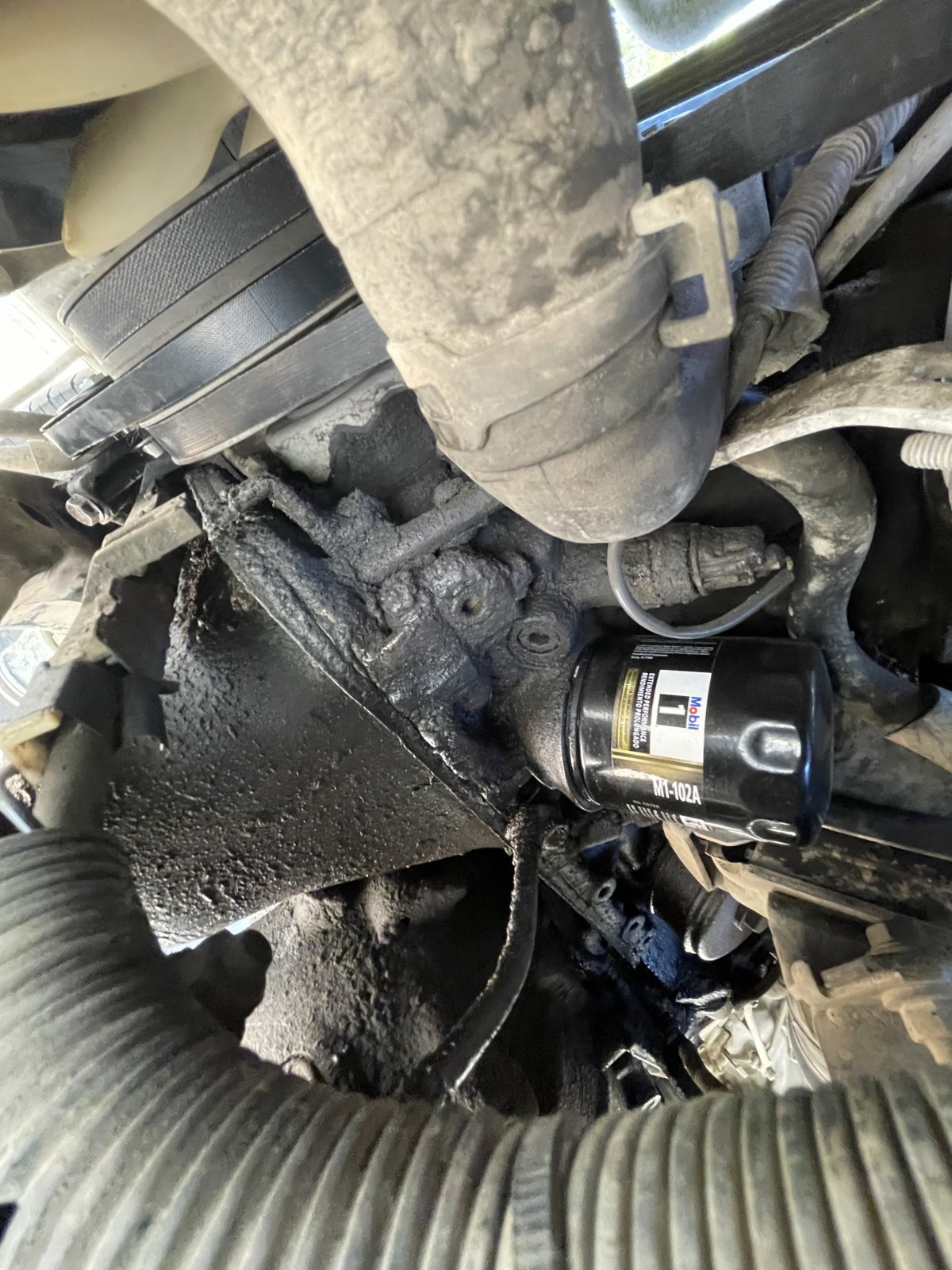

  20. Nov 5, 2023 at 4:17 PM
    #20
    TacomaTheKid
    TacomaTheKid [OP] Member
    Dec 4, 2022
    #412326
    21
    New Tacoma Owner
    2000 First Gen Tacoma 3.4L V6
