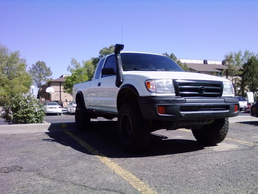

    I started off by immediately bringin it down to Farmington NM. I was going to school down there for Toyota.... so naturallly on my down time i was tinkerin and wheelin:D
    I started with a bunch of maintenance.... im very picky being a tech, so this thing is prestine, doesnt leak a drop. It needed alot of tlc when i got it, im a firm believer in the saying: "take care of it and it'll take care of you".
    I then began the mods. started right off the bat with the gray wire mod. What a great mod, 2wd locked in the sand is fun as hell. I wheeled alot down there and began to get the feel for the truck

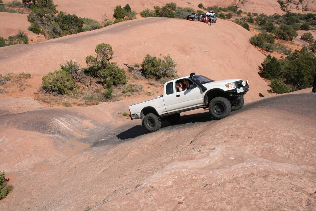

    Wheelin down in New Mexico was a blast, definetly plan on going back soon.... once i Graduated, i came back home to Denver and worked full time. this thing was in the shop ALOT.....

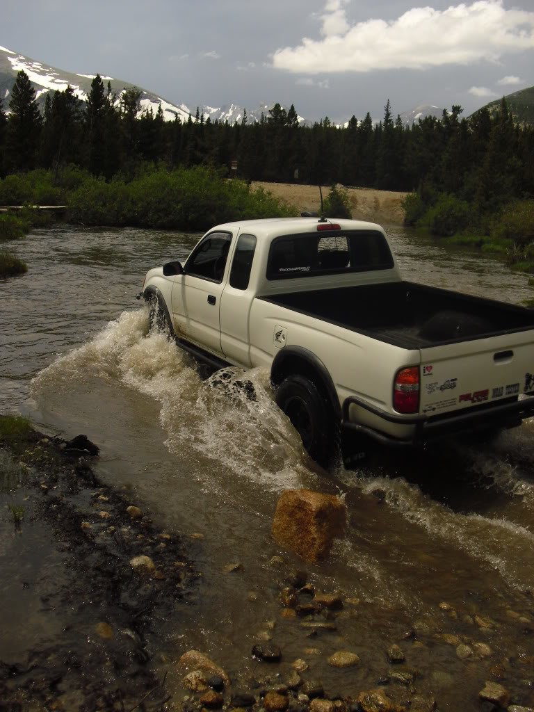

    I found a puddle up in Arvada and decided to test out my snorkel for the first time:
    I went through that puddle long ways (opposite of video) and found a large hole left by a bgger vehicle... the headlights dipped down and i had water up on my windsheild.... holy crap it was awesome! BUT.... got back to the shop with my truck sounding like it was super charged. diagnosed a bad a/c tensioner pulley bearing. Due to the water washing it out.... so need less to say, may not go through that deep of water much :(ha .
    My first Moab trip. Man do i love that place!
    I wheeled:
    Hells Revenge
    Green Day
    Area BFE playground
    Poison spider
    sand dunes
    So much fun it couldm't have been my last time.....

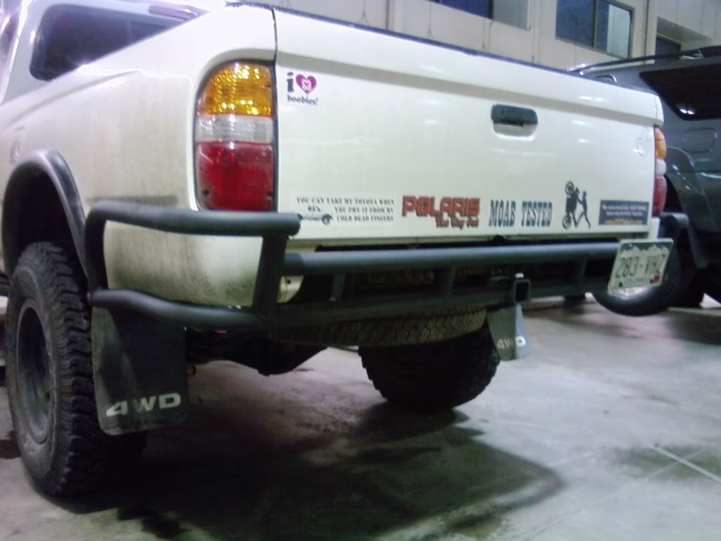

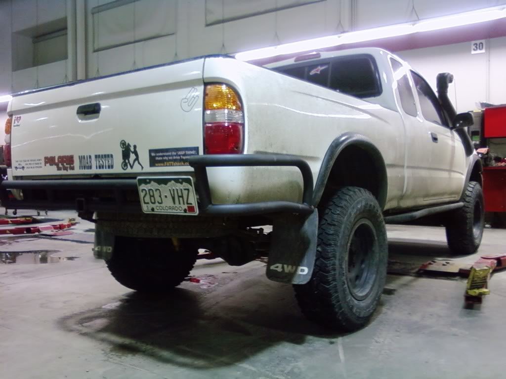

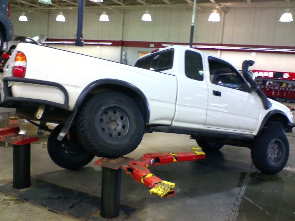

    After wheeling more and more and pretty much destroying my oem rear bumper, i ponyed up and bought the Trail Gear rear and Trail Gear rear frame supports. I knew i was gonna be pulling or being pulled hard so i wanted the frame to be strong.
    Then the bumper... bolted and tacked.

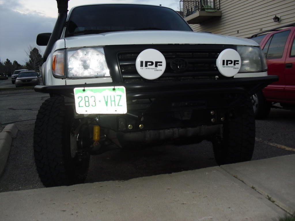

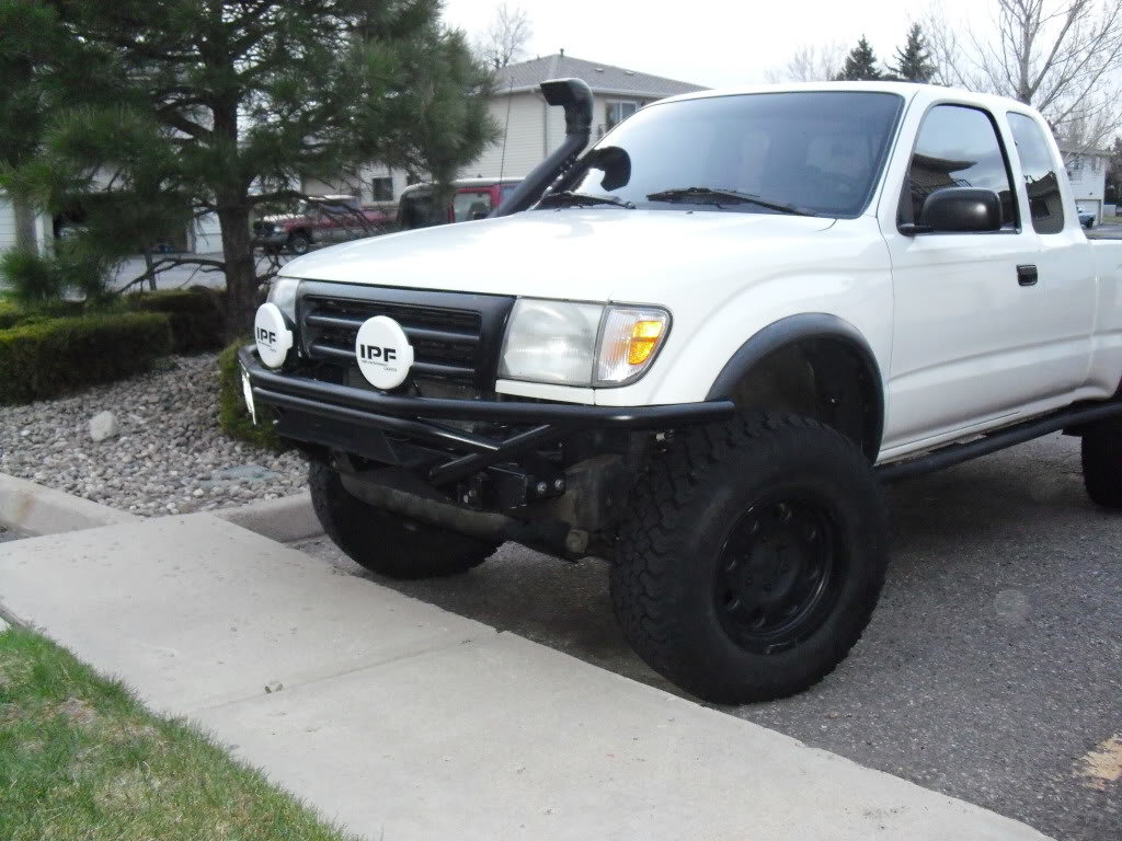

    I then finally saved up for the front Trail Gear bumper. I was tired of pushing my stock up and over my obstacles:frusty: I also ordered the Trail Gear light tabs. After mocking up and welding the light tabs on, bumper got a bunch of primer, flat black paint and flat clear...... I then mounted the IPF lights and wired them in. Also installed the optional 100 W bulbs in them. I love these lights because the have a dual reflector inside gthat focuses the light in the center to extend far lengths and another reflector for wide angles.
    Edit: Like the zip ties? haha ran out of time before the shop closed to drill and tap....

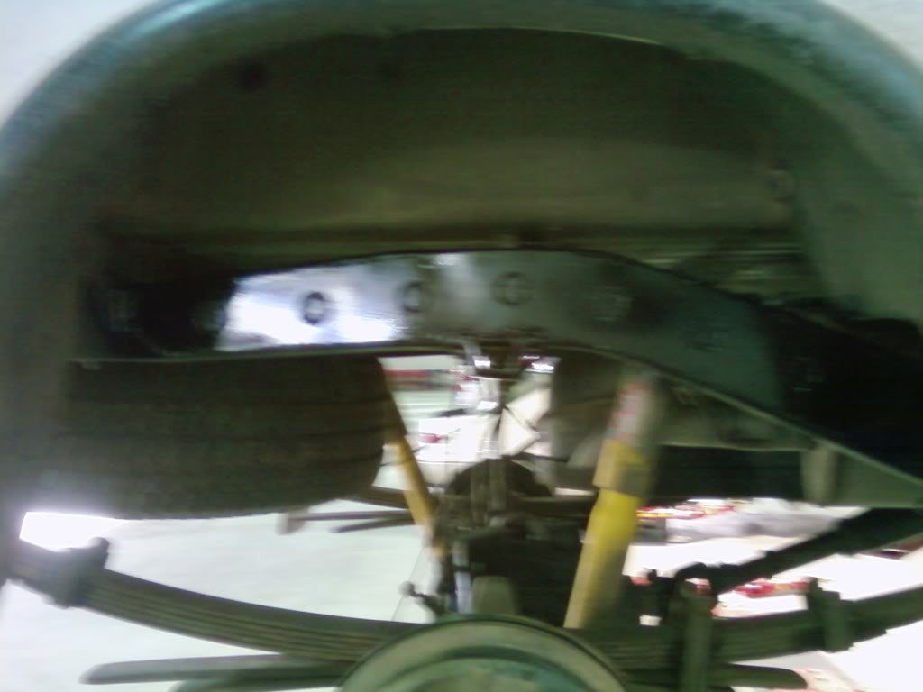

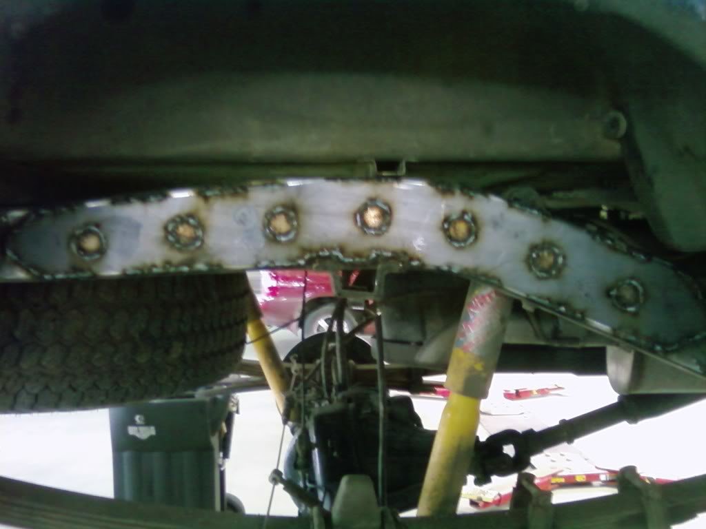

    Next came the winch, i got it used but in great shape. Warn 8500. The bumper was not meant to accept a full size winch, only low profile ones. I ended up trimming my grill to fit the winch, but totally worth it to fit this beast.

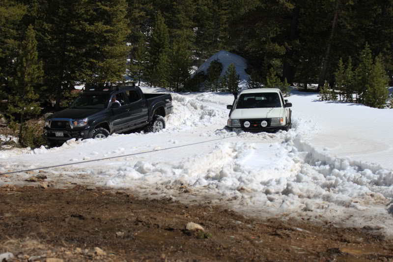

    I wheeled alot with this setup. did great even with my worn out Cooper's. Had alot of fun though.
    ok maybe not great..... ha

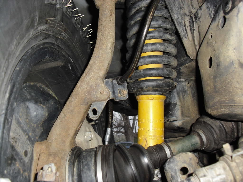

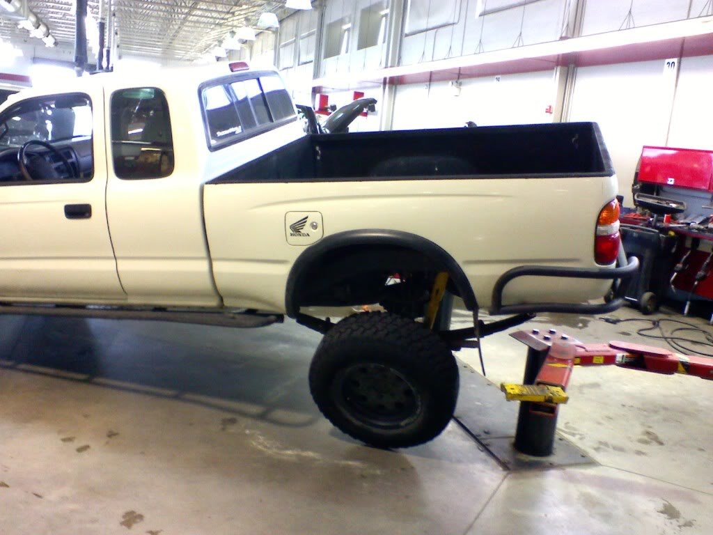

    Eventually i decided my furture plans of the shackles, and i relaized how tight my rear rear brake line was at full droop... SCARY! i couldve played a note on it! So... My dealership works alot of SLEE offroad, so i got their Extended brakeline kit. they are essentially your standard stainless steel brake lines, but have a kevlar coding around it that seems really durable. (they even make a 2nd gen kit, check out NYCO's build)
    rear:
    front:
  14. Aug 18, 2011 at 12:19 PM

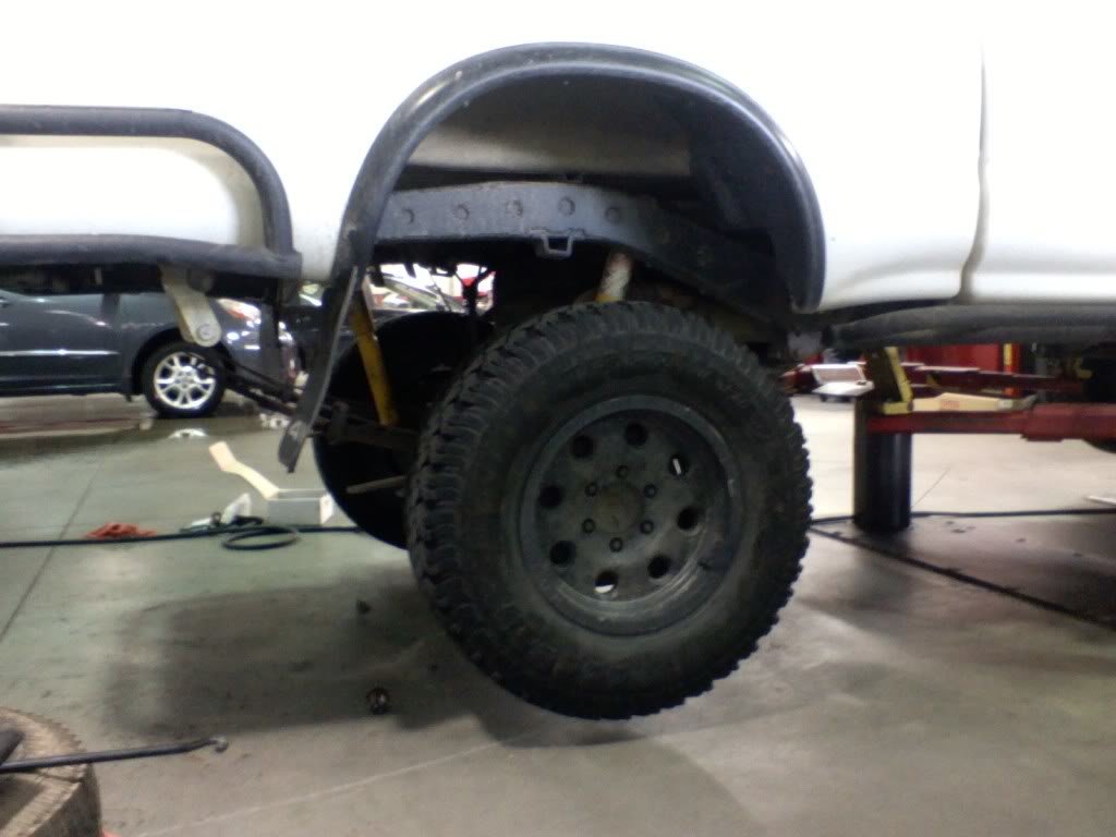

    Like i said before, i wanted to do shackles.... i was thinking about johny joints but decided against them , because this is still my dd. BUt i ordered up a set of TG 6 inch greaseable shackles and bushings. During installation i realized i needed to make some spacers. the width of the top mount and the width of the spring mount is alot different. i Took 3/4 inch aluminum round spacers and measured half an inch. Cut, shaped and rounded the spacers and they worked perfectly! I slid the bolts throught. tightened the nuts a little tighter than hand and tacked the bolts to the nuts, so they wont ever loosen.
    HOLY DROOP BATMAN!!
    I quickly realized to gain full effect of my new rear suspension i had to change shocks. the ome would work for daily driving for now, but not flexing. disconnected ome's and to measure for billies....

    So i got my new measurements-compressed and fullly extended. Ordered up my new bilstien 5125's!

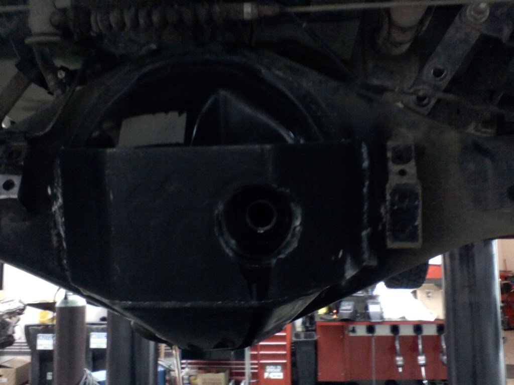

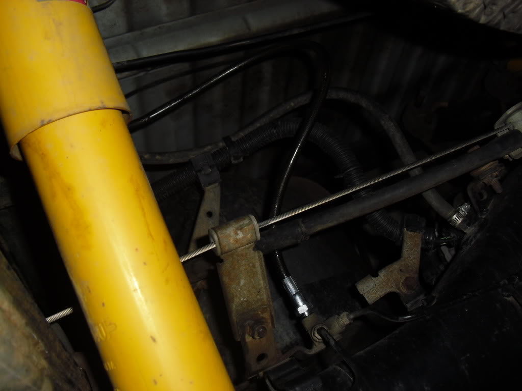

    When i replaced the rear shocks i also had to modify the rear brake load proportioning valve. with the rear axle being further down from the frame. the proportioning valve was allowing less brake pressure to the rear. so i had to fix that. this is my only picture i have of it, but you can see it in the top right. Its a bout a 5 inch bracket i made out of 1/8 in steel thats only an inch wide. i drilled some holes and mounted the bottom arm of the proportioning valve arm on top of it. Making it think its back to stock level- giving me more braking power:rolleyes:
