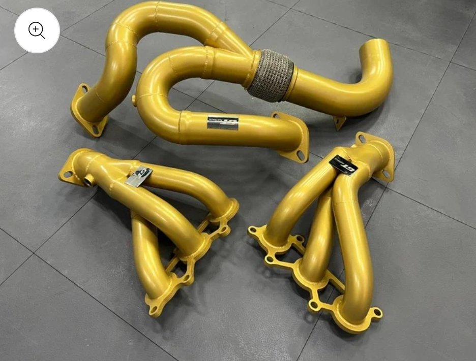

    Evora headers...
    Third Gen Tacoma V6 downpipes....
    As you will notice, the Evora are individual ports and tubes while the Tacoma is a single port and tube...
