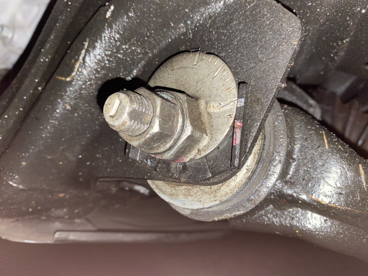

    This issue just started happening to me after an alignment. is this the alignment bolt your referring to? Do i just tighten down these bolts to 100ft lbs?

    Yes, but torque down the other side. Should have a double nut so to speak. Sorry for the bad pics, its dark and the truck is in the yard tonight.

    Rear LCA bolts tighten via the nut you point out.
    Front LCA bolts tighten via the bolt head like tumbleweed pointed out.

    Wow thanks a ton for taking the time to go out and grab those photos for me, very much appreciated! im gonna go check the torque on those bolts now

    Make sure you torque them while the weight of the truck is sitting on the front suspension. It should be a ride height. To give yourself more room, put it up on some ramps and take off the front skid.
    PSA of the day, grease the skid bolts before reinstallation or better yet, buy some harder ones at your local Tractor Supply....and then grease them too.
