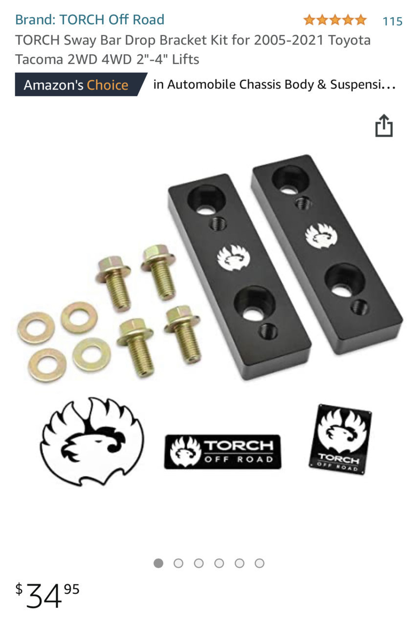

    I had a similar issue when I installed the 5100's with OME 887. I would get a loud metal on metal sound on sharp turns and going over bumps. Once I went with a sway bar relocation kit it fixed the problem. Torch makes a cheap one for around $30. Maybe this will help you out.

    Is this the kit? I noticed it says it’s for a lift but I don’t have one. Will this still work?

    If you lifted your truck with the 5100's it could be causing the issue. Once I went up 2" with my 5100's I started hearing the noise. If you did not lift with the 5100's it could be something else. The link you shared was the same kit I got. It's a little cheaper if you buy directly from them.

    I don’t know why you would need a sway bar relocation kit if all you did was replace the shocks and adjust the ride height via preload. You haven’t changed anything about the suspension geometry.
    My kit from headstrong came with a sway bar relocation kit but I believe it’s purpose was to clear the larger diameter king branded coil springs. My memory might be a bit foggy.
