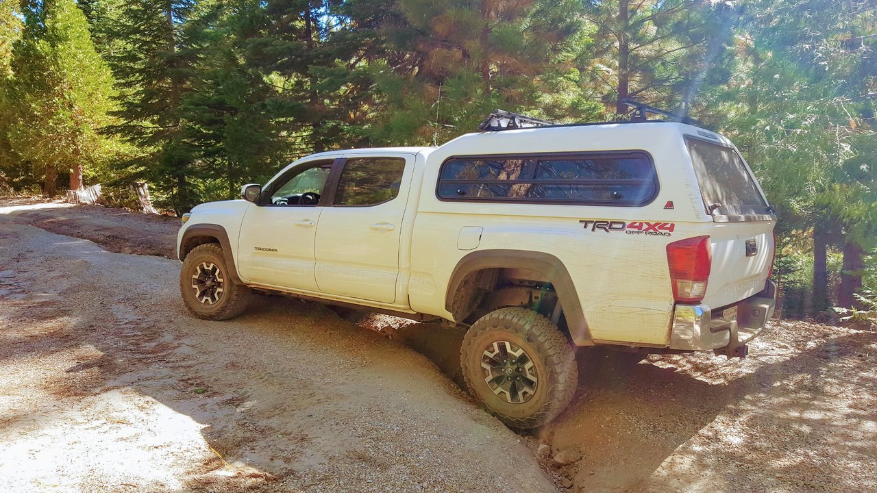

    I think the problem was that Trac control was on, and I was either on a steep downhill the first time and then had lots of wheel slippage the second time in the dunes. I took it to the mountains last weekend and tried to get it to repro but couldn't. I don't think I could get the same conditions, not steep enough and no slippage. On the plus side it performed really well. Aired down and hit the trails pretty fast and it feels like a caddy compared to my bone-jarring Jeep. Had to get a poser pic...
