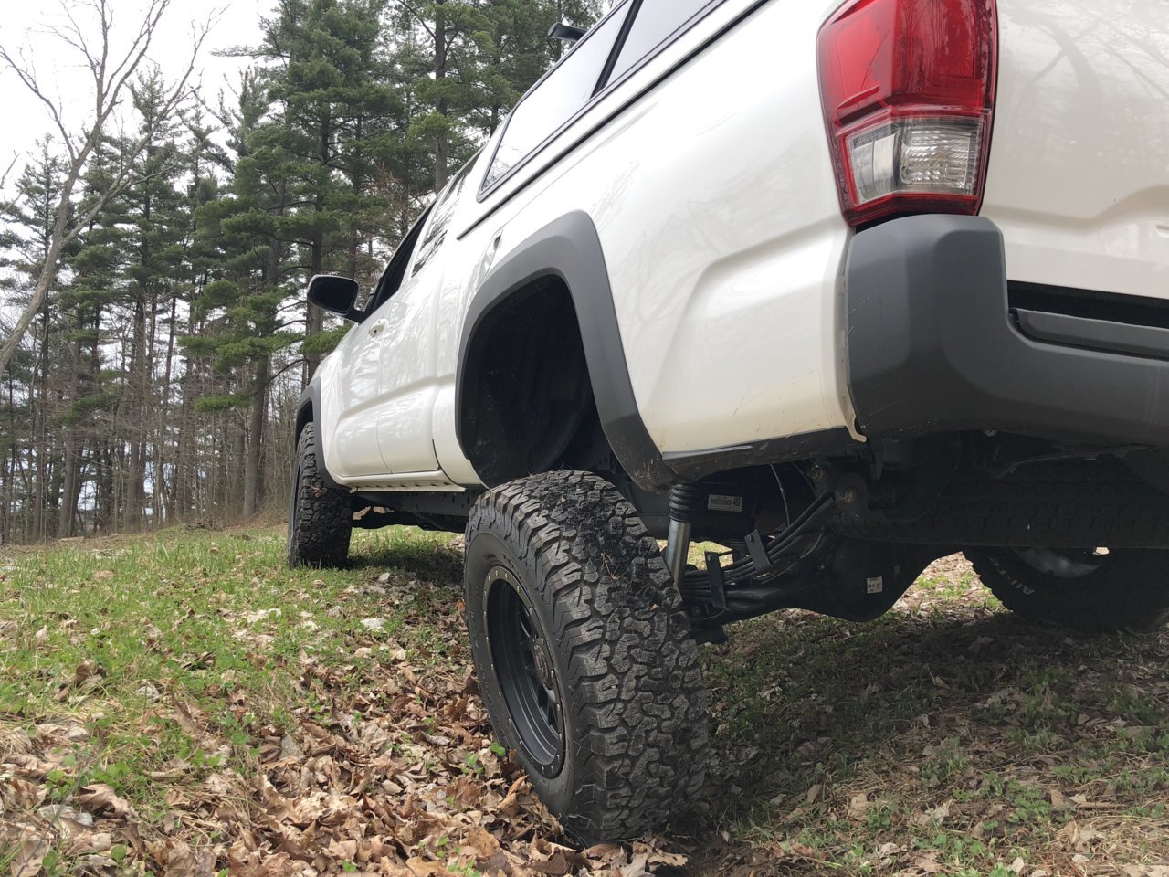

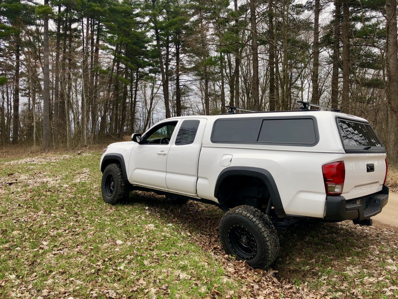

    Anyone experienced any loud pops coming from their Dakar’s or the rear end in general while flexing the rear?
    This is one of the first times I’ve ever actually flexed the rear end this much and while pulling out back on to flat ground (forward) from this ditch it made a horrendously loud POP!
    Any ideas? Truck still drives fine. Just curious if any others have experienced this or what it could be?
    I did notice the pack on the drivers side was starting to shift some horizontally between leafs while looking at it and taking my poser pic. Is that normal on this kind thing?
    And I’m not totally 100% certain it came from the leafs. That’s just my assumption...
    Thanks!

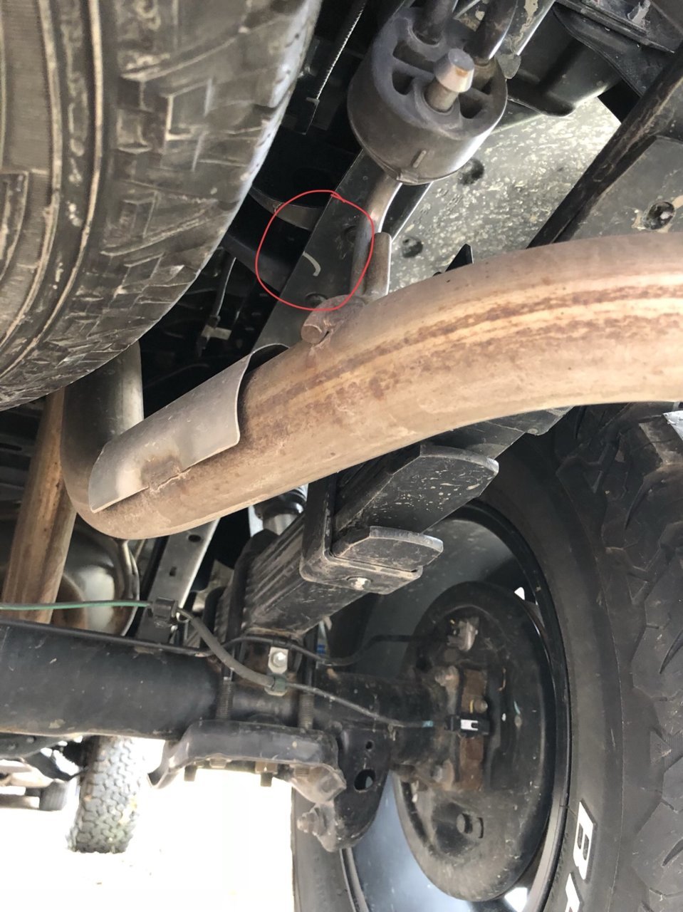

    Check to see if the front Spring eye moves side to side on the bushing and is touching the frame mount.
    My Dakar’s used to do this and I solved it by replacing the front bushing with a poly bushing.

    You might be on to something here. It looks like it might have hit the frame. It doesnt appear to have bent the bracket though like some of the photos in that thread but it looks like it hit for sure and maybe slid to the inside of the frame and then popped back out and made the noise.
    You can see the scratch in the photo below i just took is in the exact same spot as the photos in that thread. Thanks a lot! I’ll have to do it again and look closer next time!

    I was just out off roading this weekend and did some good flexing fully loaded with my rtt and while I was was just pulling out of articulation I heard a load pop too. Everything seems to be normal but still concerning. I also though it came from the leaf springs. Let me know if you find out what it was and I'll do the same. I have the HD springs with the overload leaf removed.

    2016 DCSB TRD Sport 4x4
