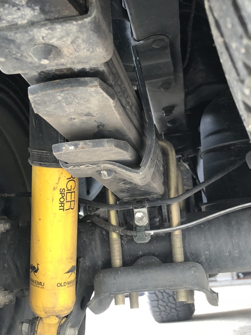

  4. Apr 9, 2018 at 5:36 AM
    #24
    17taco4x4
    17taco4x4 FZJ80
    Mar 9, 2017
    #212810
    1,451
    Orlando
    Porter, TX
    1997 Land Cruiser
    Checked mine Sunday after hearing a squeaky noise and noticed it was bent.48A25399-C53C-456E-BF6D-73EFAA186619.jpg
