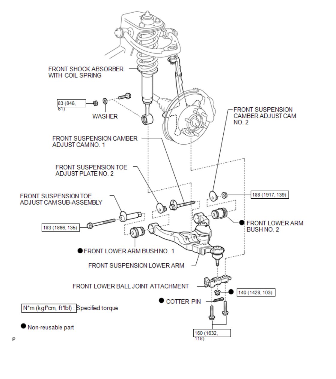

    I was wrong.
    Looks like it's 139 ft/lbs on the 3rd gen

    See my post above.....139 is the spec.

    Alright! So I dropped my skid plate and checked the torque on my LCA bolts this morning. All of them were slightly loose. I tightened them all to 139 ft lbs and got about half a turn on them. When I got to the right rear bolt, it made a got awful sound when I turned it. It almost sounded like a ratchet skipping. That was 100% my noise. I brought it up to torque, loosened it, and re torqued it. Now it’s quiet and my noise is gone.
