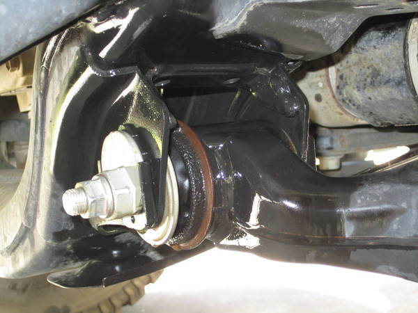

    Mind sounded the same. Could be lower control arm bushings. I soaked mine in lubricant and went away a few hours later. I had that noise for over two months.

    No problem. Mine was bushings tho. I would say give it a shot. Wont hurt just to spray some lubricant.

    you never know. I had that noise for two months. It was bugging the crap out of me. looked a everything, even did some cutting because of that. one day i just spayed some lubricant on the lower control arms and bam the npise was gone.
