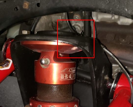

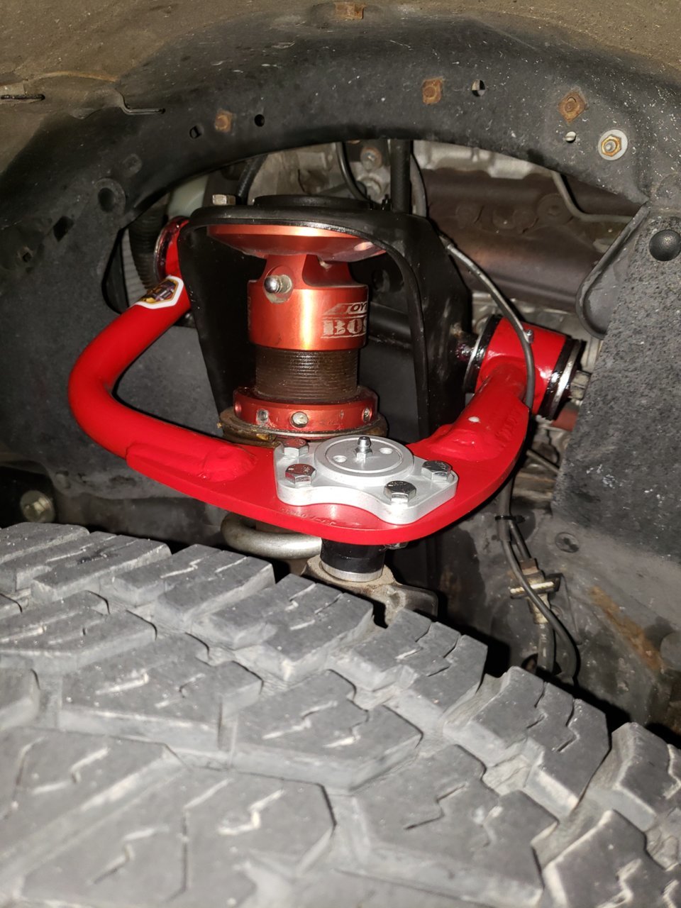

    So I've got a 2014 DCSB sport, sitting on toytec coil-overs w/ 650# springs. I just replaced my UCA's to JBA so I don't think the problem lays there. Every time I hit a hard bump in the road, or pothole (for any hard down motion, specifically in my front right tire) it sounds like a very hard thud when the tire hits the ground again. The toytecs are old, so I'm hoping once I can afford new Fox coil-overs, it will solve the problem, but just looking for more input. Any other idea's where the problem is? or is that just how blown out shocks feel like?
    attached photo is my current set-up

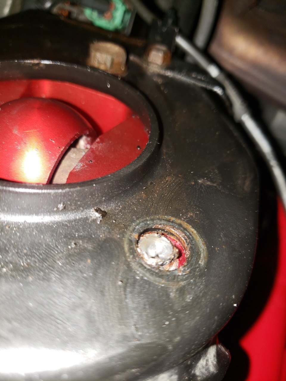

    In your picture, at the shock mount: is it me being blind or is there a bolt missing that holds the shock in place?

    You are correct. I tried bringing it to a shop to get them un-siezed, and they couldn't get them, and broke that bolt. Only has 2

    Even still, I would get that fixed so you can bolt it on all three mounting points. If you go hard on a trail one day you might damage the other two or even possibly the coil bucket

    Is the broken bolt stuck inside the coilover? You can drill it out, they make drill kits specifically for broken bolt removal

    Oh yeah you can get that out no problem. I'm surprised the shop didn't try, shops deal with that sort of thing all the time. Look up 'broken bolt removal' or 'broken bolt extractors' on google and there are tons of good videos on how to do it
