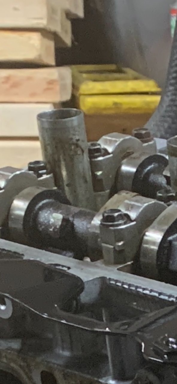

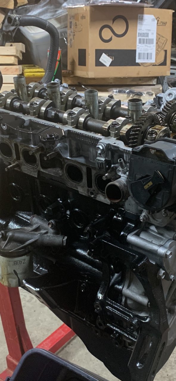

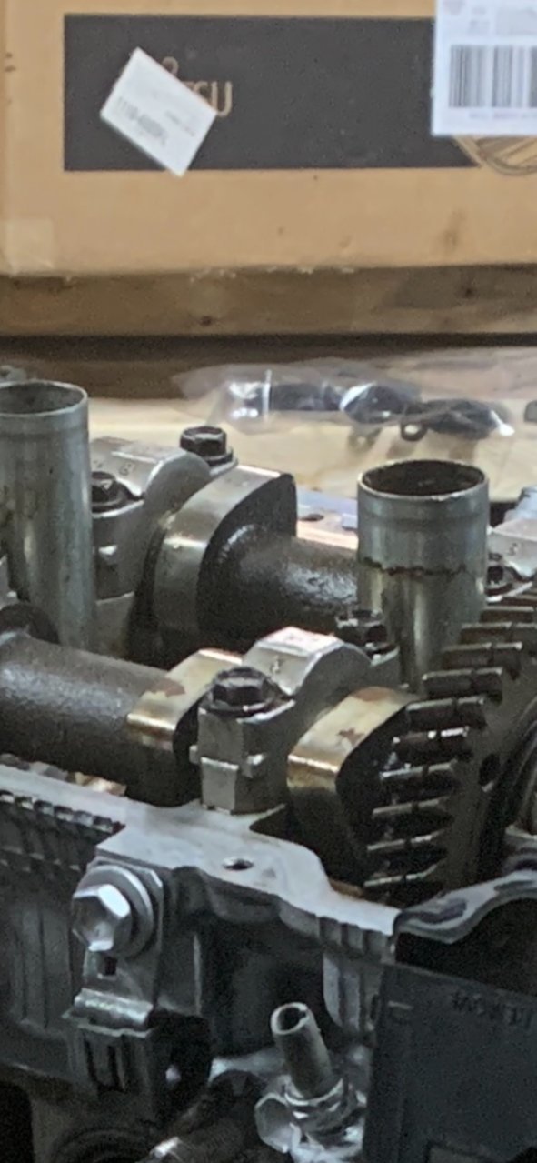

    Just got done doing a JDM swap on my 95 4x4 3rz (dad blew up my old motor, long story). The swap was pretty straight forward and went pretty smooth. The new engine runs and performs great, the only issue is a very prominent ticking noise when the motor is warmed up. The ticking is not always there, but it is loud when letting off the throttle and at idle, though it sometimes just comes and goes at idle. It appears to be coming from the back top end of the motor, though even with a long screwdriver I can’t pinpoint it anywhere. I know the Tacoma tick is a thing but there is no way this is it.
    Like I said, it is quite loud and driving me insane as I am pretty paranoid about blowing another motor. The inconsistency of it makes it sound like something loose or an exhaust leak, but I cannot pinpoint it.
    I originally thought it was a valve issue, so I pulled the valve cover off and checked clearances. The intake side was good, all shims were in spec, however almost every exhaust shim was out. So I removed the exhaust cam, bought some new shims, and rearranged some shims and brought everything back to spec.
    Well the noise is still there.
    I checked the spark plugs, swapped the injectors from the old motor over, and re torqued the header bolts, so it can’t be any of these things.
    I should also mention that this motor must have sit for a while (makes sense for a JDM) and when I first got it some of the cam lobes had slight surface rust on them (see image). Could this be a cause? Like I said it only seems to be coming from the back, but there is defiantly rust on the front cam lobes as well.

    Do you know what a bearing knock sounds like? You did remove the rust on the cam before cranking ??
    Enough rust can wipe a cam bearing .
