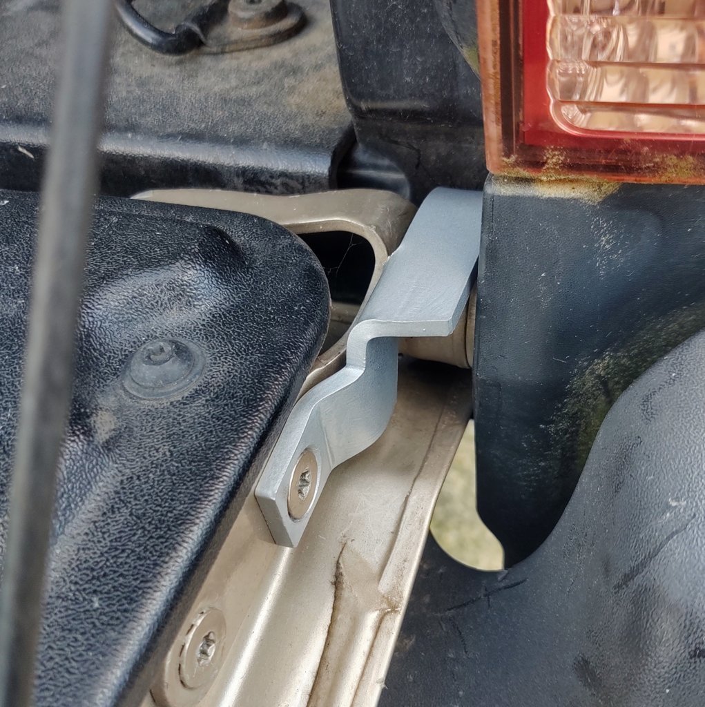

    Here's an even better option, at least in my opinion.
    https://www.tacomaworld.com/threads/tailgate-anti-theft-device.612331/
    Edit to add ordering info.
    https://www.tacomaworld.com/threads/tailgate-anti-theft-device.612331/page-27#post-30542011

    Is it U-shaped or does it hook around the hinge? If it's U-shaped, there doesn't appear to be anything keeping it from being swung upwards by prying with a flat screwdriver/small prybar. And if it can be pried up that way, it'll loosen the screw as it pivots. Either both torx bolts should have been used, or it should have been extended past the one torx bolt so it would butt up against the tailgate to prevent it from pivoting.
    Edit: Finally found a picture of one uninstalled. Looks like it hooks around the hinge so it can't be swung up. All the pictures I've seen prior were for the 2nd gen. I still don't like the exposed fastener, but it isn't as bad as I thought.

    It loops underneath the hinge so prying up won't work and there's no room to pry it down. Not to mention it's made of 3/16 steel so you're not going to bend it easily, certainly not with a screwdriver. With the safety torx bolt installed with a couple of drops of red loctite it's not coming out easily either.

    Not if you pry up the cover on the truck bed side corners
