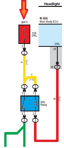

    Thanks all, I used the H/L headlight fuse and it works fine. I seems if the DRL is used they are always on, found similar threads and with the same issue.

    It's because the DRL fuse is always "hot"/energized. See the drawing..says Battery on top. In other fuses it may say IGN for ignition.

    cant argue with the schematic.
