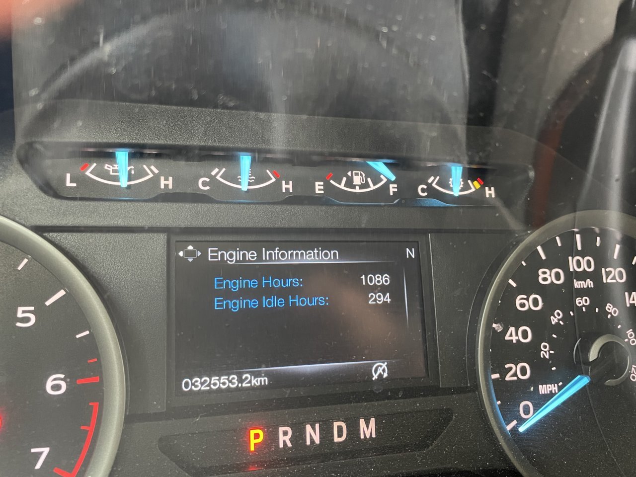

    My newish base model F150 I drive for work has a gauge in the cluster. I rented a Dodge Charger on a job out of town recently and it was a menu item on the screen. It’s totally lame that Toyota can’t give us this simple info without a scanguage or OBD reader.

    Ford really puts Toyota to shame in the info-tech department. I get oil pressure and tranny temp, and even engine hours.
