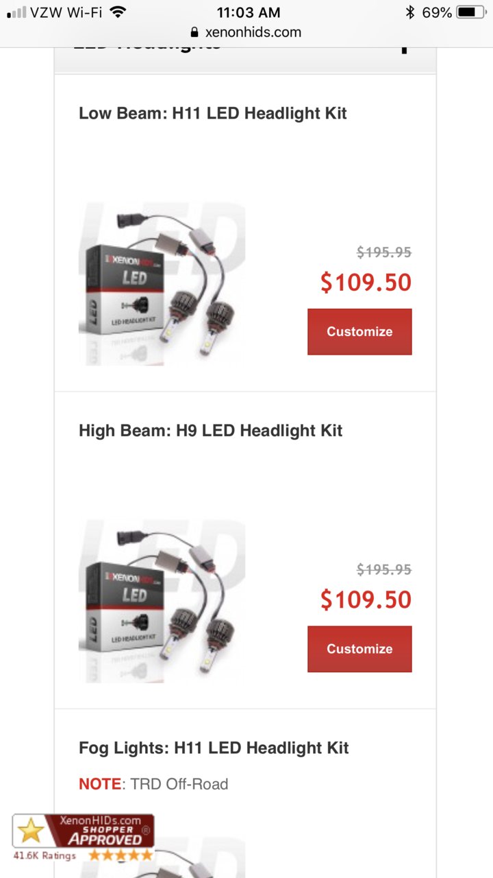

    Ya I’m confused, is he using a Xenon or LED.
    Maybe he means XenonDepot LED?

    The LED’s shouldn’t draw much. It’s the fans that I I would think draw the most. It’s saying the only need 2.2 amps to run. Not sure if that’s the just the LED’s or everything. I know with HID’s the 55 watt ballasts sometimes peak more than 10 amps and I have seen them blow 10 amp factory fuses. It’s possible with the fans on the bulbs if the lights are hot enough or maybe something is restricting the fans that perhaps they are drawing more than 10amps or might just be getting a little warm and the fuse is the weakest link so I’m theory if should be the first thing to go. That isn’t always true though. You could test the draw with a mulitmeter or amp meter.
