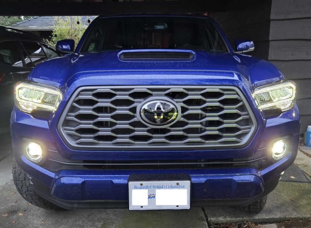

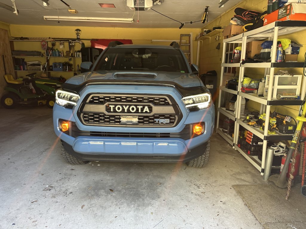

    [which wiring harness did you use? I am about to install some Oem LED for a 2021
    QUOTE="DMYS, post: 30375915, member: 308940"]I replaced the stock halogen headlights a few months ago with Toyota OEM LED headlights. Was pretty easy using the adapter wiring harnesses, have had no issues at all, the headlights are actually useful now!

    I was hoping to use a @daveeasa custom wiring harness, generally recommended on this site as the best aftermarket wiring harness:
    https://fbchs.square.site/product/t...true&sa=false&sbp=false&q=false&category_id=2
    but he was not able to ship to Canada, I had to order this Morimoto wiring harness from Headlight Revolution instead:
    https://www.headlightrevolution.com/toyota-tacoma-oem-led-headlight-conversion_2?quantity=1
    The Morimoto wiring harnesses worked fine, just had to be a little more aware of getting the high and low beam plug adapters sorted correctly; Dave Easa's harnesses are essentially idiot proof because
    he has everything so clearly set up and labelled - unfortunately I think he is shut down for a while, might be permanently but suggest contacting him to verify. If he's still got some harnesses I recommend buying them otherwise the Morimoto harnesses will be a workable second choice.
    Also, I got custom wiring harnesses for my son's 2022 SR5 Trail Edition from @Puppypunter. Johnny provided me with a lot of information and really outstanding customer service, no hesitation recommending contacting him if you have any harness questions:

    showing not accepting new orders. I ordered one from eBay. Will be here Friday. Wish me luck lol

    DRL work and turn signals but no headlights. Checked the fuse and they are good.

    Might be something with the eBay wiring harness, suggest you contact @Puppypunter for some troubleshooting advice, hope you get it sorted

    Just checked out the Headlight Revolution site. And contacted eBay seller. No color or matching color to match up high low beam. Hmmm

    I can't speak to possible issues with the eBay harness but I had no issues with the Headlight Revolution wiring harness installation. Just need to be careful matching the low/high beam plug adapters correctly. It's basically 50:50 plugging in the adapters correctly, I guessed wrong the first time, immediately evident when the fuse blew and the headlights didn't work! Switched the plug adapters around, replaced the fuse and everything worked.

    Yea the two 10a headlight fuses not being blown is what throws me off.
