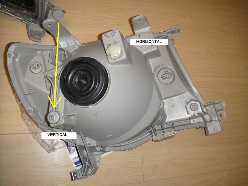

    Hi! Looks like my low beams are set too high. I checked the headlights from the back, it suppose to be couple screws there that control the level of the bulb. For some reason I cant find any. Is it possible? I have 2011, Reg cab, manual transmission.

    If they are factory headlights, there are 2 adjustment screws on the back of the lights, one controls horizontal adjustment (up/down), the other controls vertical adjustment (side/side). The ones lower on the headlight control the horizontal adjustment. They are low on the headlight and toward the outside of the light. You can adjust them by feeding a long-handled philips head screw driver down from the top. You will see 2 plastic ribs that act as a guide for the screw driver to help you. Here's the portion of Toyota's FSM that tells you how to properly adjust your lights.

    Thank you, Mike! I know about those adjustments. I have done things like that on my Supra, that I previously owned, and Rav 4. But, after looking for the adjustments in my Tacoma, it looks like I just dont have them. I bought the car brand new, so I assume they are factory headlights.

    Pics of the headlights from the engine side?

    The vertical adjusters are down low on the housing back of the, between the bulb cover and the fender.
    Look for a plastic "channel" near the top halfway between the cover and fender... it will guide a long crosspoint screwdriver right into the fitting.
    Adjustment is slow... takes quite a few turns to get an inch of movement.
