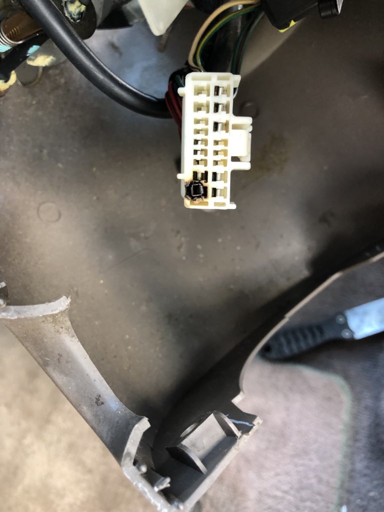

    Low beams don't work, high beams do

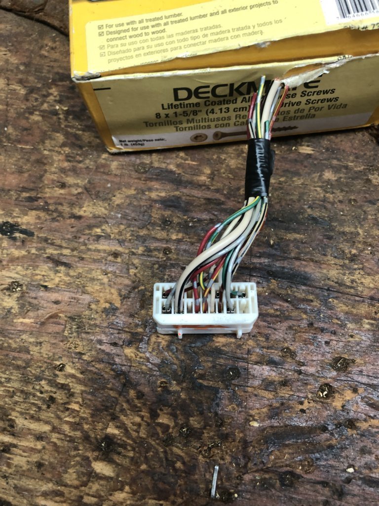

    I have the same problem . The switch is not damaged but the old connector is burnt at 17. See image provided. I found a connector with pigtail . Image provided.
    However, how do remove the pins from the new connector ? Is there a special tool needed? IMG_3165.jpg

    Around $26,000 worth of unleaded in the fuel tank.
    You can get a connector pin tool that has a bunch of different little keys on it, or you can try with a needle or paperclip.
