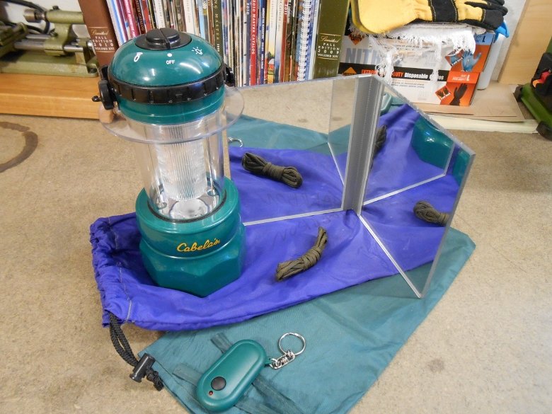

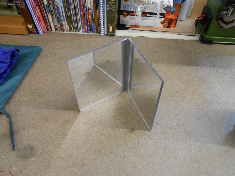

    Folding camp mirror and lantern reflector.
    Mirrored plexiglass with duct tape hinge.

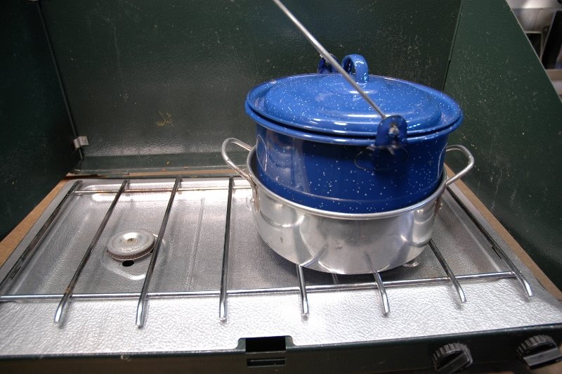

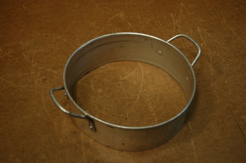

    Weekly submission.
    Cook stove "heat concentrator".
    This fellow directs heat around more surface area of cookware. It significantly decreases the time to boil and really helps in a breeze. Main cook pot sits inside, fry pan will sit on top and gets heated evenly.
    Made from an old pot.

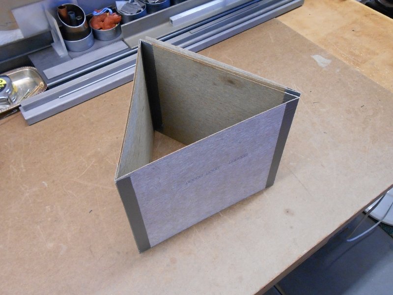

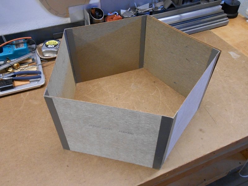

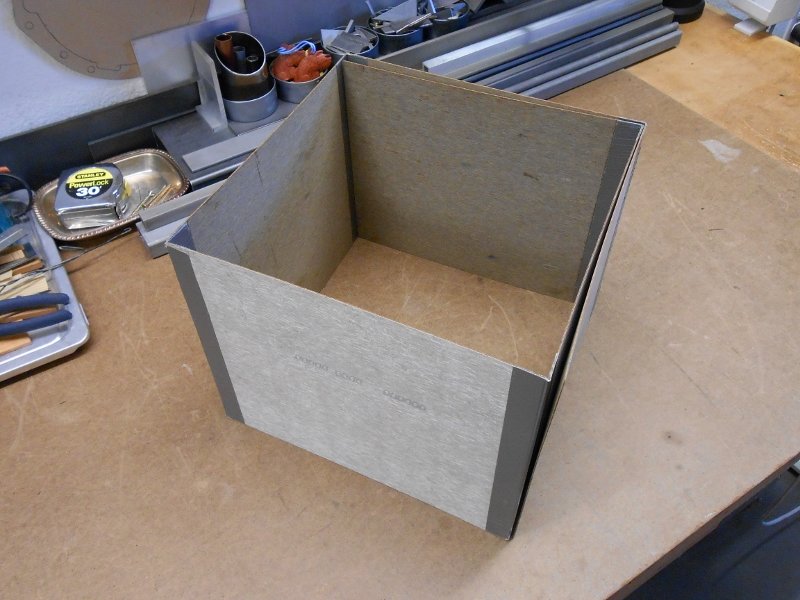

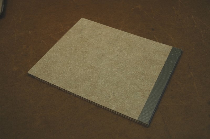

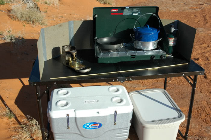

    My "overall" wind screen.
    The panels are scrap laminate (counter top stuff) with the ever popular duct tape hinges. Lightweight and mostly fire resistant. Also can be taped down in position, for the full gale.
    I would think the number, size and shape of the panels could be scaled down for the lightweights.
    Fully extended in a "U" configuration.
    Folded flat and other configurations.
