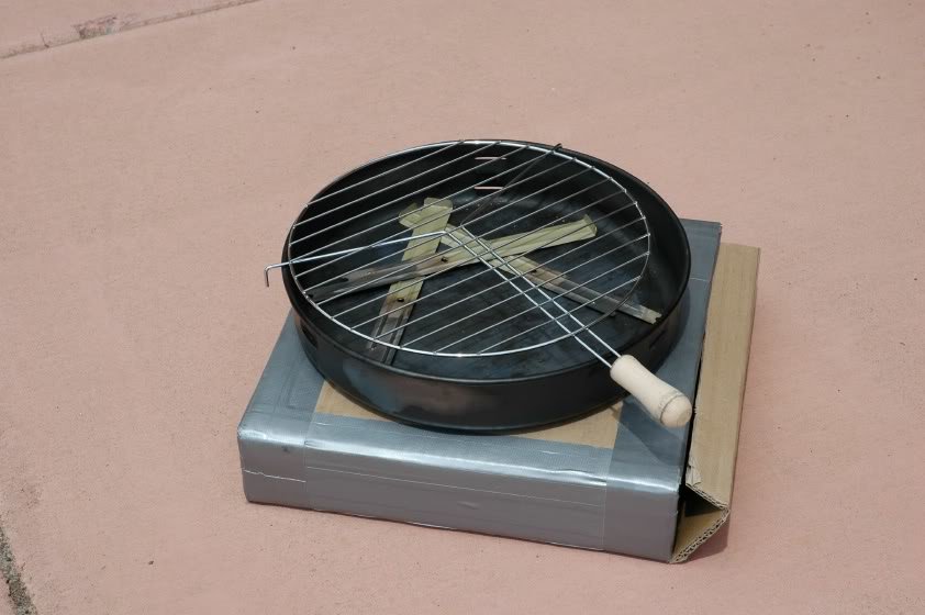

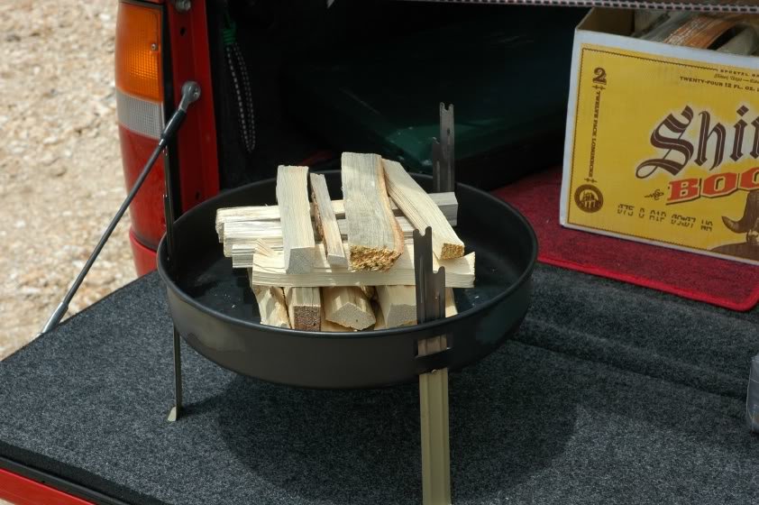

    The $7 fire pan.
    They come in round and square with a small bag of charcoal. The legs/grill supports are the perfect rest for the cooking stick.
    When the wind shifts just pick up the fire with two pliers and move it down wind. Of course it has a duct tape reinforced cardboard case (DTRC). This one came from Wally World.

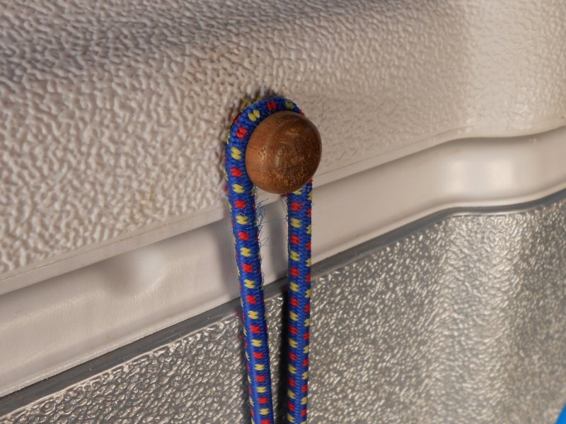

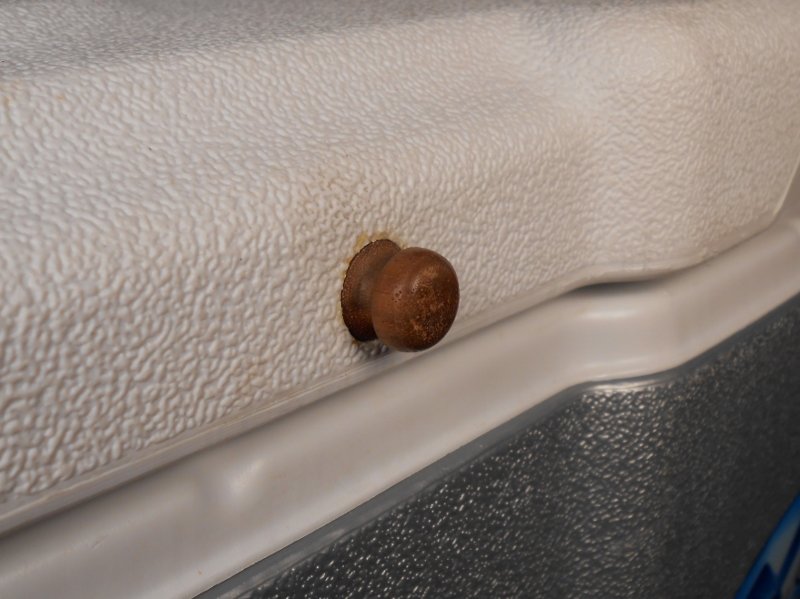

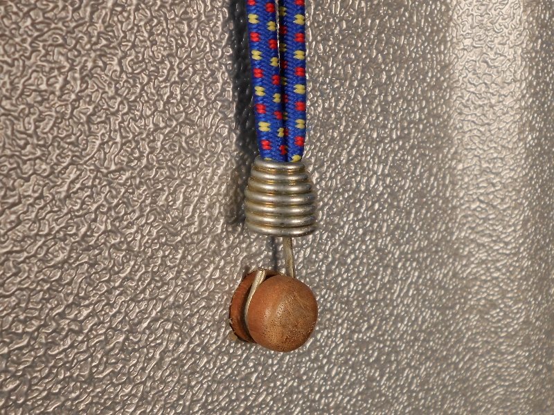

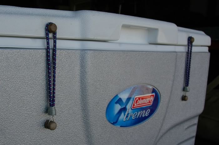

    Let the cooler heads prevail.
    Lid "hold downs". 1/2" dowel pieces glued in place with reconfigured mini bungees. Mahogany is not required.

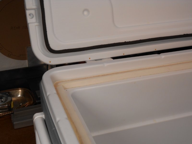

    Weather stripping.

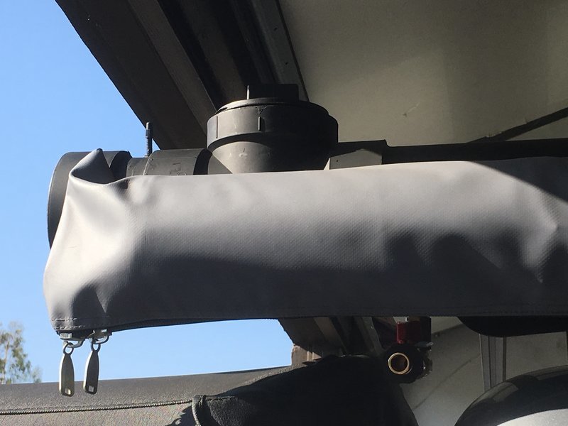

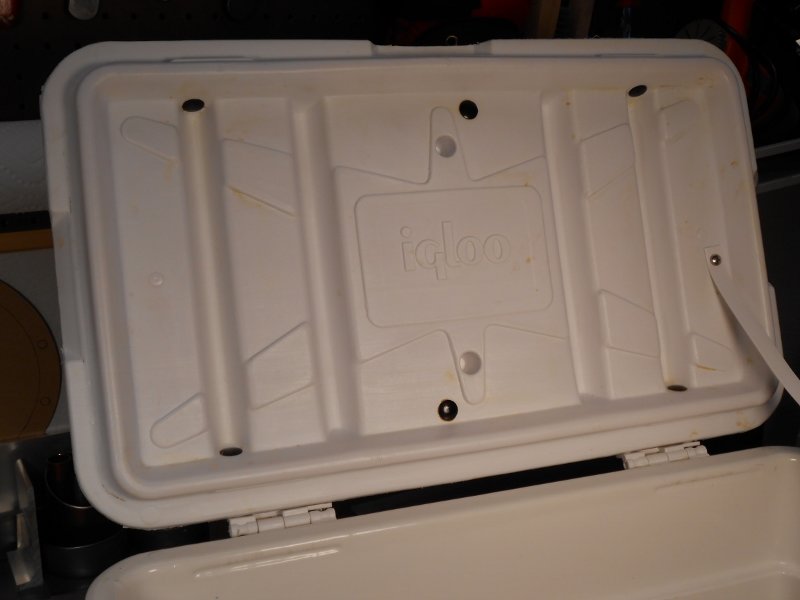

    One more cooler thing before next weeks contribution to the current "ABS accessories".
    The lid of my medium cooler was hollow, no foam fill. Kinda strange with a supposed (and priced) "marine grade" cooler. I drilled some holes and filled it with the "foam in a can" from a local home supply. I picked the version with the max expansion ratio. If one goes this route, fill from several points on one side and let the foam travel towards the open holes at the opposite side. Be ready to plug the "fill" holes and mask around ALL the holes, that stuff will stick fast to just about everything. Finish with hole plugs, hopefully in the same size as the holes you drilled;).
    This did make a noticeable difference in ice retention.
    Not much to see other than the layout of holes.

    How does this operate? Is it something like @puddle discussed above with the six inch ABS? Something else?
    Always interested in a road trip shower option.

    Yup pretty much! I'm using 4" ABS to cut down on height clearance. 4" was expensive enough, can't imagine 6" being very economical by way of DIY money savings.

    Yes! I've been thinking about doing this exact same thing with mine. I have a Coleman Marine and the lid is hollow also which has been bugging me.

    I forgot to mention, most of these foams are "moisture cured". I sprayed a few pumps of water mist into the lid. This helps to ensure all the foam fully cures and faster as well.
    We have next to zero humidity here, Portland might be a different story.

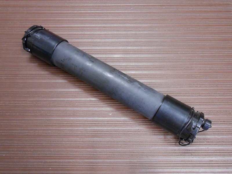

    Abstract ABS
    I made this fellow up years ago. It's a human waste containment system known to the river running crowd as a "torpedo" (it likely predates WAGs). Some wilderness and similar protected areas that allow vehicular access require some type of "system". I have never used this but did have to show it to pick up a back country permit. These days we just pack the folding "Cleopatra's Throne" (with padded seat).
    Anyhow
    Thanks to Mr @puddle and @imtaconico, I'm thinking of adding a schrader valve for regulated air pressure and a hose/sprayer. As it sits, it's on the small side but the end caps are cam lock affairs with o-rings (RV stuff) so a refill would take seconds. One end already has a standard garden hose thread connection for the shower hose.

    You are supposed to shit it that? Do you stick it in your ass?
