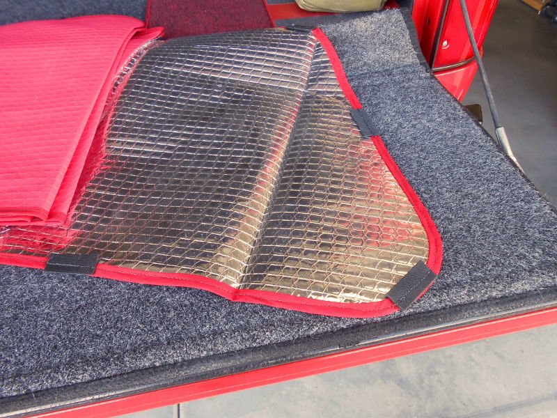

    Truck cap side window thermal/black out curtains.
    Made from rip stop "Space Blanket" (brand). The cap has a carpet like headliner so little tabs of Velcro (hook side) sewn around the edges hold things in place. My seamstress/navigator also did the edge treatment.

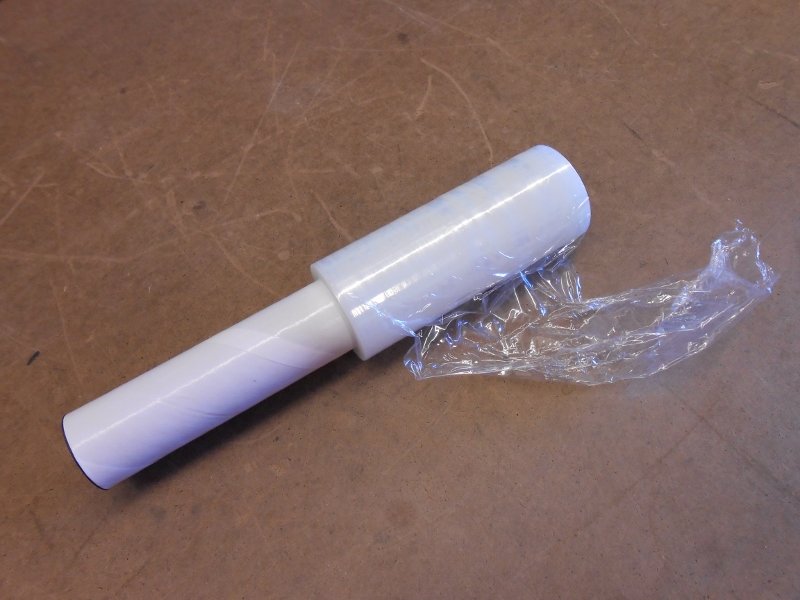

    Along with "spit, gum and bailing wire" a roll of stretch wrap is very handy.
    From wrapping a torn CV boot or as a "compression binding" to keep compacted trash compacted, I find new uses all the time.
    When the household roll gets down to the last 1/3-1/4 it goes into the camp stuff closet.

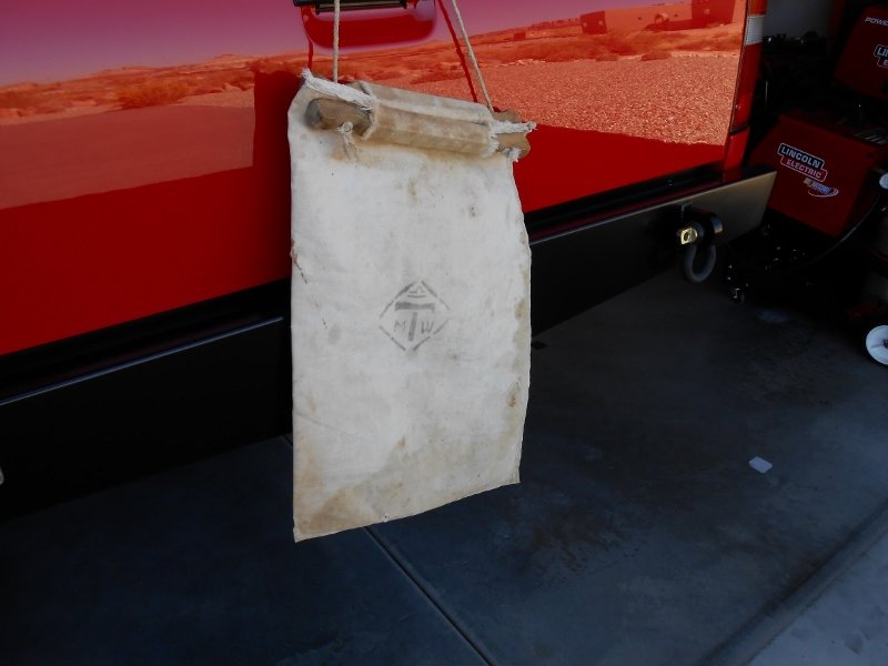

    Speaking of trash, here is the original Trasharoo.
    Not really, it's a "high grade ore bag" for culling the really good stuff from the pile.

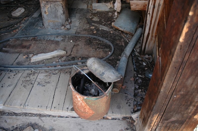

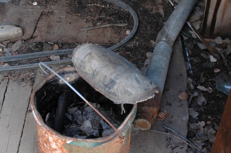

    Getting near the bottom of the bag with this stuff so this one is more of a history thing.
    Sitting on the bucket in this old mine camp is a tire repair boot. Essentially an extra giant inside tire patch made from a piece of an old tire, buffed and shaped as needed. Steinbeck mentions a similar deal in Grapes of Wrath. Dick Cepek once sold a giant inside patch (about 6"x6"), billed as the "Baja Boot". The pitch went "This and a tube will get a cut tire back from Baja".

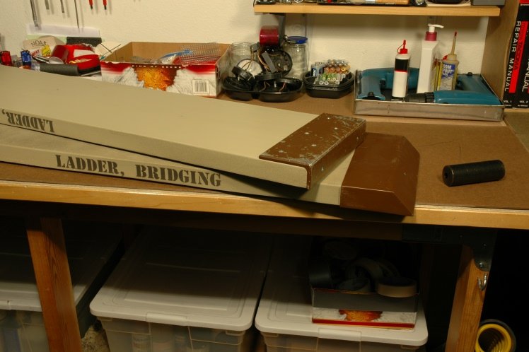

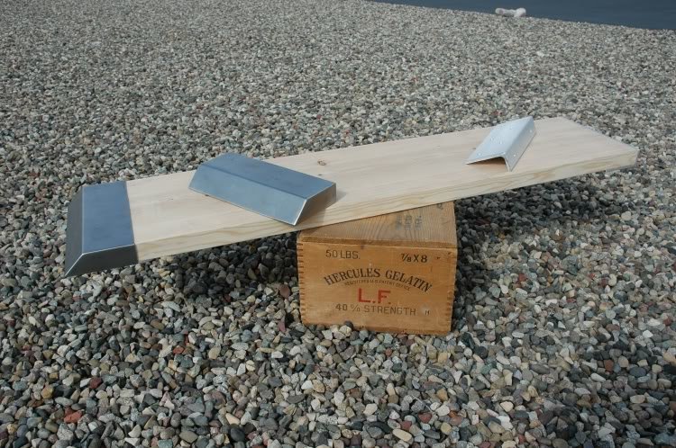

    The old standby traction aid/bridging ladder, is a plank.

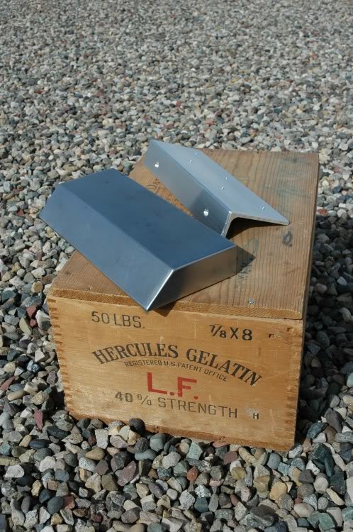

    The initial thought was to experiment with two end treatments for different scenarios, till I got carried away a bit. Also didn't have enough material for 4 of the same ends.
    The square end would somewhat resist penetrating soft stuff with thrust from the tire and a pointed end for wedging into a crack with both distributing loads across the whole width.
    Fully welded 14g "cap" and 1/4" aluminum angle.
    Carefully selected Doug Fir 2x12, straight grain and minimal small knots. Ends bedded in polyurethane adhesive. A single 4' section will carry the entire weight of the 1st gen front on 1 tire with about 1" bow.
    Finished product with whimsical Mill Spec theme and sand infused finish. I plan to weld individual chain links on the sides of the steel caps to allow them to be bolted together.
    Funny thing is these guys mostly get used as camp shelves, walkways, tables, benches and wind breaks all the time.

    wood is tough to beat for strength to weight.
