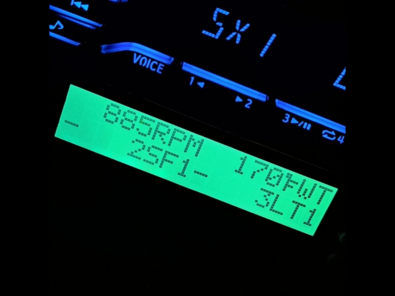

    I’ve noticed my fuel trims being a little off. At idle it’s usually -1.6% but at highway speeds it at +7%. This may seem minor to some people but I’m SUPER particular. If I am worrying about something I shouldn’t please say so. What would cause it to change from correct at idle to being off while driving?
    I’ve looks for any causes of this but came up empty handed. I saw several people say that the 2.4 & 2.7 liter engines were known for head damage farther in life but I’ve only got 133,000, not much for a Tacoma I’ve been told. I just did a compression test and found all cylinders to be right on 149-150psi. I thought it was strange for them to be so perfect. I saw it was supposed to be 175psi. So this seems a little low. I added a little amount of oil to one of the cylinders and it jumped to 165, a 10% increase. Is that a lot?. when I pulled the plugs to insert the tester the plugs looked pristine, no signs of oil burning. I looked into the cylinders and still could see some silver on the tops of the pistons, not carboned over like an oil burner would be.
    From my research, I found that if all cylinders are low and wet compression didn't rise significantly it could be a timing issue. To my knowledge, the valve shims have never been adjusted. So could valves be out of spec causing this? It would seem that most commonly the valve lash decreases over time so if the intake valve did not close soon enough compression would be low. When should the valves be adjusted?
    I don't think the piston rings are bad because of how little oil it burns. In a year and three month period, I only drove one thousand miles, but since it had been a year I changed the oil and emptied the previously installed catch can. The catch can only had a tablespoon of oil in it. I had taken a picture of the dipstick the last time I changed the oil so I could compare it and there was not a visible drop in oil level, it was right on the full line where I was over a year and one thousand miles ago.

    My MAF was cleaned not long ago and I replaced a faulty a/f sensor. I realize +7% isn’t horrible but increasing with rpm is consistent with a post I read about a 2.4l that was low on compression. It was perfect at idle but +10% at highway speeds and had 130psi. you guys didn’t address the low compression at 150psi when it supposed to be at 175 and when is it typical for the valve to need adjusting?

    I did a leak-down test just for fun because I bought one previously to diagnose an old minivan. I didn't expect to find anything; I just like messing with stuff. I had extremely little leak down.

    My 3.4 numbers are
    My fuel trims at idle are “0”
    When full throttle maybe “5” max
    When at highway speed “0+1”

    My long term fuel trims are + or - 3
