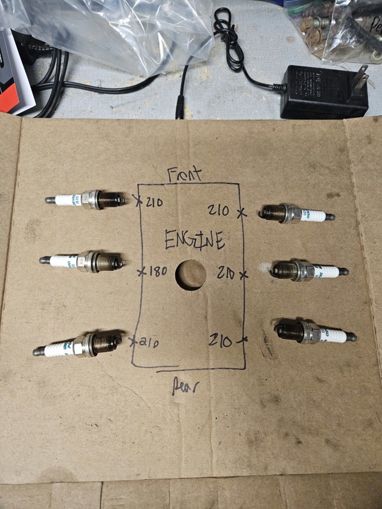

    look at that sparkplug electrode, back side, side, for ANY faint traces of color, whatever color your coolant is....
    will be hard to see, not obvious, very subtle....
    another indicator that she's dead Jim...
    also see how the SP threads are gummy & dark on #3 vs shiny on majority of the other spark plugs????
    thats another indicator of cracked head or early signs of coolant intrusion on that cylinder...

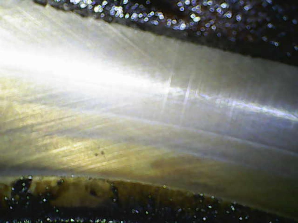

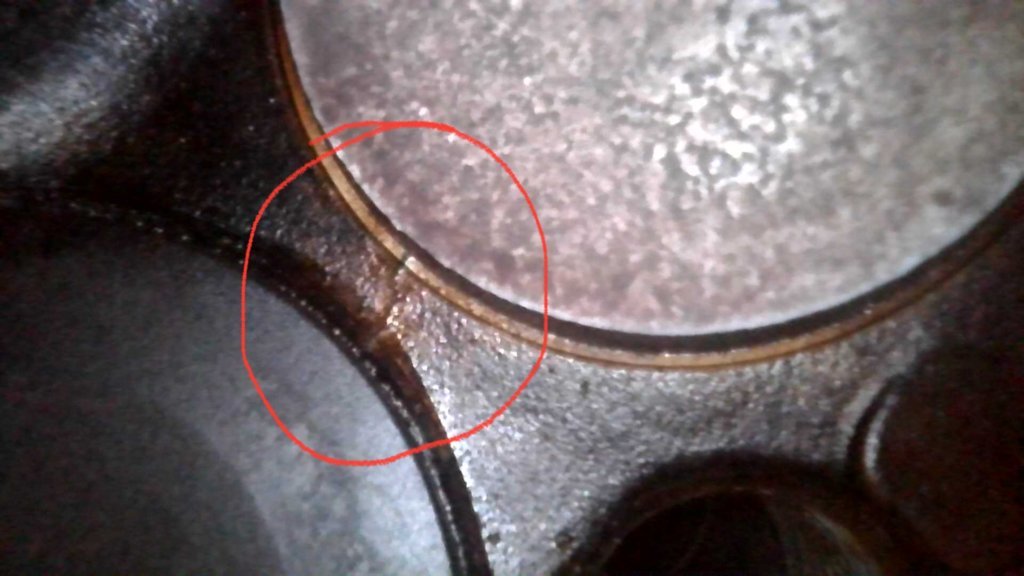

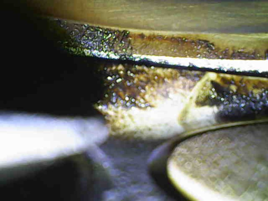

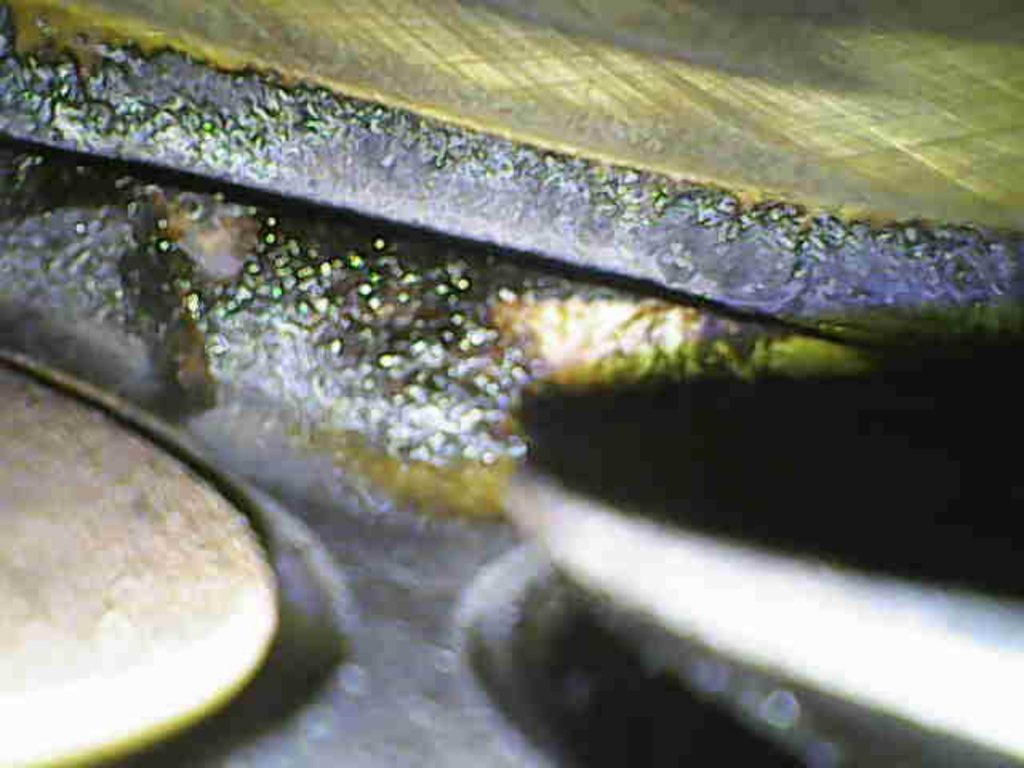

    Appreciate all of the good info here. Picked up a cheap scope online and snapped some pictures. @slater you are correct, hard to see anything in there. Checked as best I could between valves and couldn't see anything noticeable. Probably hidden by the carbon. Wall scoring looks good, think it may be worth saving if the head is slightly cracked. Going to pull them this weekend before work trip and try to get them into the machine shop.
    Here's pics I could get for anyone interested:
    Photo_2025-01-29 17_57_30_918.jpg Photo_2025-01-29 17_57_17_701.jpg Photo_2025-01-29 17_54_50_795.jpg

    I’m looking on my cell phone, I think I see green at the head gasket, is it green coolant?
    I see green tint at the head gasket area where the carbon line is, on the head & cylinder wall, like coolant seepage...
    & obviously if you have green coolant....
    not toyota red...
    unless its just a strange hue from the lighting...
    First picture
    and I’d say I’m wrong from the looks of your pictures…:D
    meaning for not having side or upper view, you managed to turn the scope to get a good shot of the valve area, little blurry in the area we needed to inspect though, the crack zone...
    almost looks like theres a diagnol shadow at the crack zone, ide say that pic is inconclusive, you will find out soon enough if your pulling both heads...
    you want to look at the cylinder wall on the inside edge of the block, with piston all the way down, vertical scoring lines.....
    I see some but no idea if thats the inside end, but thats up high & minimal...

    Could be wrong but it seems like your piston is in the way of getting a better angle on the head. Might help to spin the engine a bit so the piston is down to give you more space if that is the problem. When I did it I had to bend the borescope into a U before sticking it down the spark plug hole
    I also used a cheap like $40 Amazon borescope, so I think you can get yours to point up too
    That picture of the crack I posted was taken this way, that wasn’t taken after disassembly
    Took quite a bit of finagling about to get an angle on it

    Thats a giant crack,
    ones ive seen on fords which have a thin bridge between the valves, are hard to see with the heads off let alone using a borescope heads on...
    You actually sometimes have to remove buildup with wire brush to see Them...
    The 4.0 ohv, ranger & explorer were notorious for cracked heads, cyl #3 & 4, same spot as your image...
    Some borescopes to magnify things sometimes making things look larger than they actually are, makes finding flaws easier...

    Thought the green color was odd. Running toyota red coolant so not sure where the green is coming from. Most likely oil with light shining on it just right is my guess

    Got it, false alarm on the I see coolant!!! :D
    Ide lower the piston & get a good look at the cylinder wall on the inside inner wall of the block, just to be certain its not chewed-up...
    would suck to do all the work ripping the heads off, to see it, "bad" after the fact...
